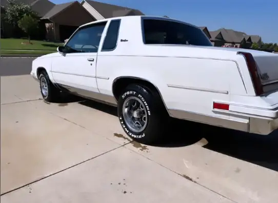

yo whats good, im new to the forum check out my all original 1986 cutlass supreme im thinking about upgrading my suspension my IG @trapboss.gbody
