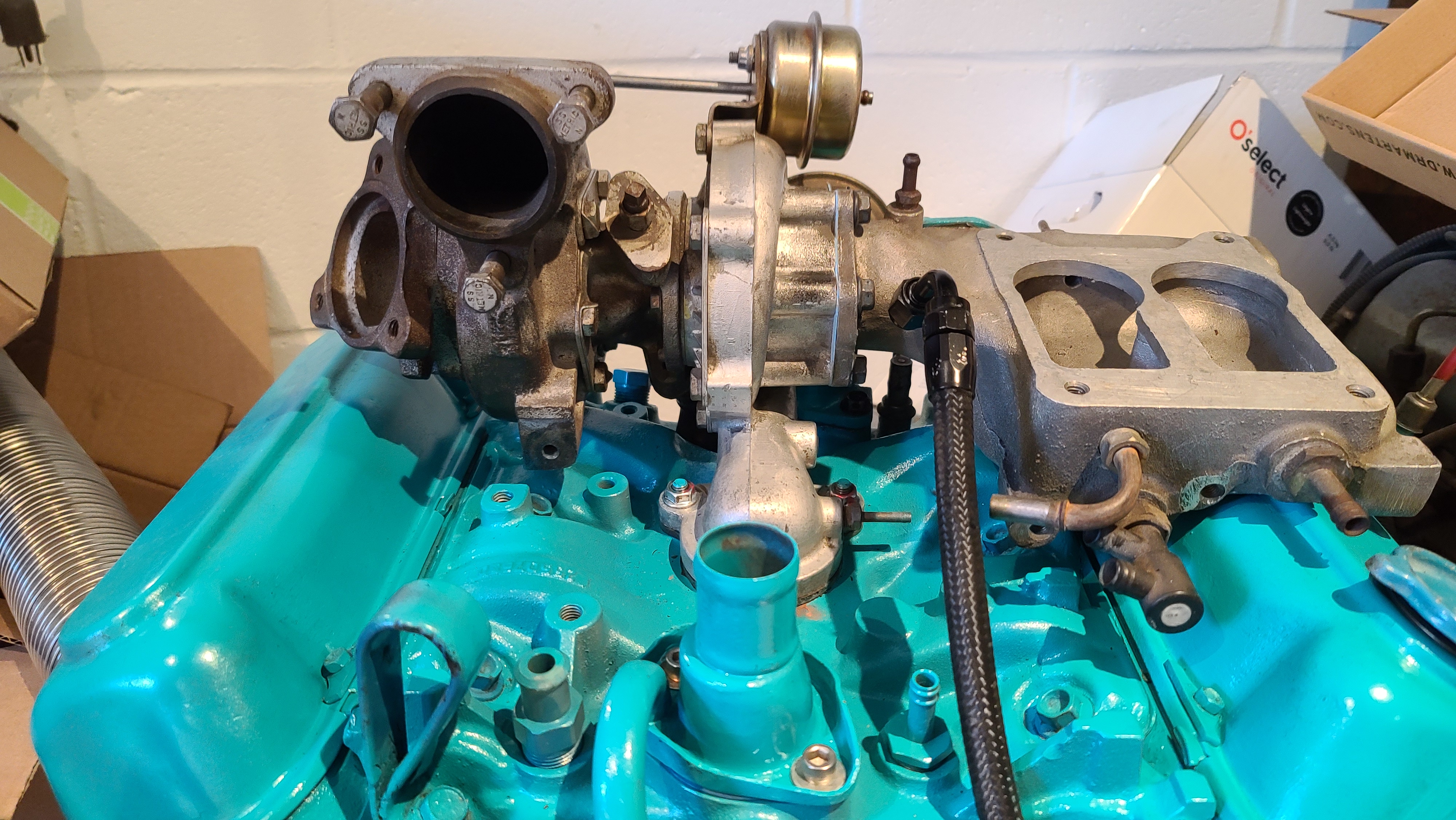

Turbo cleaned and installed. Will have to think about what to do with the header-to-turbo pipe. Fabrication required.

Show a close up of the header and pipe. I imagine you want as little restriction as possible but I am no blow through turbo expert. Crazy how small the intake flange is.
Indeed, that's very small intake flange!
The header output is 2.25" OD, so I might as well getting 2.25" ID pipe and work from there. The header was "butchered" for a previous project, so I'll have to work with it in that state. The OEM turbo intake pipe is a mere 2" OD.
Crazy how close the carb/intake plenum is close to the left valve cover...!
