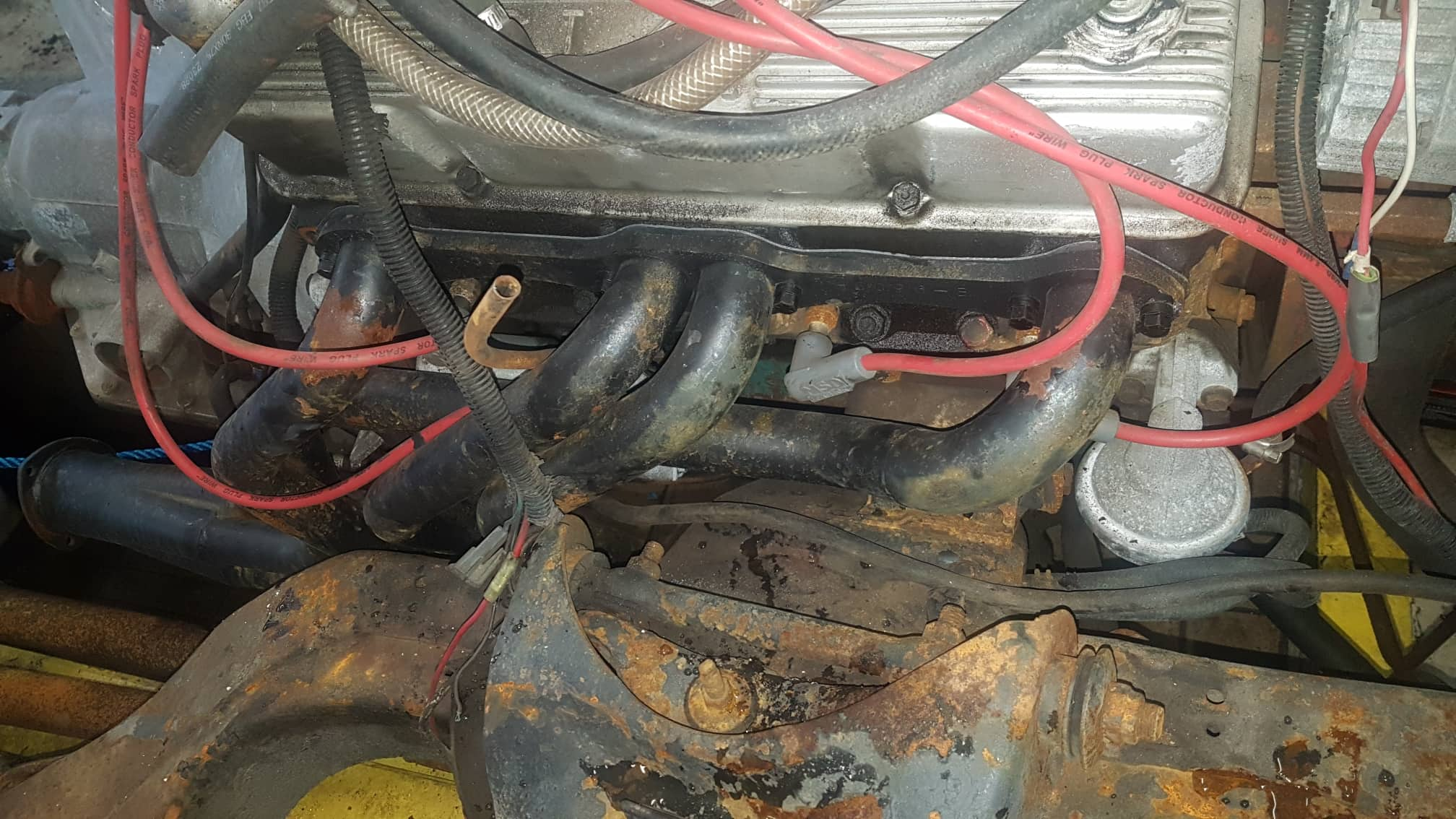

Thanks so much for your help, the parts arrived yesterday and I tried fitting the headers with the low profile bolts, everything works fine, but not a millimeter to spare ! hehe

Another small issue, the crows in the neighborhood must've stolen my oil dipstick! So where would I go about finding a correct length dipstick for my engine? It is a 350 after all but I imagine I must get the correct dipstick for the oil pan which this engine has in it, which must be a G body oil pan? I don't know...! please help 🙂

I'm not crazy about the rust on the handle but it looks like it will clean up to me. Stay away from after-market replacement dip sticks. Usually the quality is poor. The seller above doesn't list Iceland but is shipping to a lot of places internationally so I think he will ship to you. Otherwise, I would put a listing for it in the wanted section on here or cantact Mike at Mike's Montes. He does sell used parts.
Shouldn't worry too mush for finding another dipstick. If you need a tube & stick you can go with a B body one. Years back the tube on the old 305 broke & was only able to get a B body. Cleared the headers alittle better & seemed longer in lenth on the handle send but still read the same.
