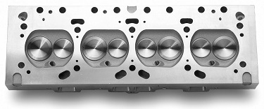

What series Edelbrock heads are those, the early combustion chamber or the revised version?
Thanks!! First Gen 6051 "C" casting style combustion chambers 060519_v3_20091012.jpg
Hutch
Thanks!! First Gen 6051 "C" casting style combustion chambers View attachment 209786
Hutch
I've been trying to find someone who has a set of the new chamber heads that reportedly came out last year but to no avail.
