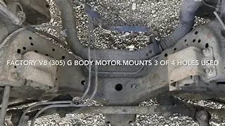

I'm afraid to make people mad, but there doesn't seem to be a way to "bolt a 350 sbc" right in without moving the motor mounts and changing over almost everything under the hood. My biggest problem is moving the motor mounts; having someone come out why I try to make sure that the engine is level (while attached to the bellhousing/transmission) and mark the spots and then weld in new mounts for me is something I'm not sure I can get right.
I have never swapped the chevy V6 only the Buick V6 for a SBC which requires different mounts and different locations if your V6 mounts are as pictured being mounted forward on the frame and only using only 3 bolts then a SBC will bolt right in.

Another 4.3 dropping in is the easiest part & the exhaust can stay since the '78 up Chevy V6 use the same bolt/port pattern. As for the mounts, three bolts each side on the frame, no welding needed. Keep in mind there is still more aftermarket support for a SBC than the Chevy V6. Best advice I'll give is to take a step back, check into what there is to turbo a 350/5.7 with the cost. Then do the same with a 4.3 to include swapping a Typhoon/Syclone set up.

The 4.3 uses different frame mounts mounted further back but the holes are in the cross member to put the V8 clamshell bases in no welding required. Then you need the upper engine bracket which has to come out of a car about 1974 and up the truck brackets are taller. The clam shell bases are generic parts house available. If you can't find the engine brackets UMI makes a nice set that are reasonably priced.
I'll have to look, but at least I know what to look for. I also just learned I don't have to weld anything...

I have look at the 5.7 TBI engine though as that is the most recommended swap for this exact situation. That's going to take moving the motor mounts though. At this point, and based on what you just said, I need to revisit exactly what that means; apparently it may not mean welding.
