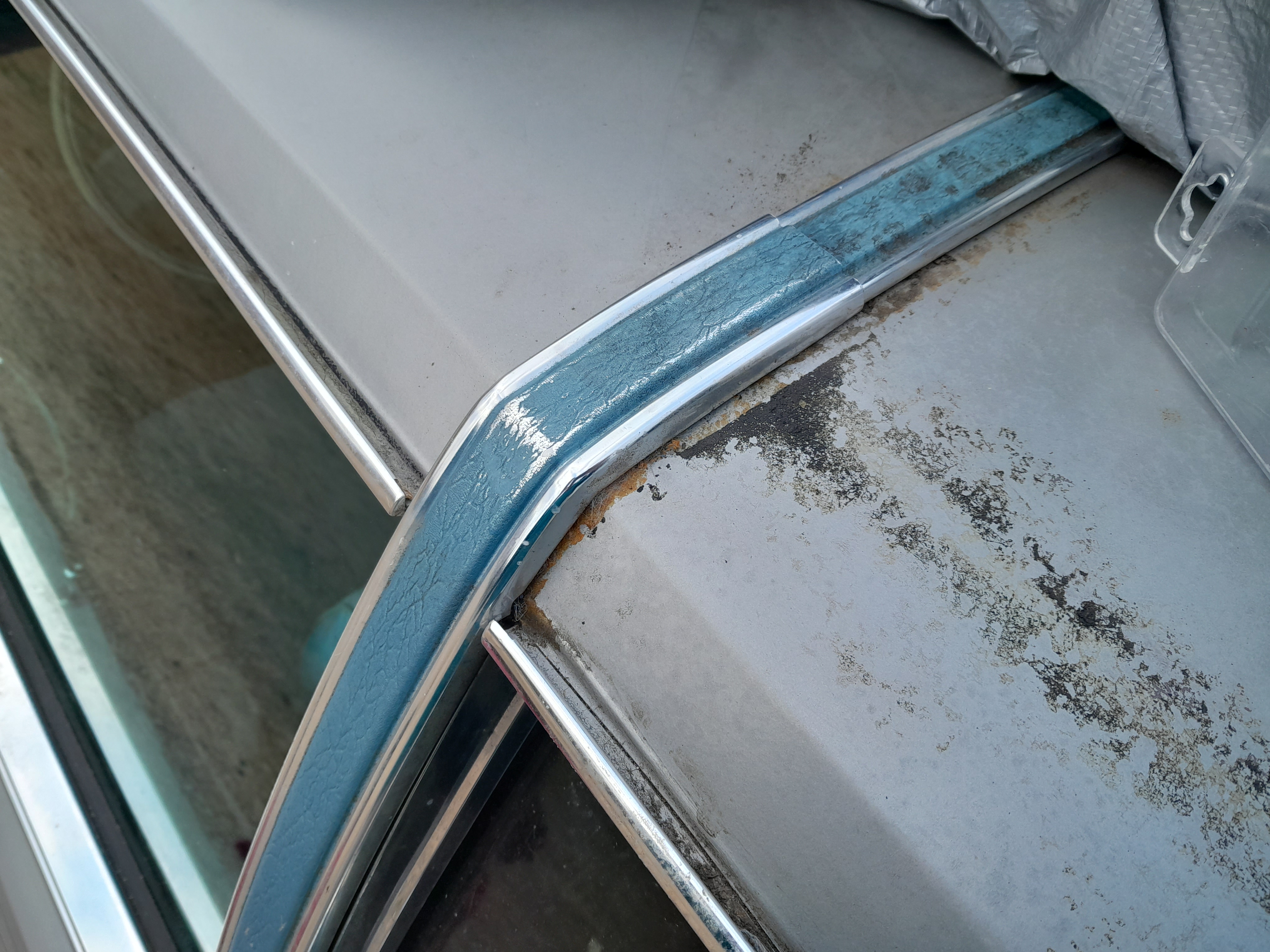

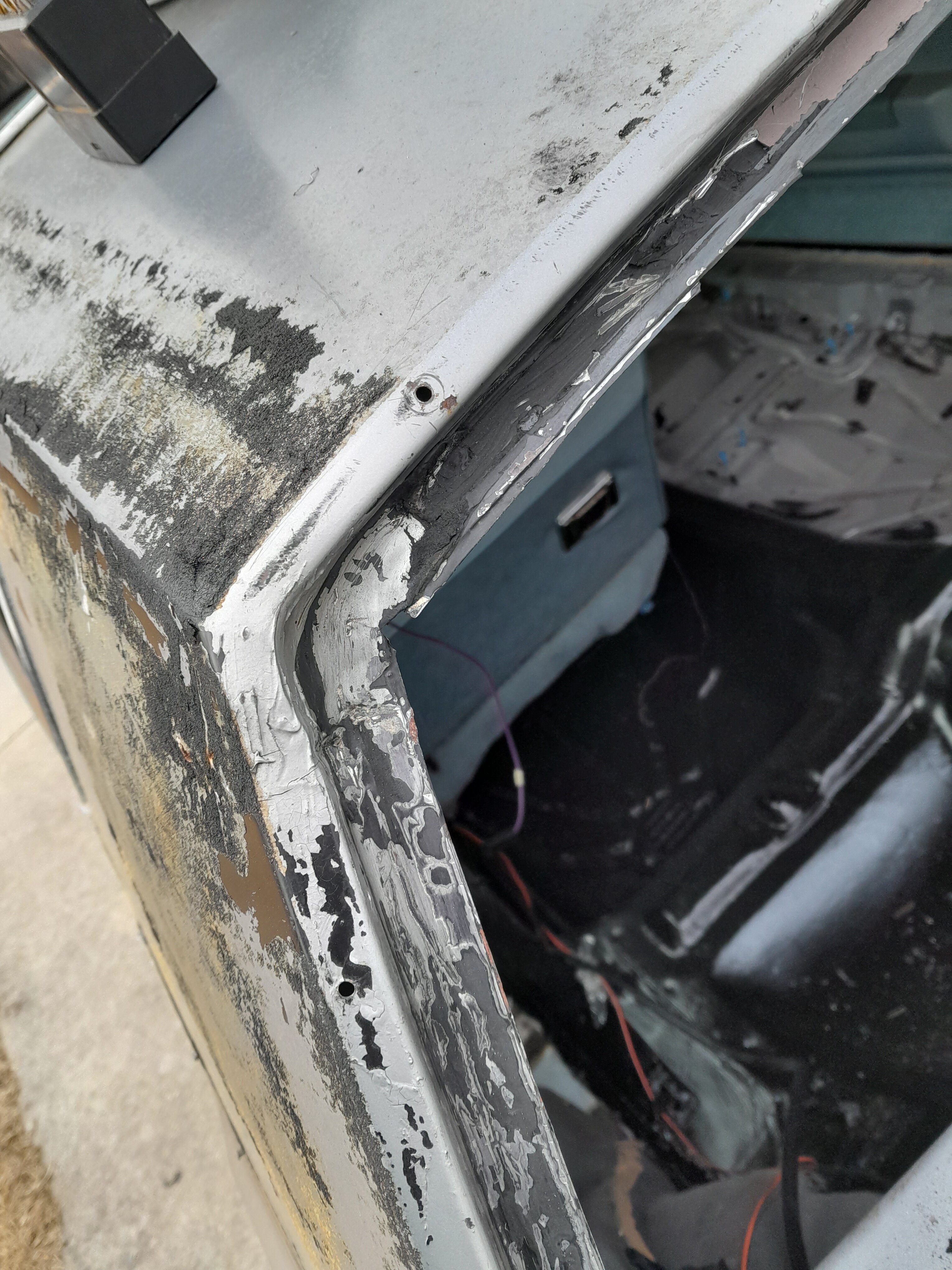

I can't figure how to release this landau trim piece. Having success deleting rivets and old polyurethane glue on rear windshield. Please help me figure out how to remove the trim piece my darling is pointing to.
Edit Feb 01; popped trim off clips with upholstery pry bar. Something something breaking eggs and omelettes. Trim in good shape; I'll probably sell it off sooner or later.
Guess I have to make or look for a used cover-plate for the plastic piece on the 'B' pillar. I assume thereis a coverplate on cutlass without vinyl top.
I don't know the answer to your question but I have a question for you: Are you going back to vinyl after repairs or deleting altogether?
I ask because I've read that the rear 1/4 windows are slightly different, the seals actually. Apparently they're a bit thicker to hide a gap that would be there without the vinyl top. Without replacing the windows you can just use butyl tape, or "dum dum".
The back window trim is also reported to be different. I guess the normal glass uses clips on studs that we don't have, so you'll have to add studs/ screws to attach the trim or just glue it on. I have no idea how the previous owners did the vinyl top removal on mine aside from "incorrectly".
Reactions: SoFloG and Rktpwrd
Not sure about the 1/4 windows - I'm confident I'll make it work - cross that bridge later. I bought the rear window trim from gbody member O. D. Showtime out in Saskatchewan. I got windshield trim clips, umbrella clips. I need a good barrel sanding tool. I got bondo. I need a friend to weld up the rivet holes. To be honest, I may have the body shop put the rear windshield in for me.
I'm 46. Since I was a kid, I NEVER understood the landau top concept. I'VE ALWAYS HATED IT. I wondered as a kid, were they trying to make a buick look like a ragtop convertible with the full landau top? WTF is the look here? I hate vinyl tops. HATE THEM!!! I'll live with some imperfections so long as that pleather is off my car.
