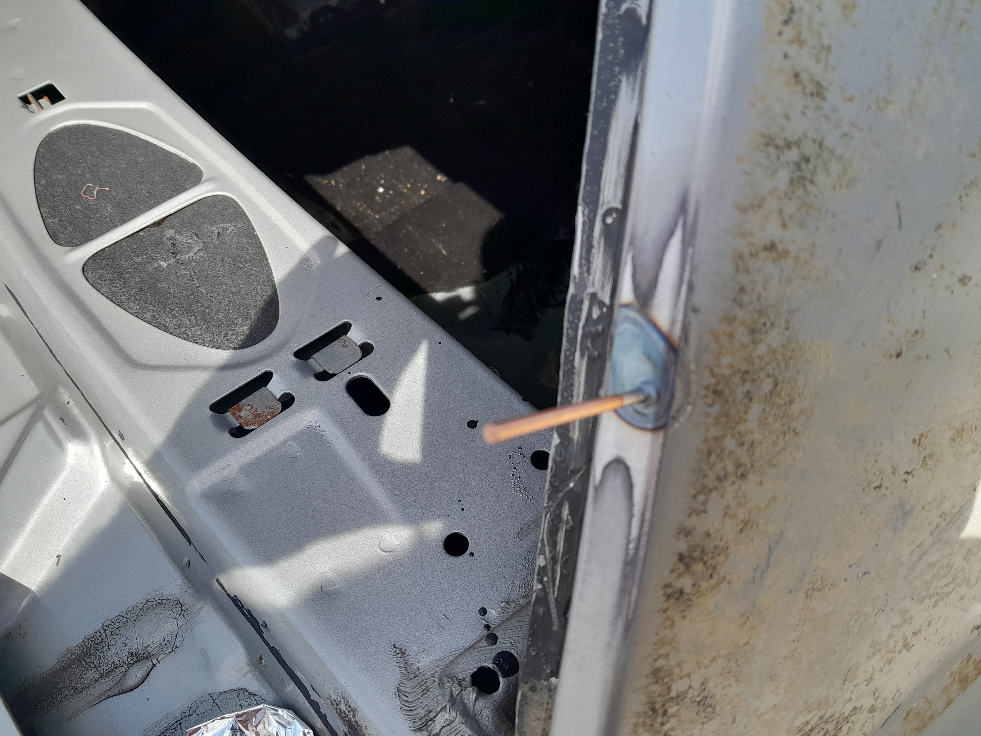

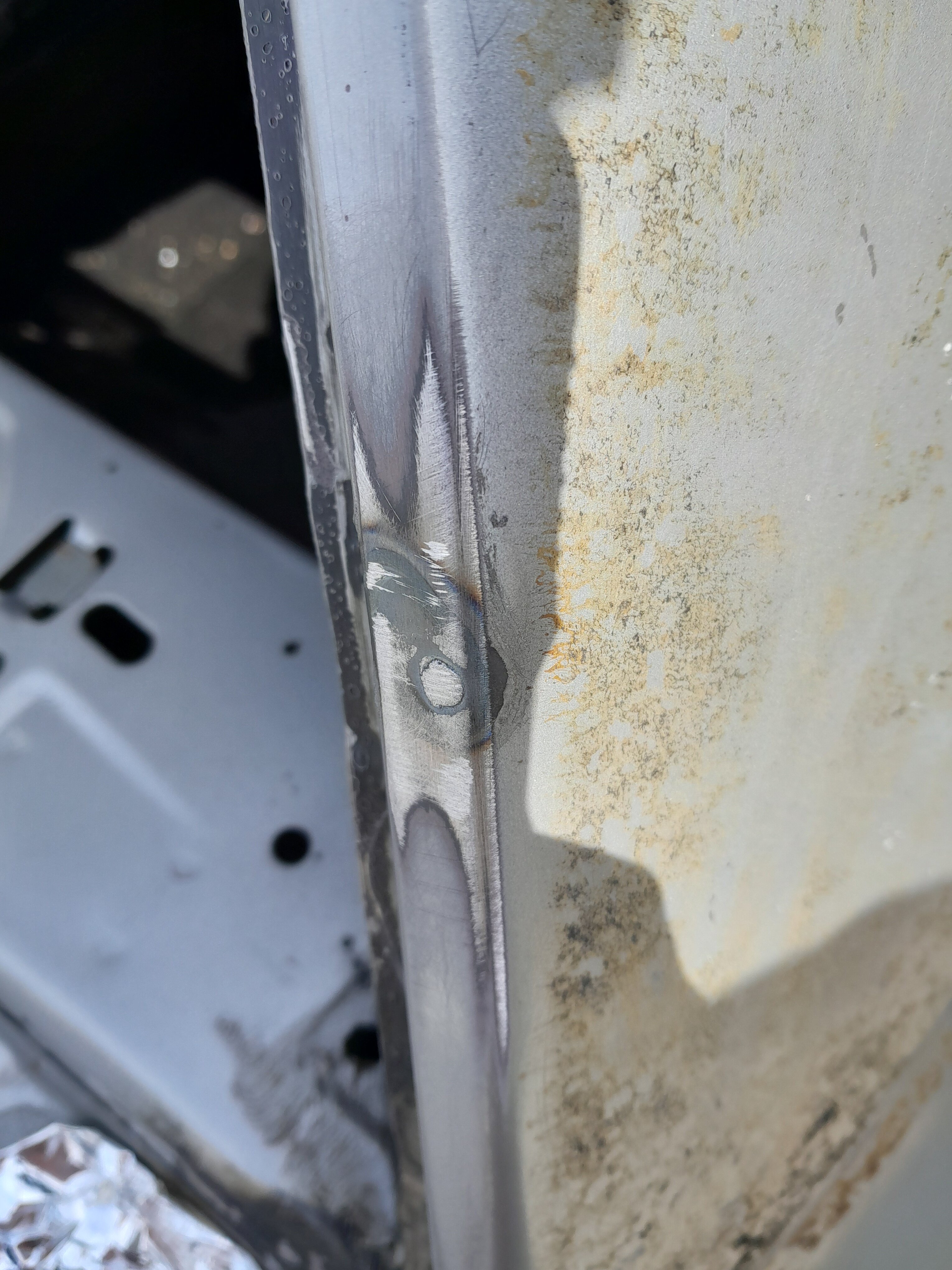

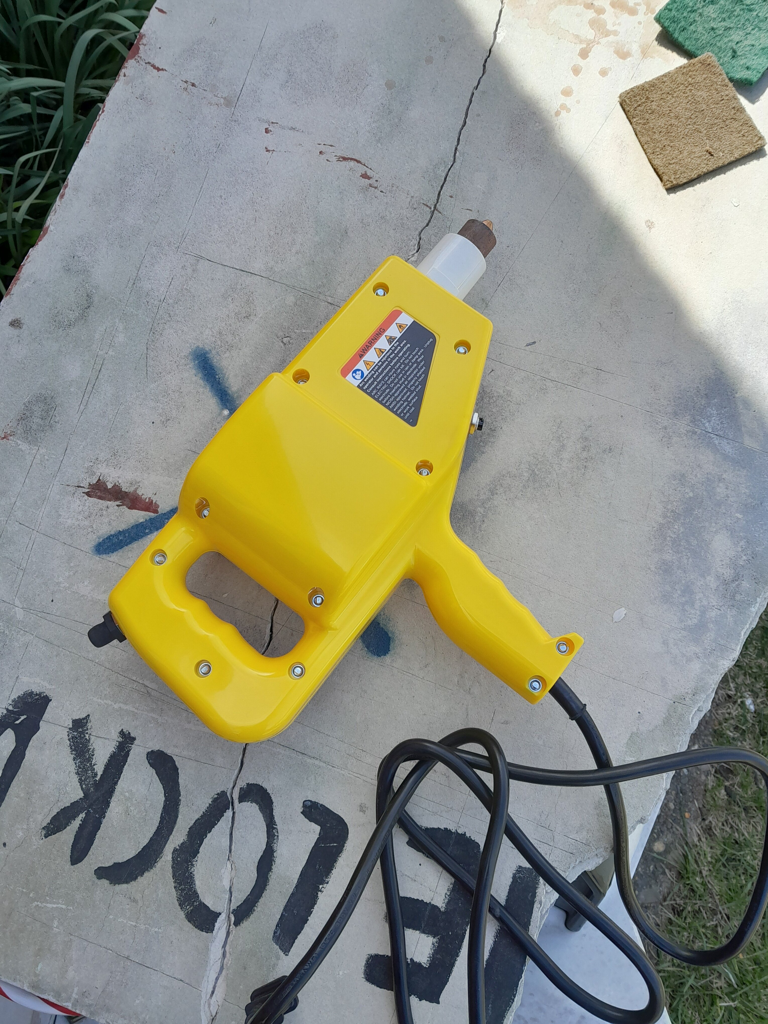

So, current plan is off-label use of a Harbor Freight $99 stud gun to fill the rivet holes with 2mm studs, which I will grind flush.Body solder and plumbing solder are the same thing just a different percentage of lead and tin.*
