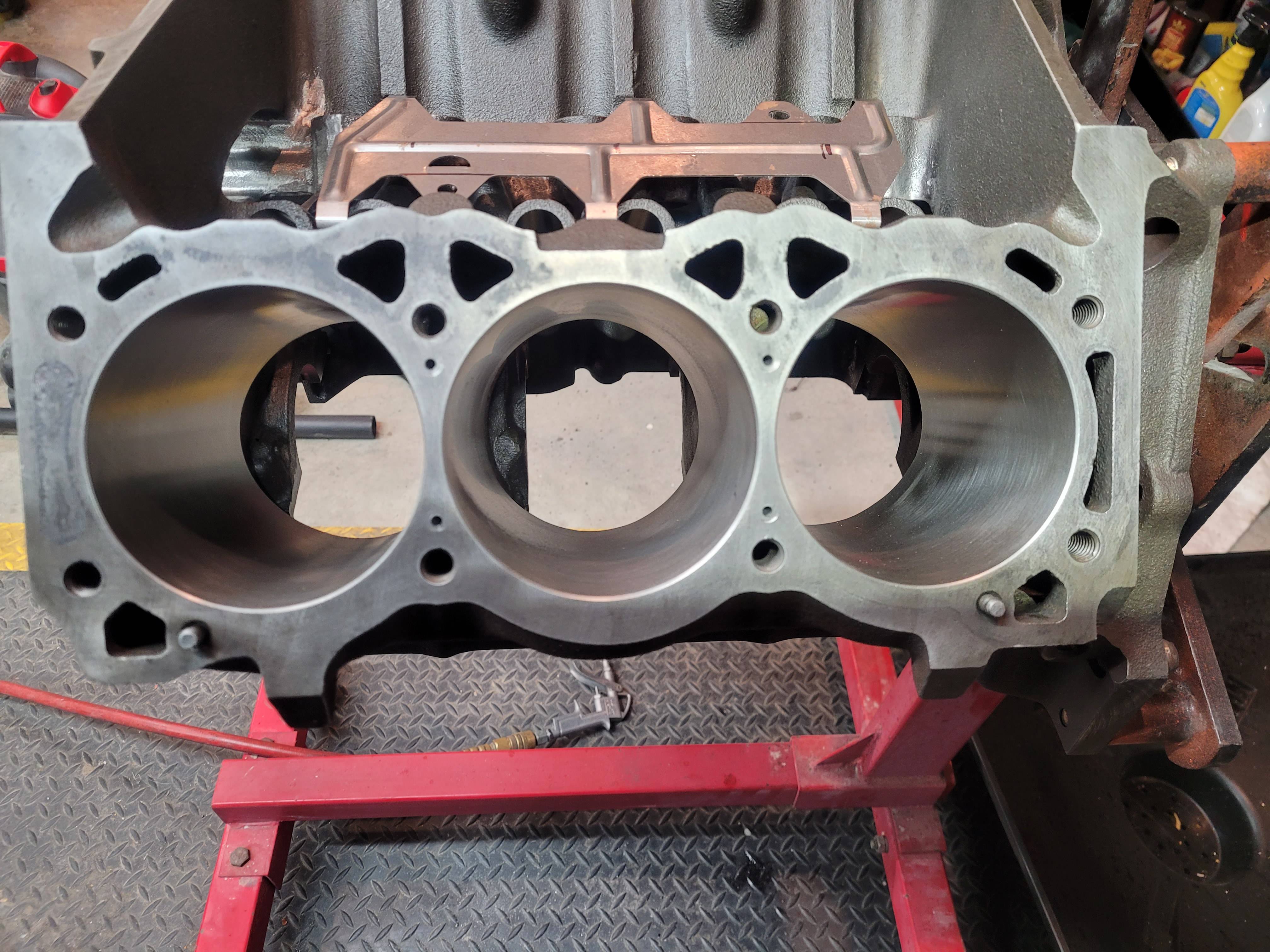

Another small update.

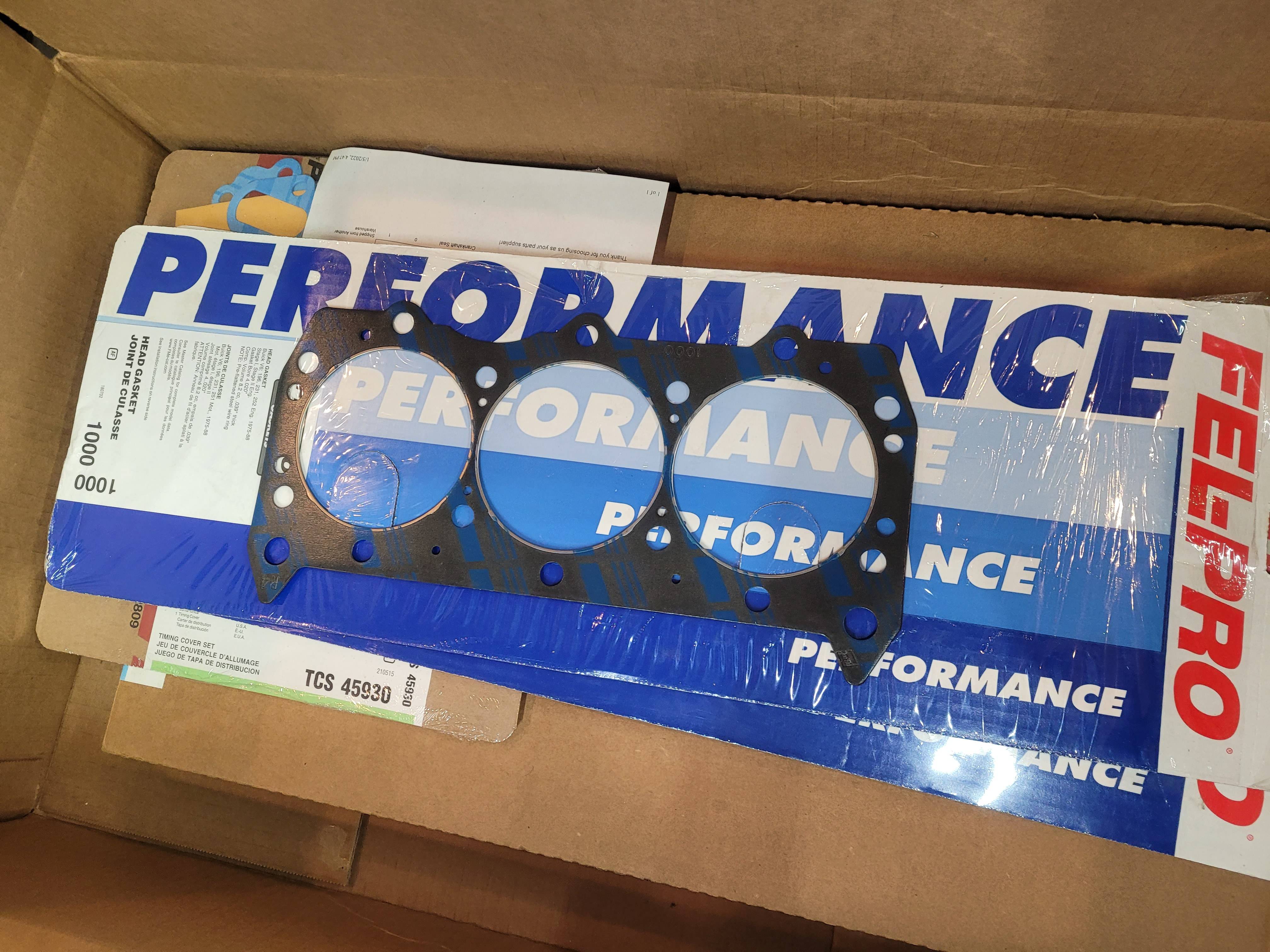

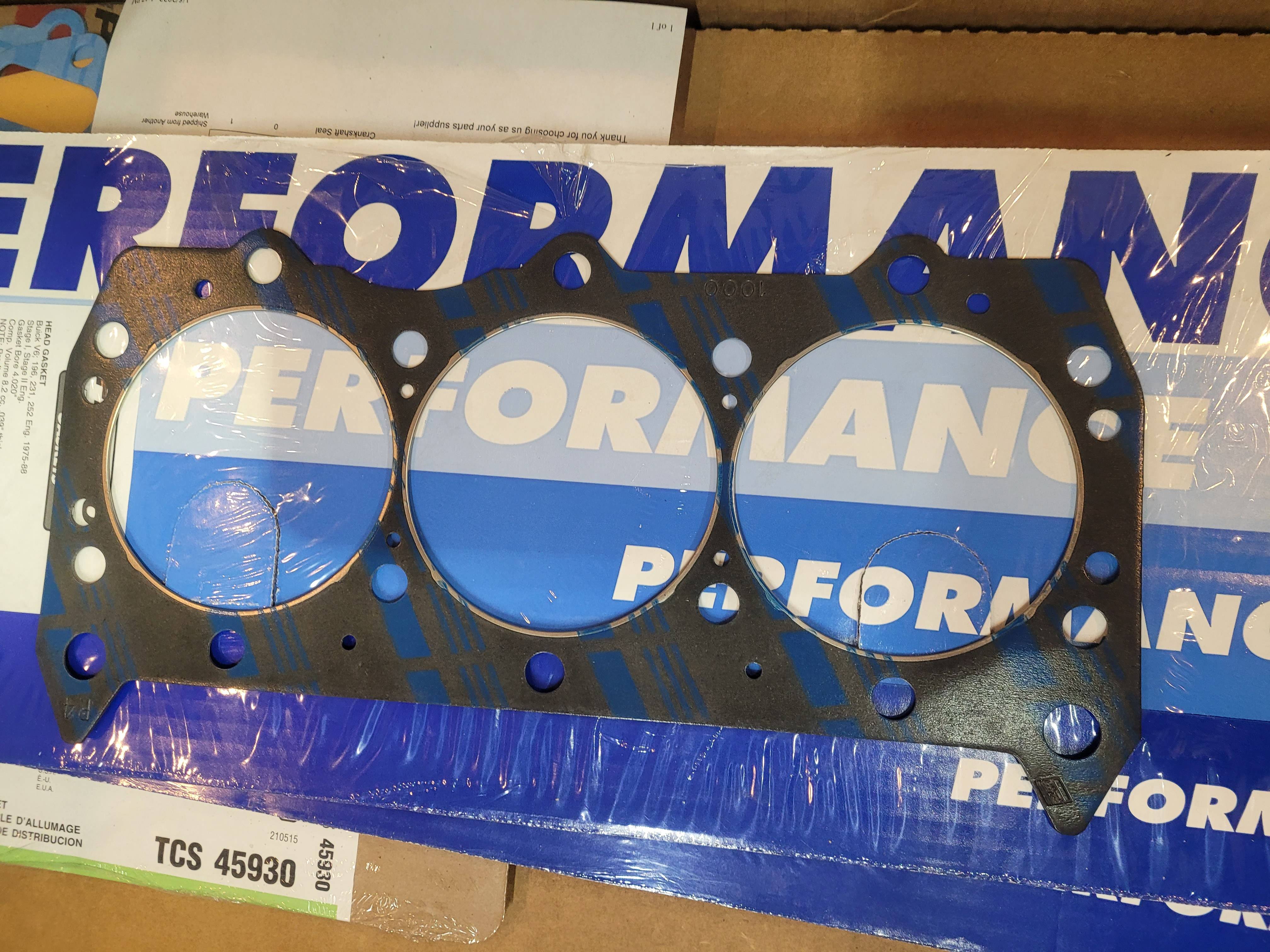

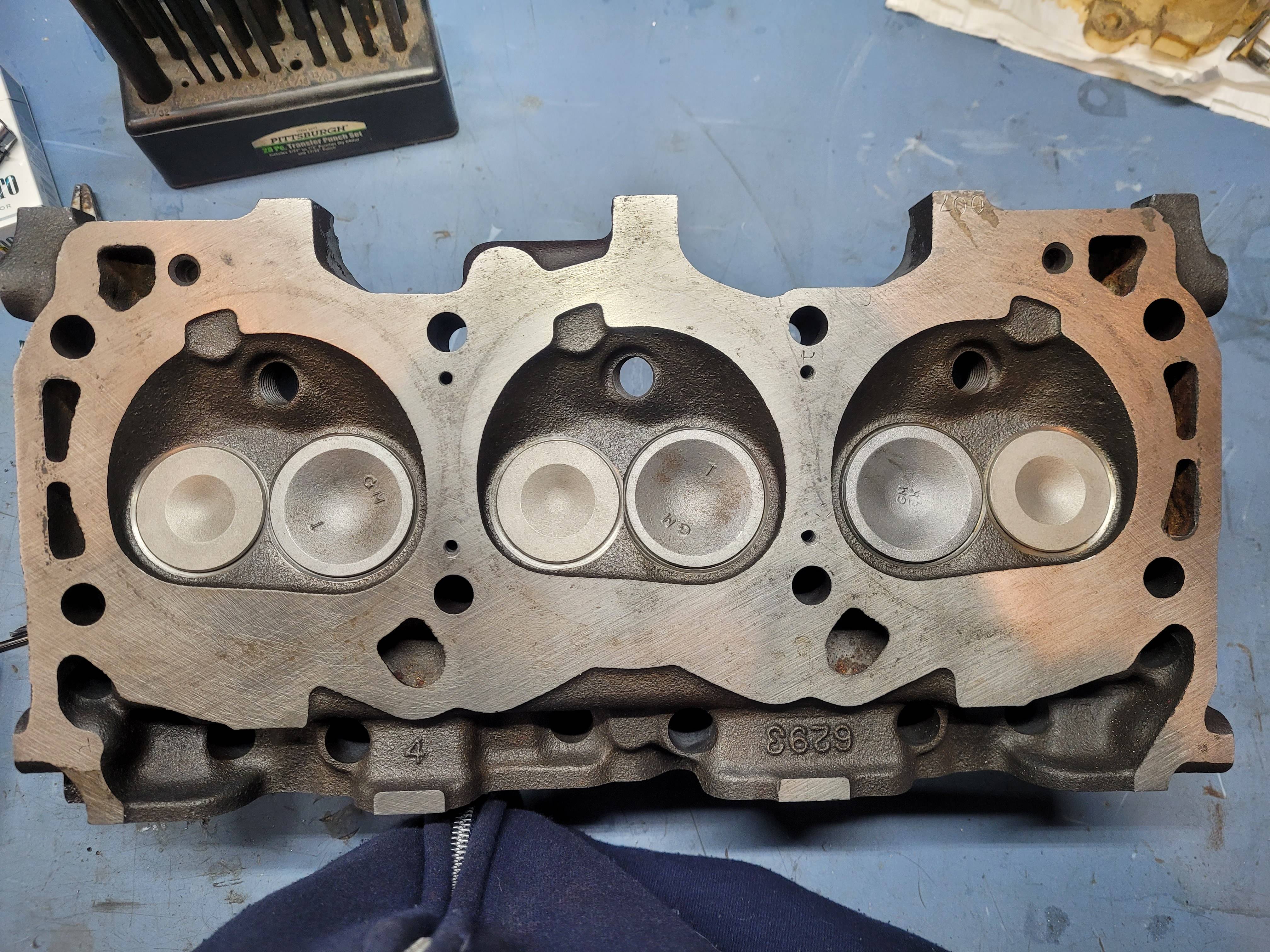

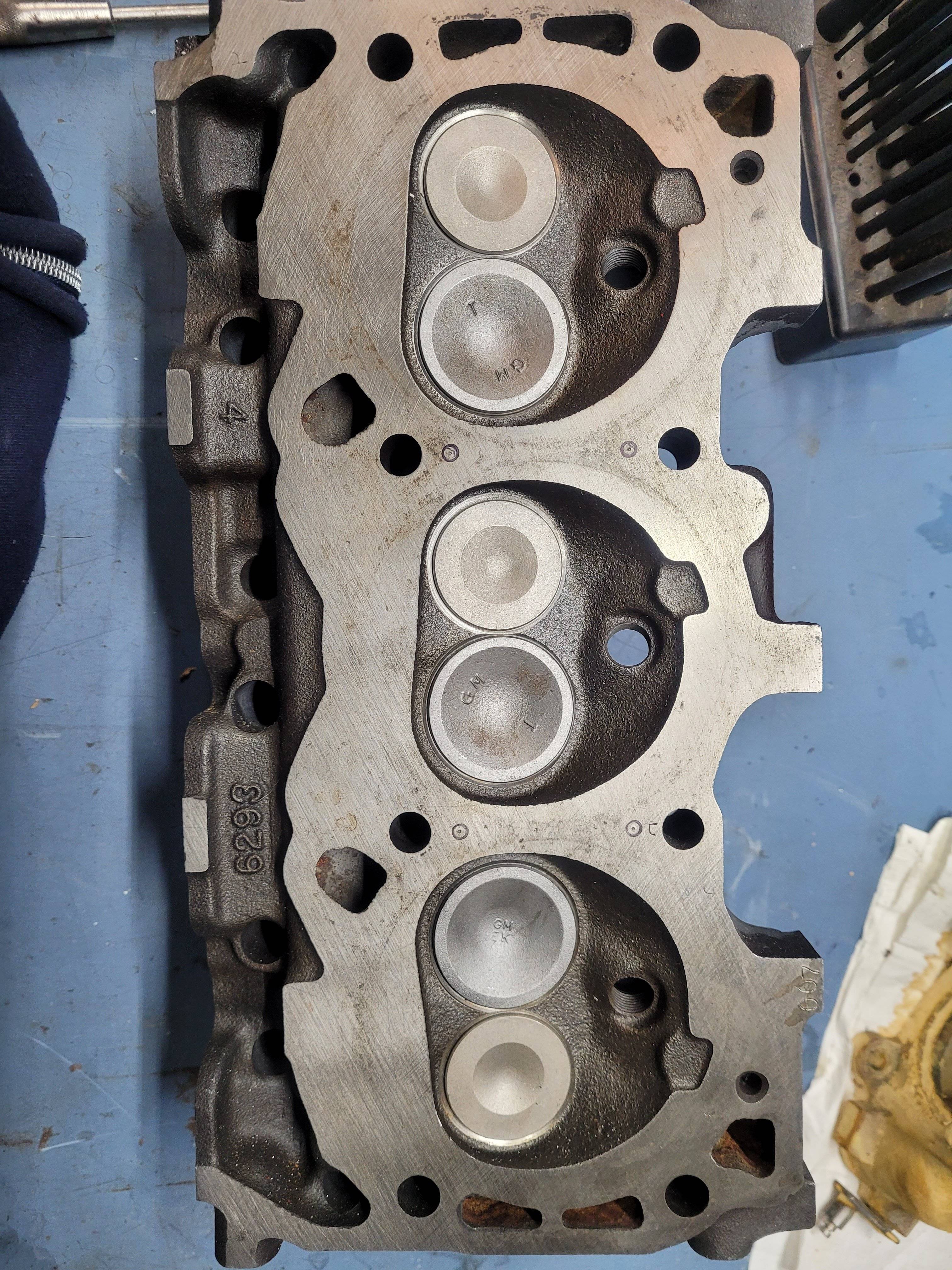

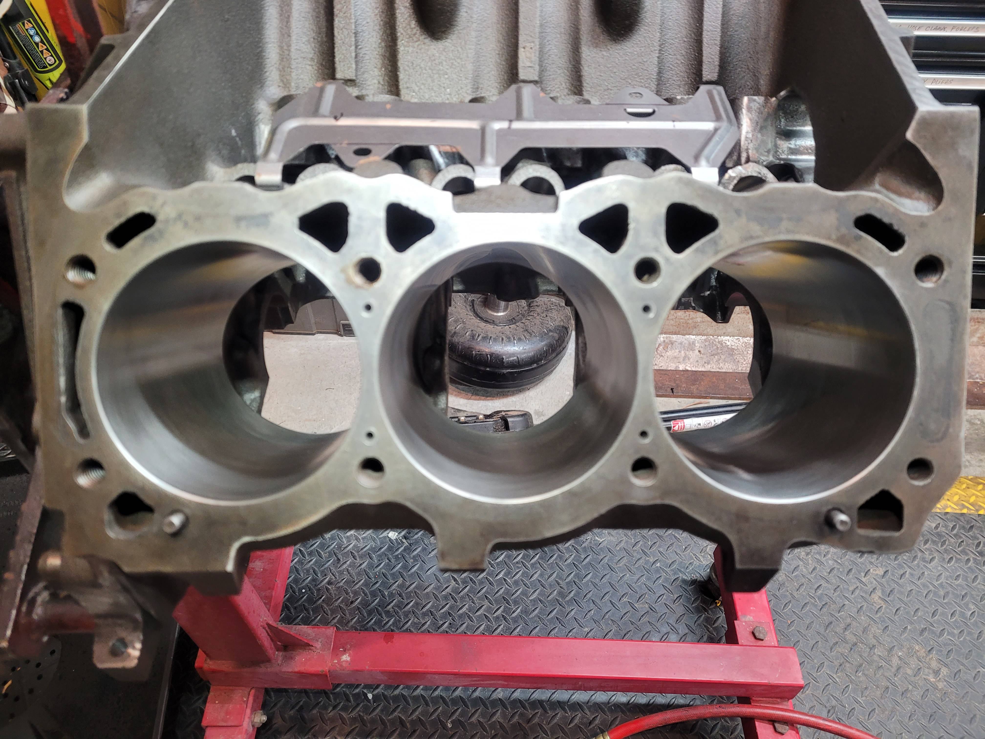

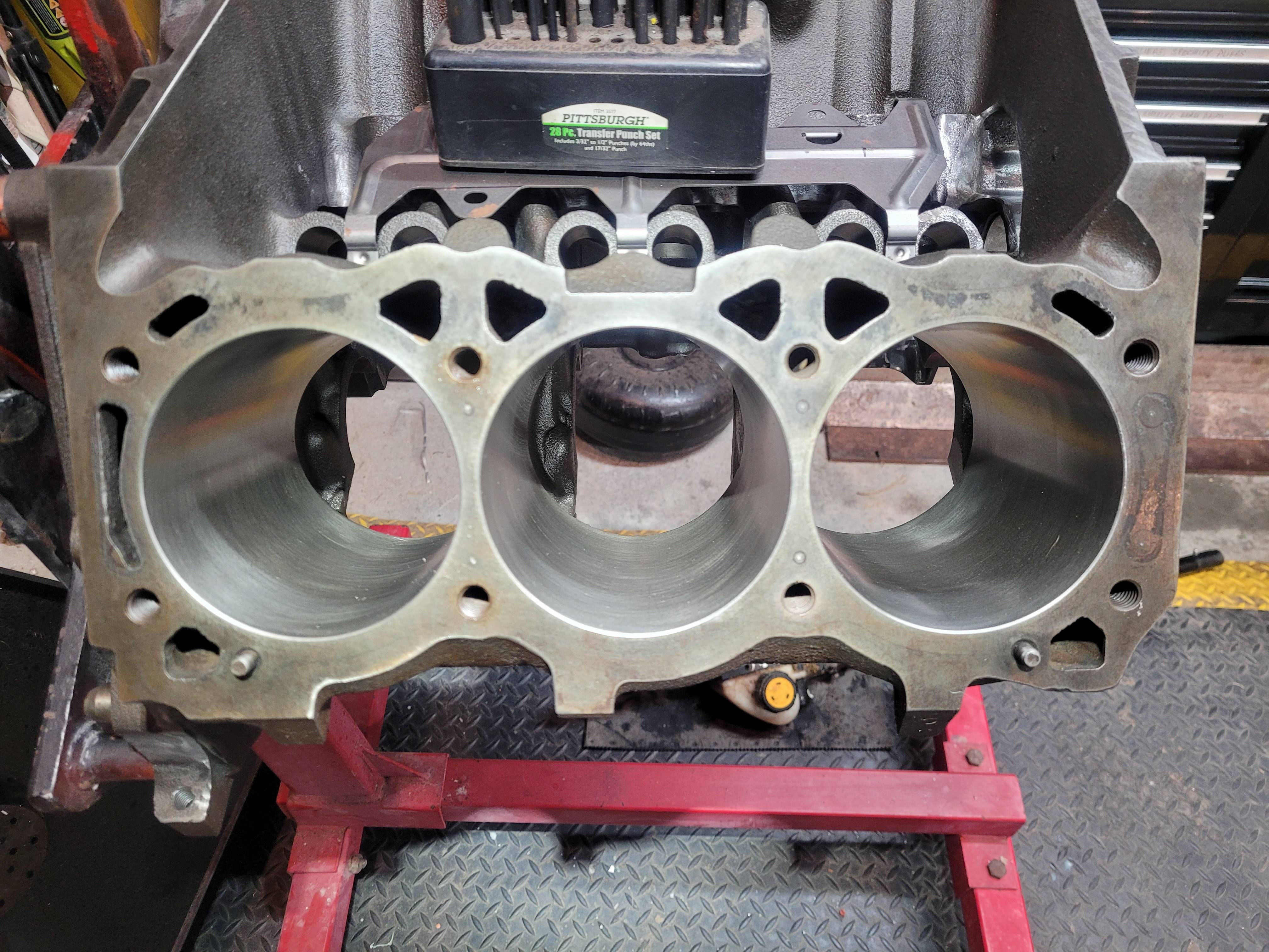

I had some free time this weekend, and I was bored in a heated garage sooo..... I decided to bust out the Buick Powersource Manual and do some more block/head modifications. What you are seeing is the 4.1 block before and after adding the recommended steam holes. The heads received the corresponding steam holes. I used the FelPro 1000 head gaskets for the template, with some dyechem and some transfer punches.
Here is the block before holes.
After some steam holes.
The heads before and after.
The gasket I used. These are for the Stage I Buick Blocks
I'll slowly press on with the oil passage modifications for the mains. The main oil feed/pickup and front cover are done already.
  • Winner
Reactions: 9 users
