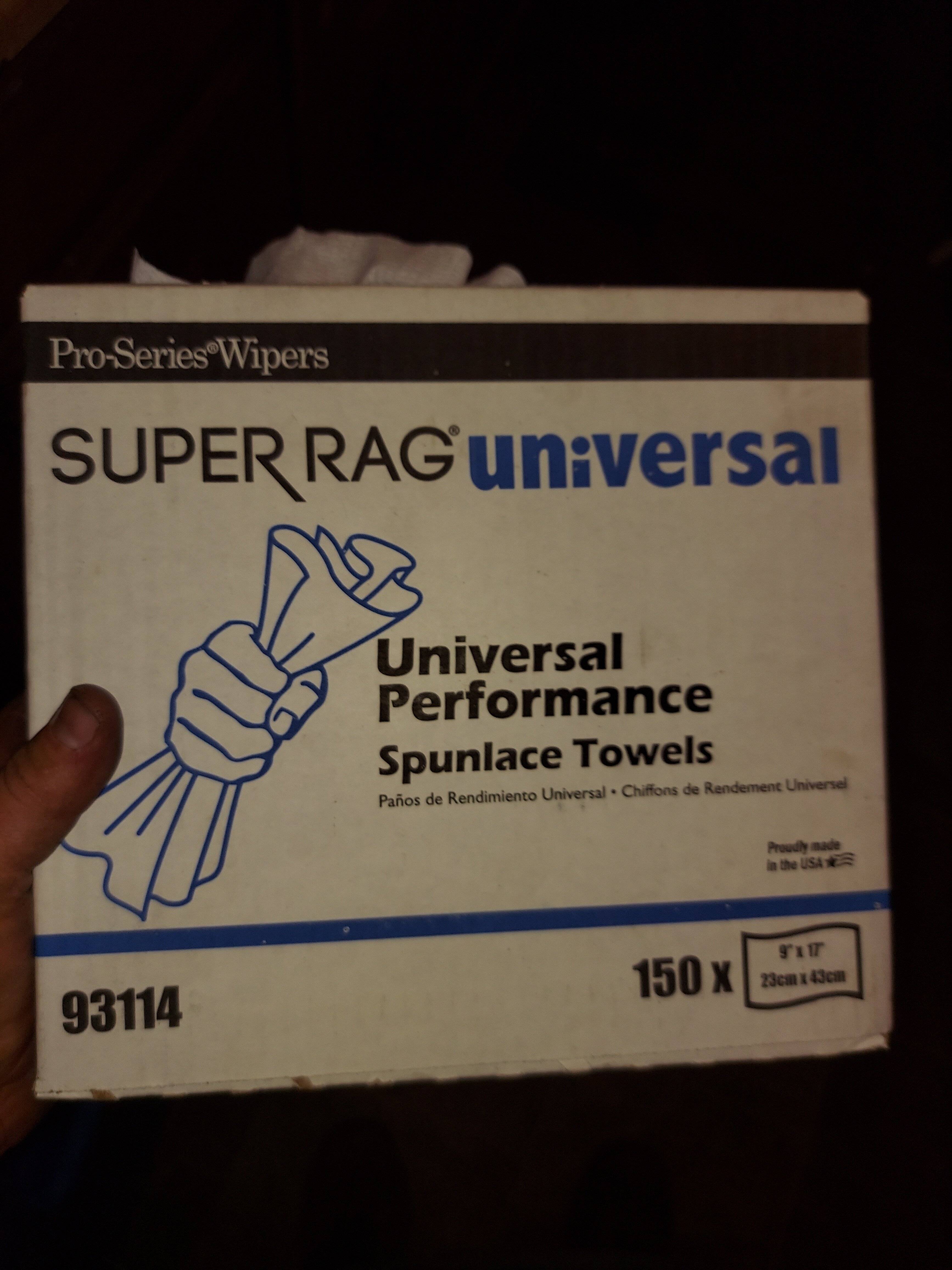

Just a suggestion but I wouldn't use blue shop towels for final wipe.
The tork are better. I get them from my stepdad who works in medical supplies. Any lint-free rag will work. And when your done using them for paint prep, just throw them in a box and use later for less precise jobs. Those blue rags fall apart and leave behind residue etc. I started out using blue shop rags, but after I spent 200$ on my 1st gallon of epoxy primer I couldn't justify the risk.

Just a suggestion but I wouldn't use blue shop towels for final wipe. View attachment 195180View attachment 195181
