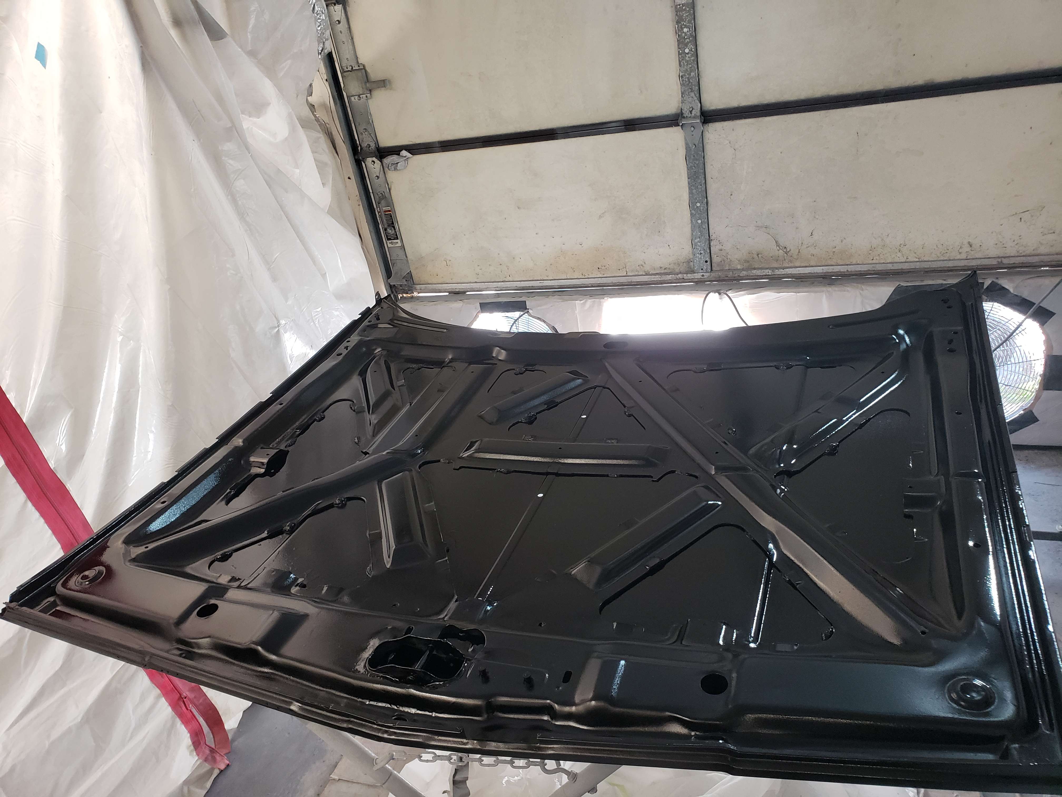

2 days of sanding and today laid 2 coats of epoxy then 3 coats of single stage satin black. View attachment 209553View attachment 209554View attachment 209555View attachment 209556
Cars looking great. It's gonna be a badass ride real soon. Keep up the awesome work. You seemed to lay down that black pretty smooth. Did you find it easier to spray, in comparison to the ss white?

I will have to research using oven cleaner on plastic. I used it to strip underbody and it's strong stuff. I'd hate to dissolve the plastic!
And yes the ss satin black seemed to lay out better than ss white. Or maybe I'm getting a little better at the process 🤔
