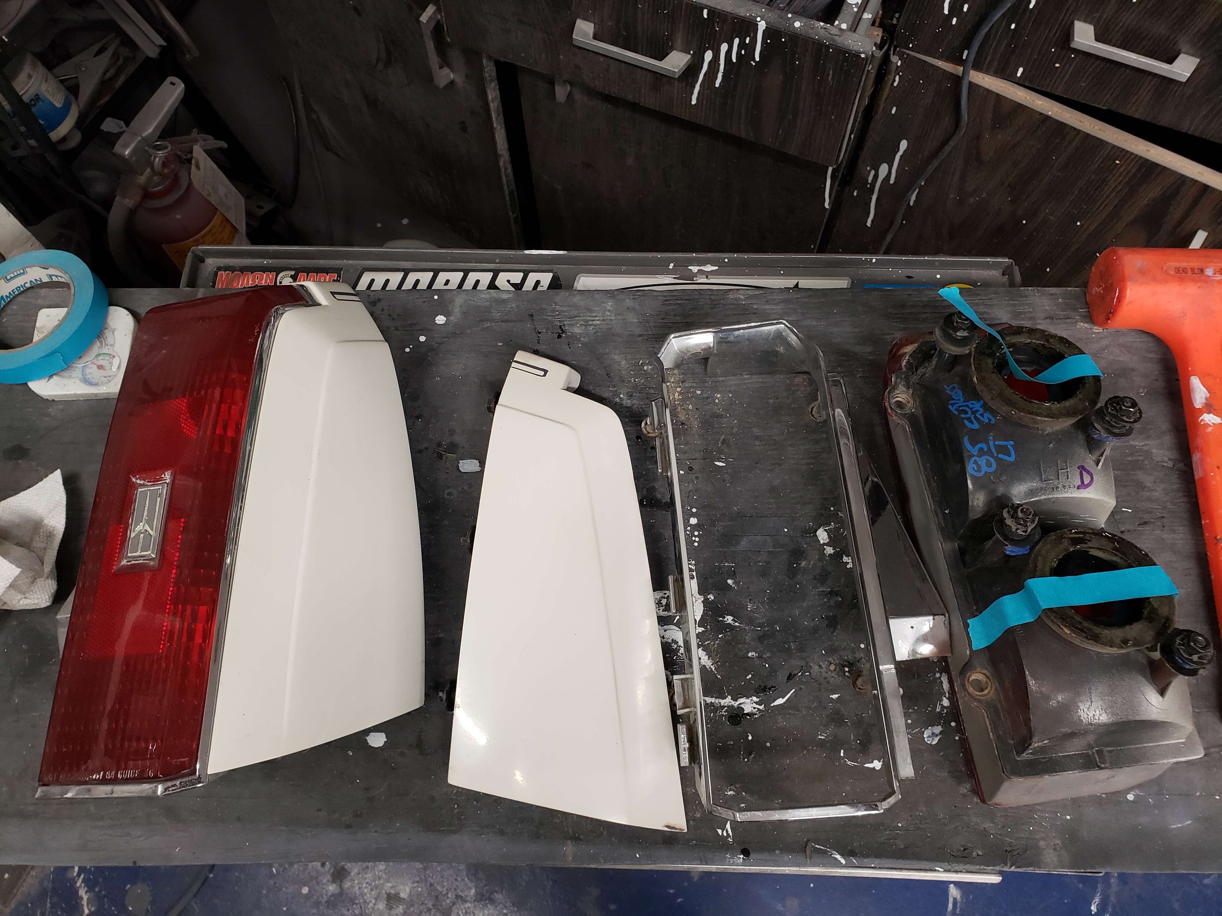

I need some direction. The rear tail light assembly is plastic. Before I ruin anything can someone briefly explain the prep and primer steps?
Can I use the same epoxy primer?
Do I use adhesion promoter? (I have Bulldog)
Also the 'chrome' is going to be black if that matters
Thanks

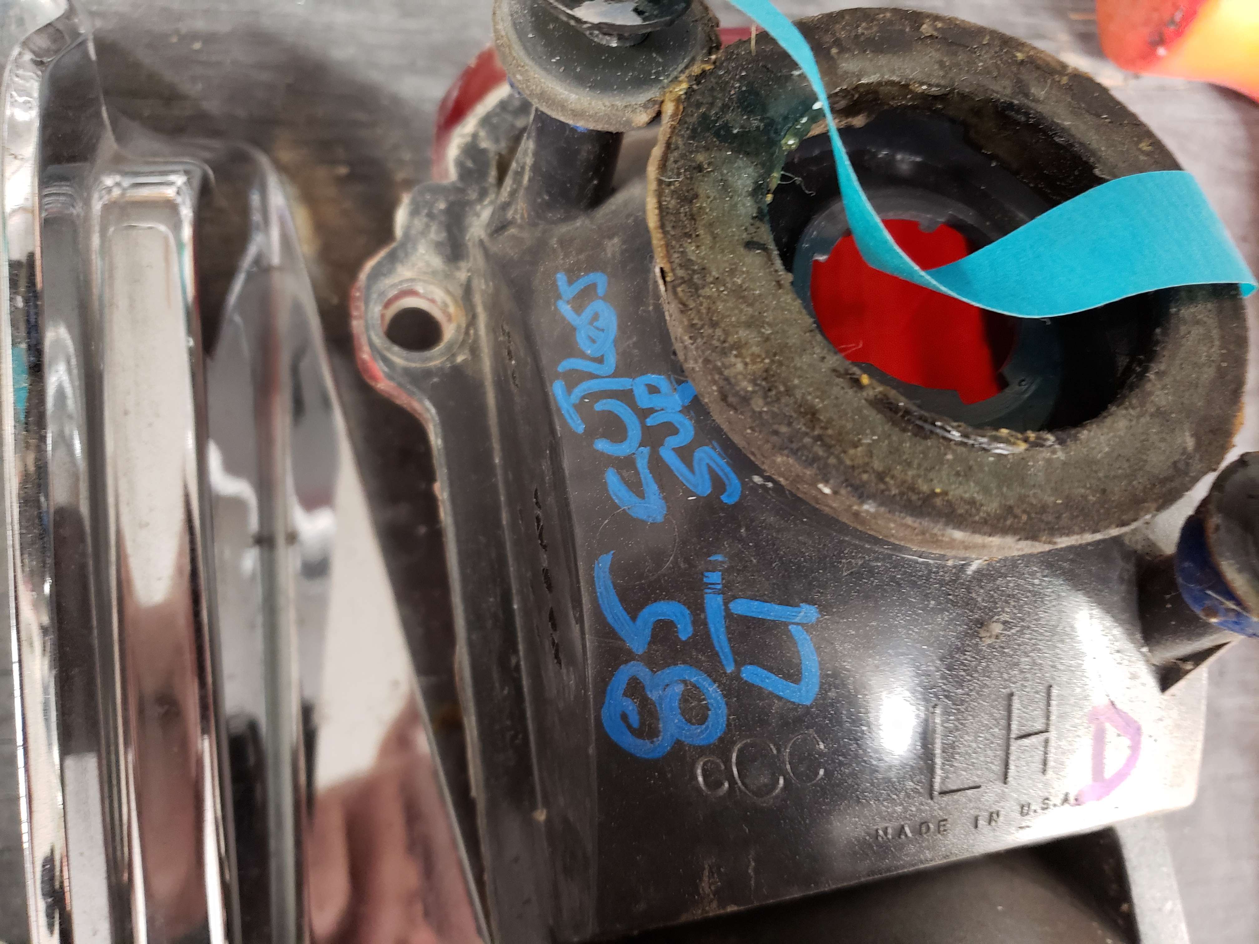

Interesting on the factory writing (85 Cutlass) when mine is an 84. Guess it was made later in the year View attachment 209681View attachment 209682
