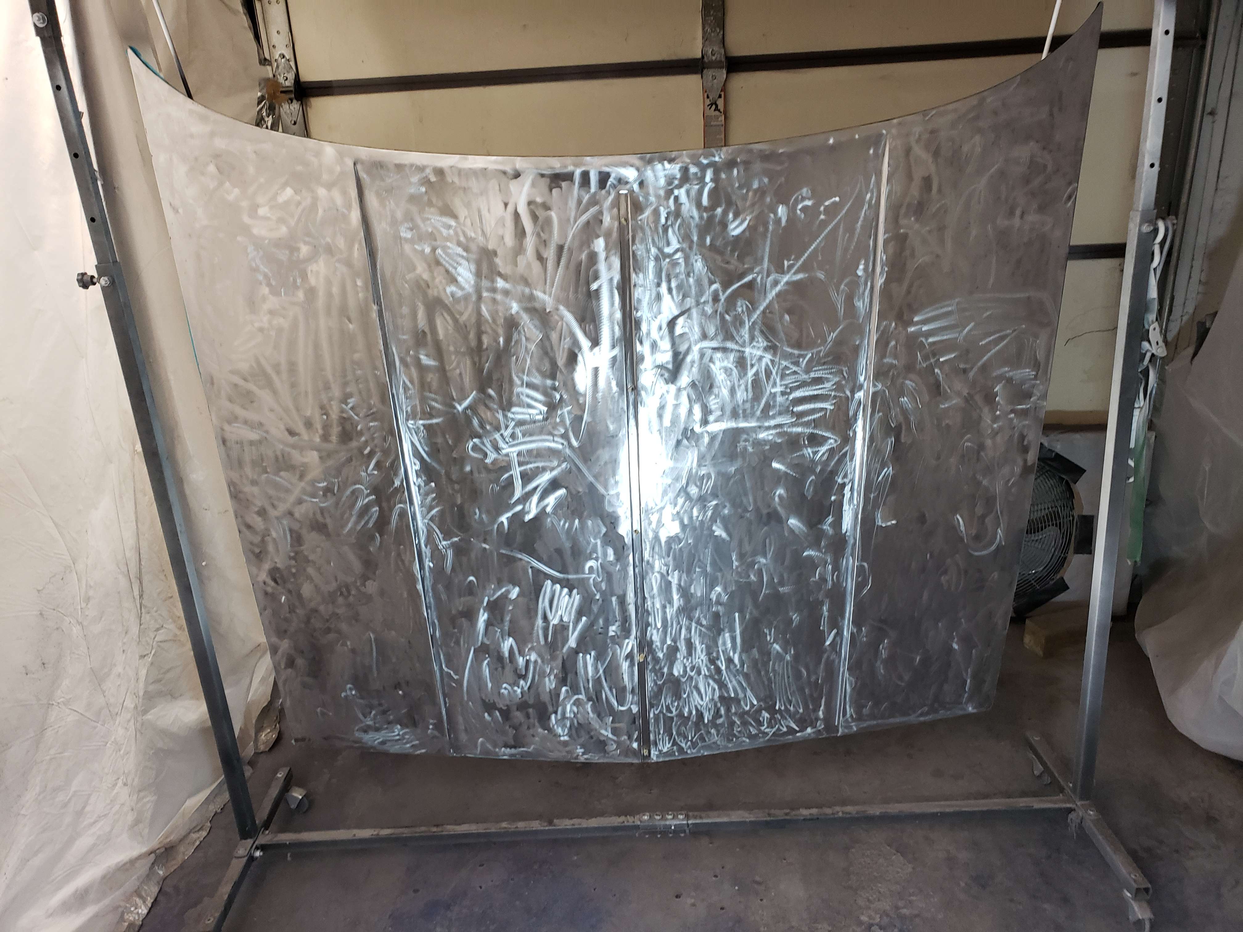

Last of the major stripping done. Epoxy and some hi build next.

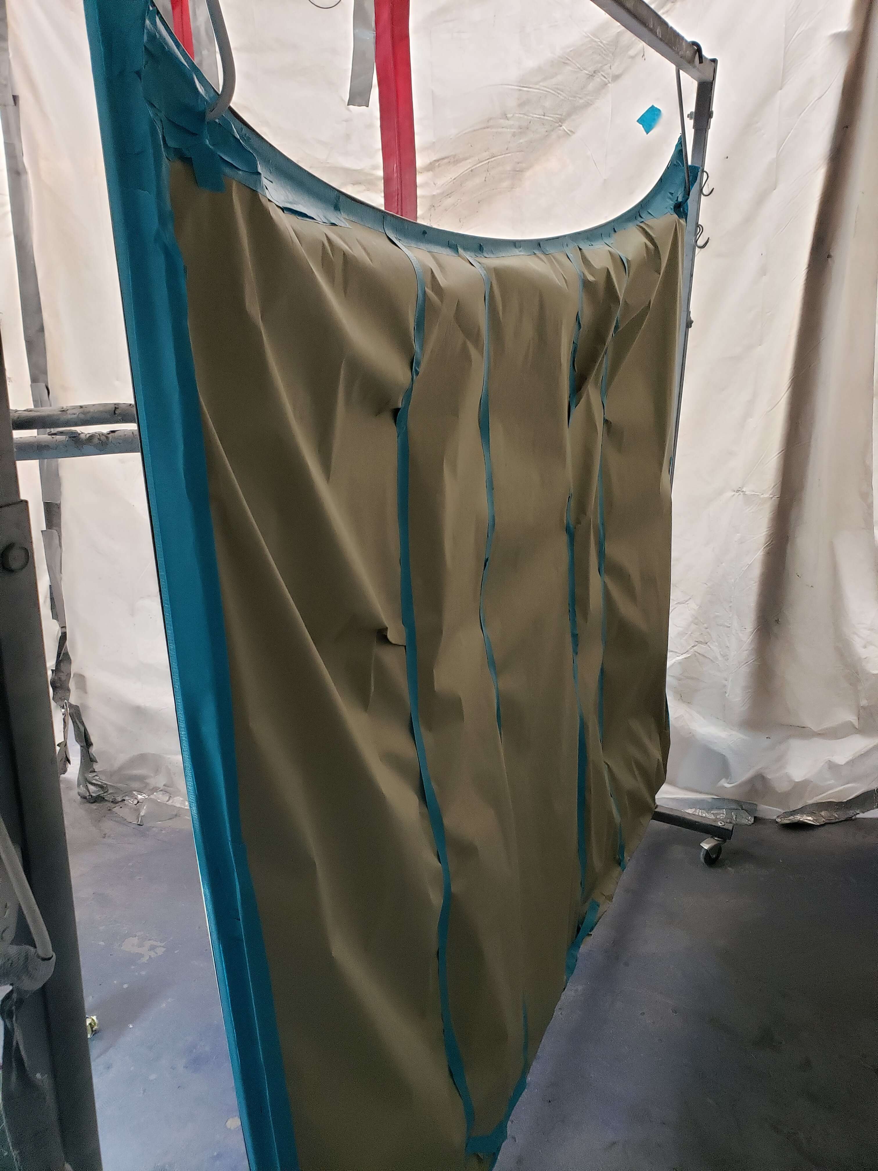

Then a coat of epoxy and three of high build on hood.
