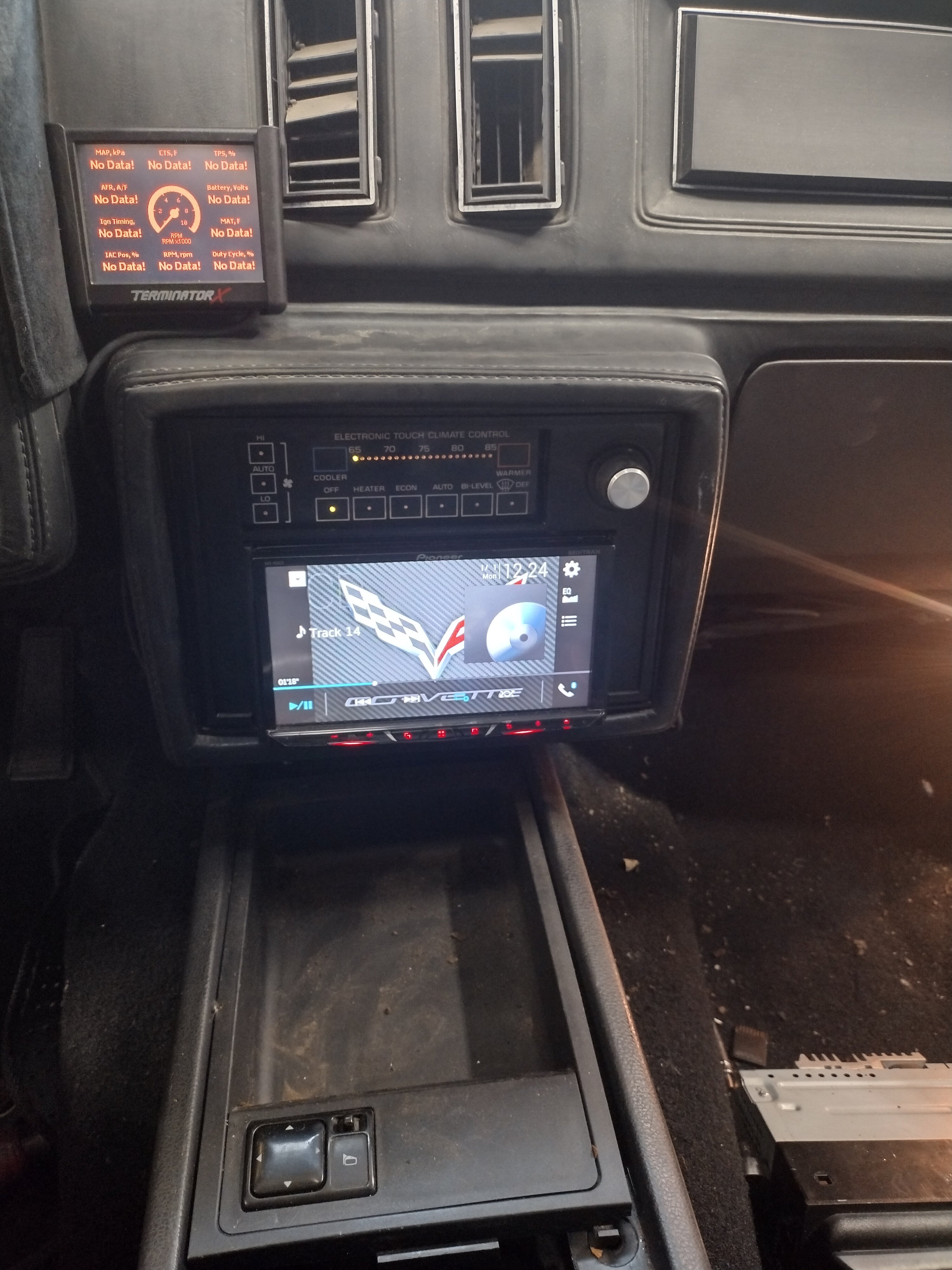

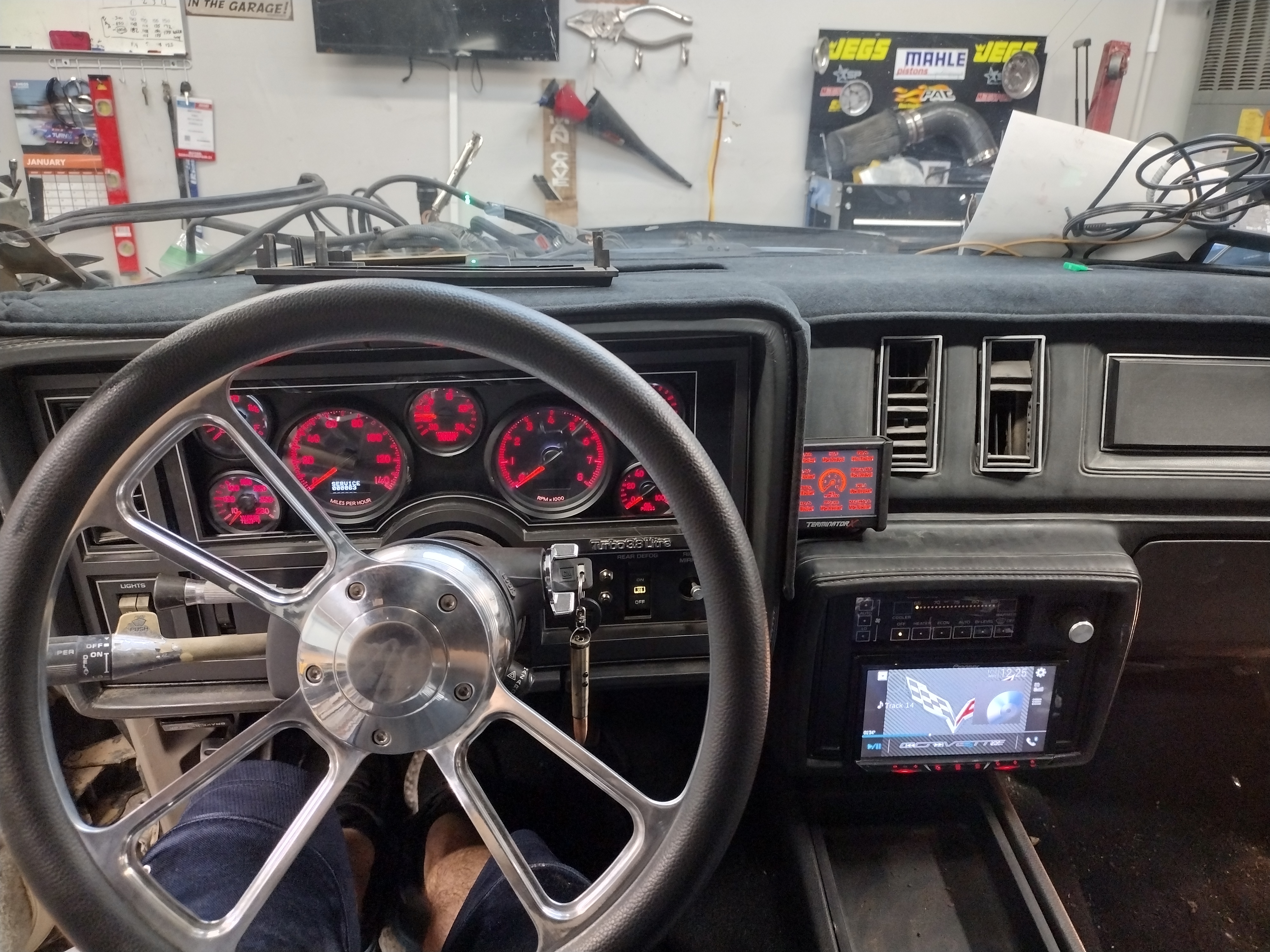

I'm waiting on parts so I got around to installing the double din radio in the GN. Bought the bezel off of eBay and it needed some modifications to make it work but looks good.
What all mods were needed to fit the radio? I've been watching the Chevy version of those face plates but don't like the seller's pics in his listings as they kinda look like a hack job to the dash.
Minor bending of the lower metal support underneath the radio and the radio fits really tight. Sorry I don't have any pictures.
