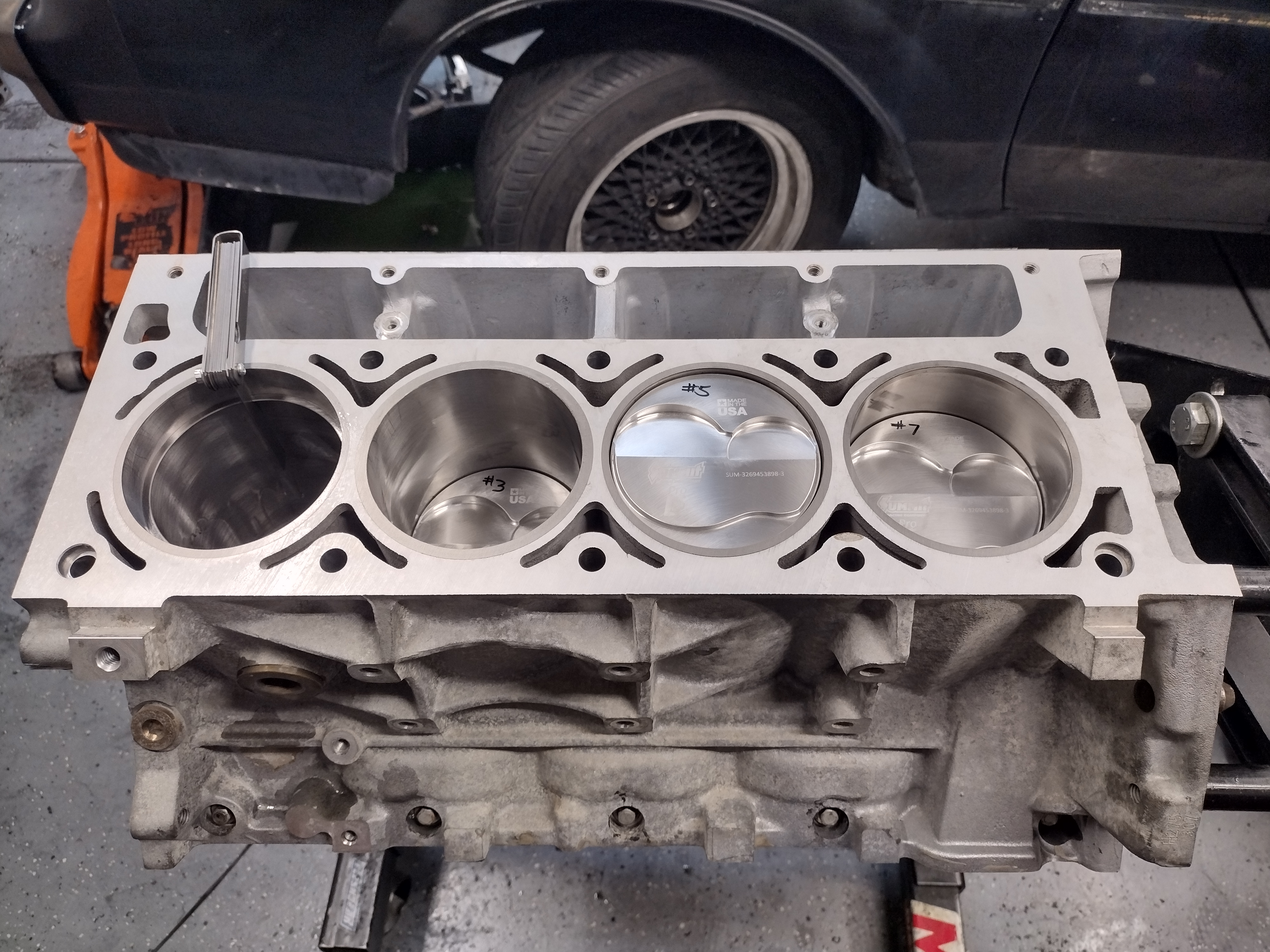

Quick update. I dropped the LS1 block off at the machine shop to get it honed to spec for the new piston. I was advised that one cylinder required a new sleeve and they would have to deck the block after the sleeve job. Also the big end of the rods are getting resized as I'm getting arp rod bolts installed. Machine work is pretty pricey! I'll post the prices when I pick up the block
Reactions: Texas82GP

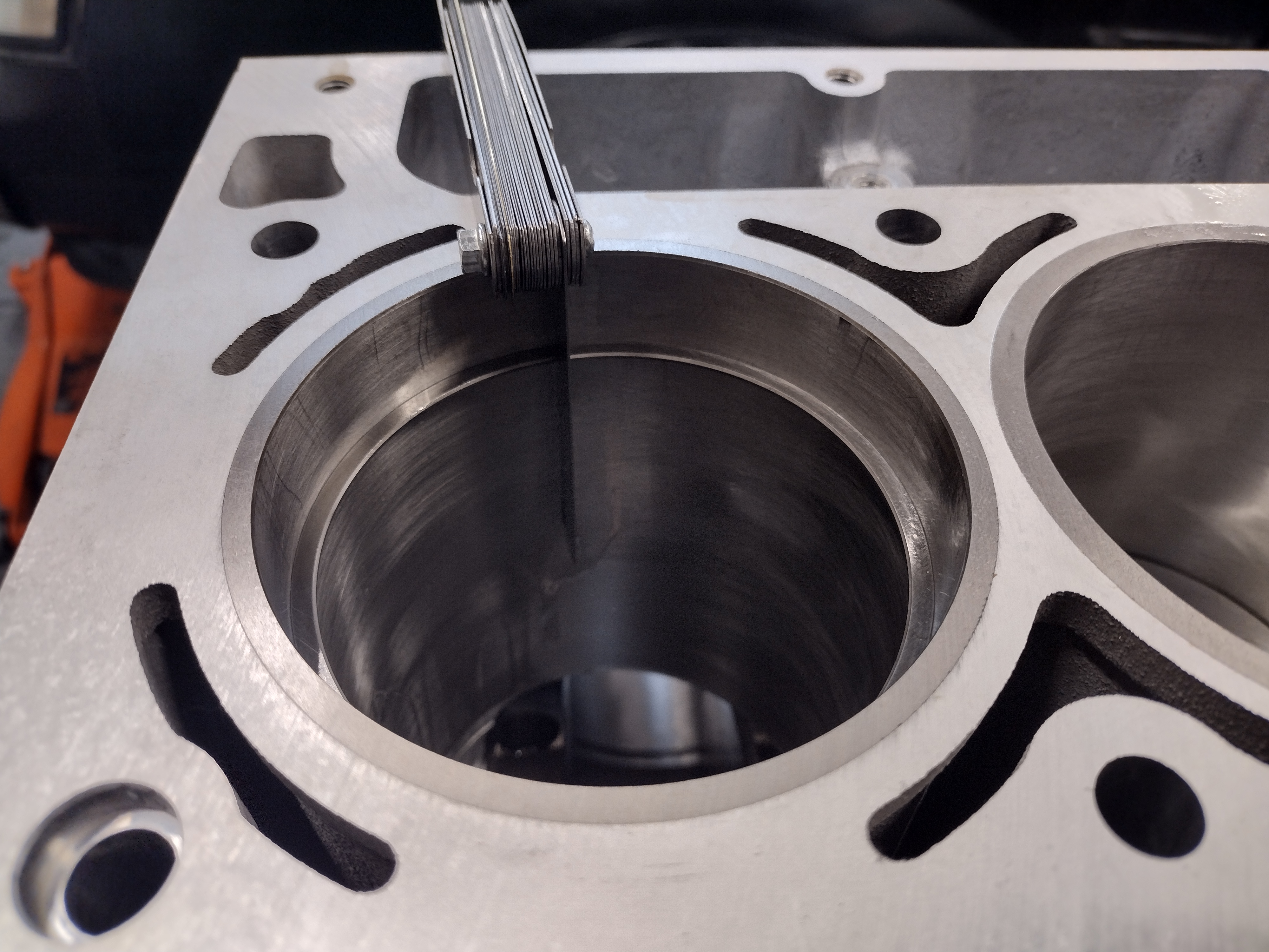

All right just got the block back from the machine shop. Boy has prices really skyrocketed. $2000 worth of work. New cam bearings, arp rod bolts, resized rods, installed pistons, cleaned block, sleeved one cylinder, bore and hone, block decked, and crankshaft turned 10 rods and 10 main

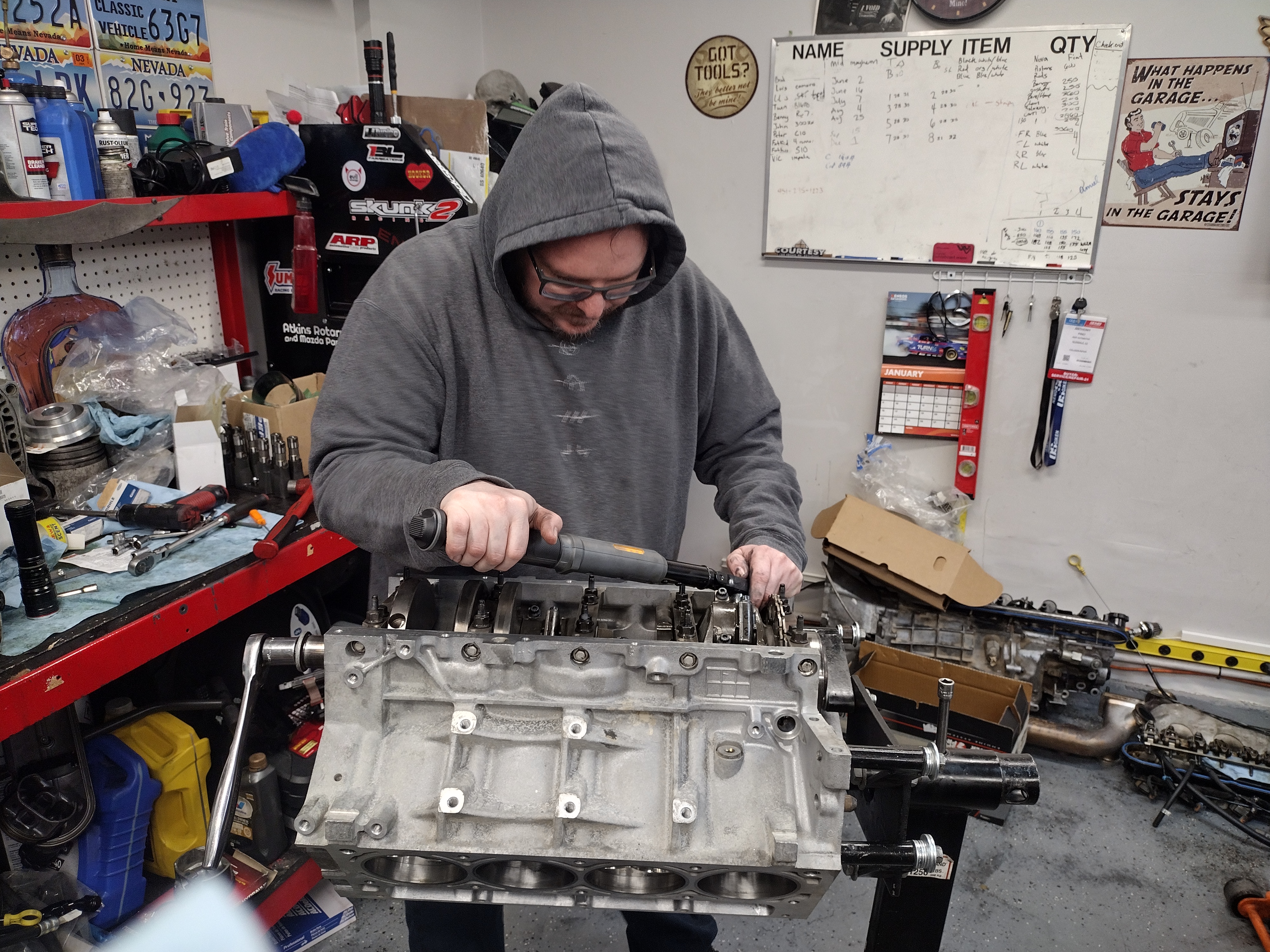

Crankshaft is installed and torqued down
