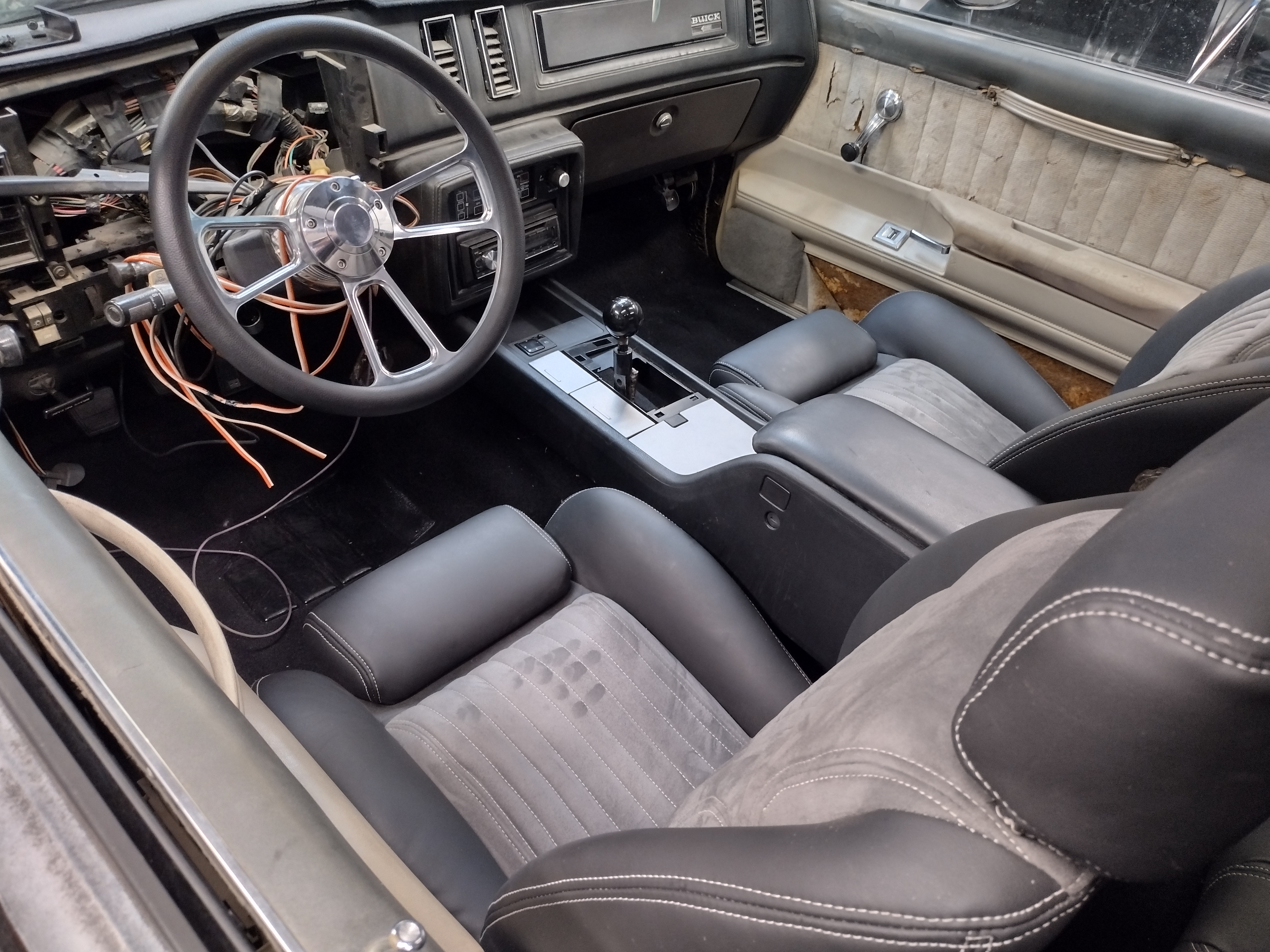

Just a little bit of work left, passenger plug wires, radiator, turbo intake, and intercooler. There will be sound turbo sounds coming from the engine very soon.
So we just ignored the seats that no longer look like they've been raped by a cougar? They look great by the way.
Yes sir they look a bit better than before. JK. I kinda wished I kept the GN logo in the seats but for some reason decided to keep them plain.
