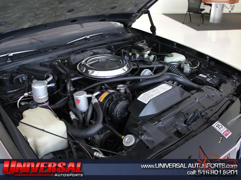

I am missing the heater vacuum reservoir. Does anyone have a pic of where that mounts?

On the vacuum ball location, PM 83hurst#1812 for a picture. He owns an extremely original survivor.
For the heater vacuum reservoir I believe it hangs off the heater/ac box. There is a little built in bracket for it.
I looked at an underhood picture of an 83 H/O that looks pretty correct and I don't see it, which is why I made the suggestion I made above. In this pic the pink vacuum line looks like it is running to the front????
That's where the vacuum ball is on some models. I've seen them in many places. Driver side, passenger side, up on the ac box, etc. Mine was on the driver's side for the crusie control. That has an Olds 307 in it, so the battery is on the driver's side.

I do have a vacuum ball on the drivers inner fender, rearward of the wash bottle. I assumed it was for the cruise setup. The heaterbox vacuum line wouldn't reach there.
I have seen the A/C box bracket....there is an A/c cutoff switch relay there, as shown in the Chassis Manual. I couldn't find the vacuum ball location in the manual.
The pink vacuum line I have looks exactly like that one running to the front. I will check there for a ball too. Thanks!
