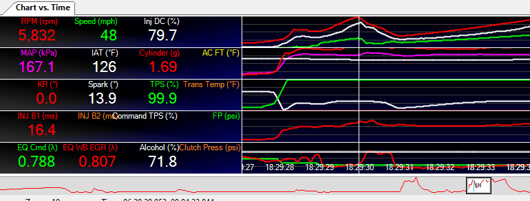

And this is what I consider a spin (this was last fall before i address rear geometry and shocks). 48mph wheel speed in 1st gear, 5800 rpm, 10psi, 13 degrees, time to shift
But I clearly didn't have the car speed because now that the clutch is in the wheels stopped spinning and are only 23mph.
Now the engine has been lugged down to match the wheel speed the car is actually going, it still has 10 psi but 2300 rpm and 4 degrees of timing
