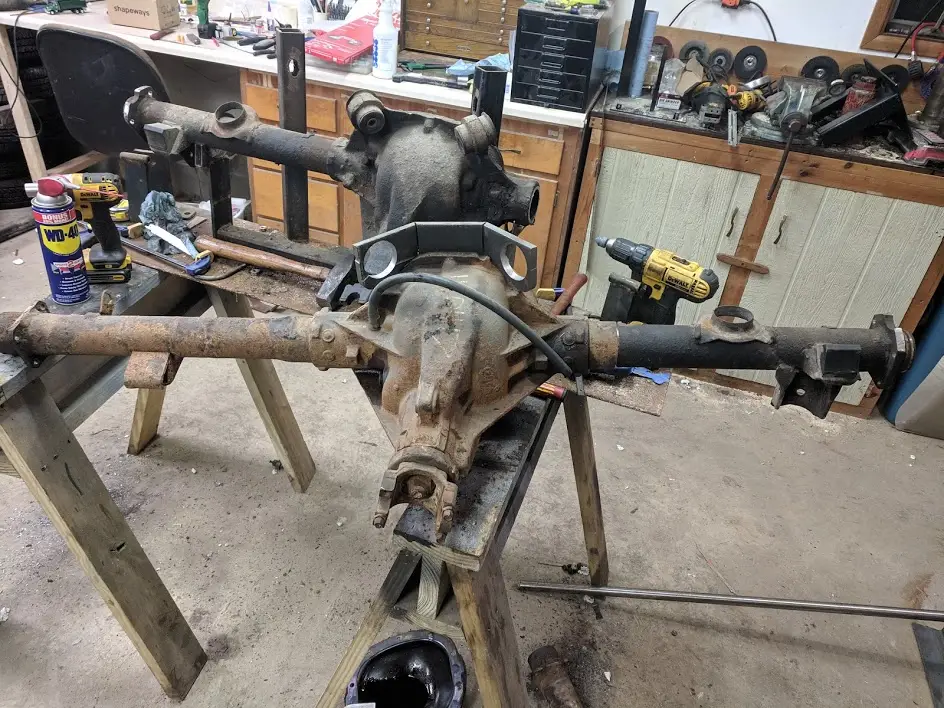

80 7.5 out of the wagon

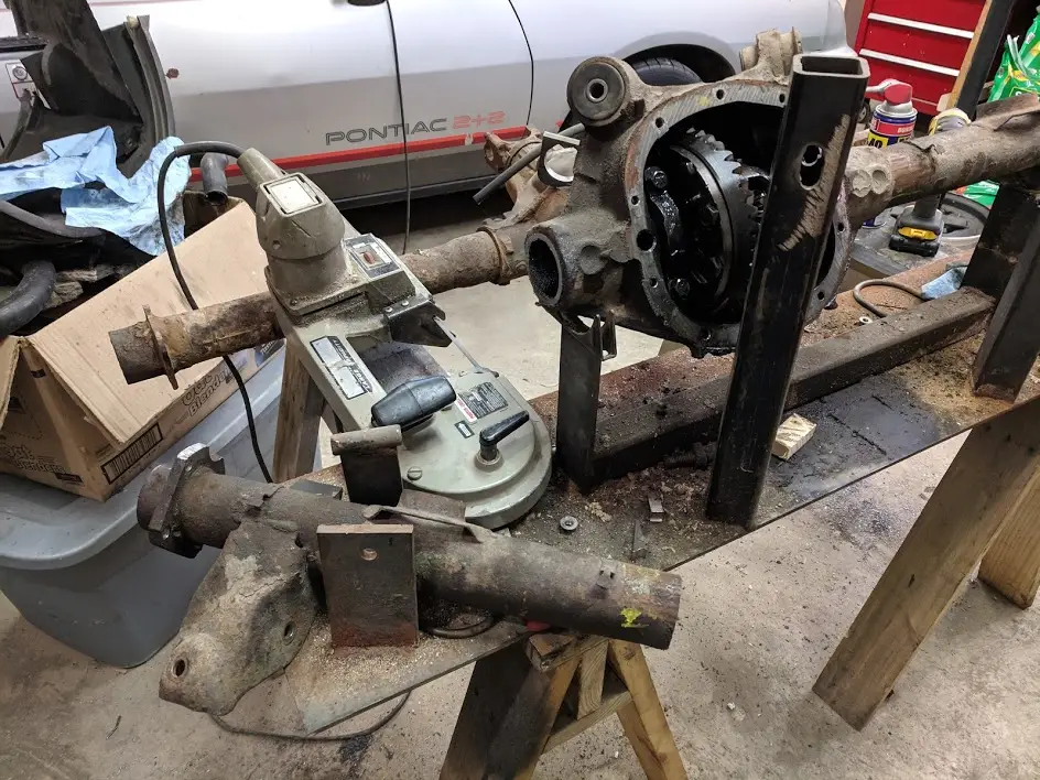

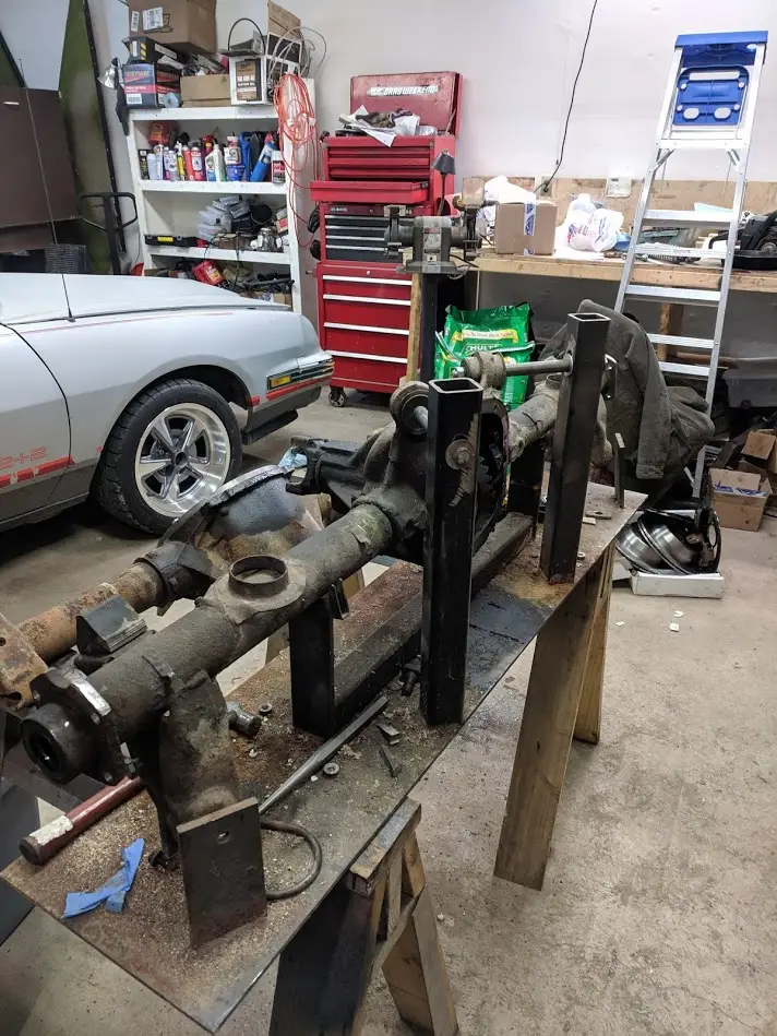

Does it still work, fixture edition

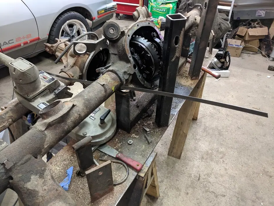

Portaband, guess my year and a half old saw blade I got on the saw when I got it from the pawn shop finally had its last lunch
Ran to the farm supply store and got a new one and finished up
Yay for lathes

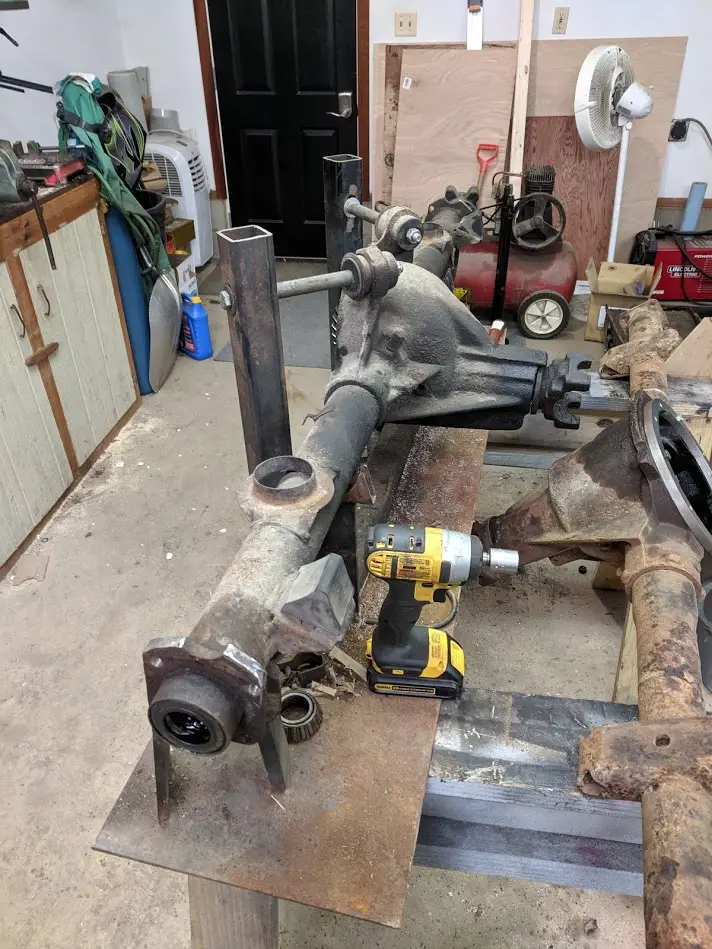

Bam! 7.5 tube in the 8.6 zr2 housing.
Yep, going back to stock width.
I am happy with my "wide" zr2 width rear I had in the car the last almost 2 years but I settled on the year one rallys for my wheels and they only come in 4-5" BS and I needed 7 to make the zr2 rear to work.
Plus I had this idea of swapping tubes and wanted to give it a shot. 4th gen F body guys have done it with swapping 7.5 tubes onto an 8.8 housing with the "hiltsy" laser cut torque arm mount and butt welding the tubes to the housing. I looked at the 8.6 and realized I could just turn the OD of the 7.5" tubes and slip fit it into the 8.6 housing, throw my plate on, install 30 spline moser axles, reuse the zr2 brakes, and be in business.
