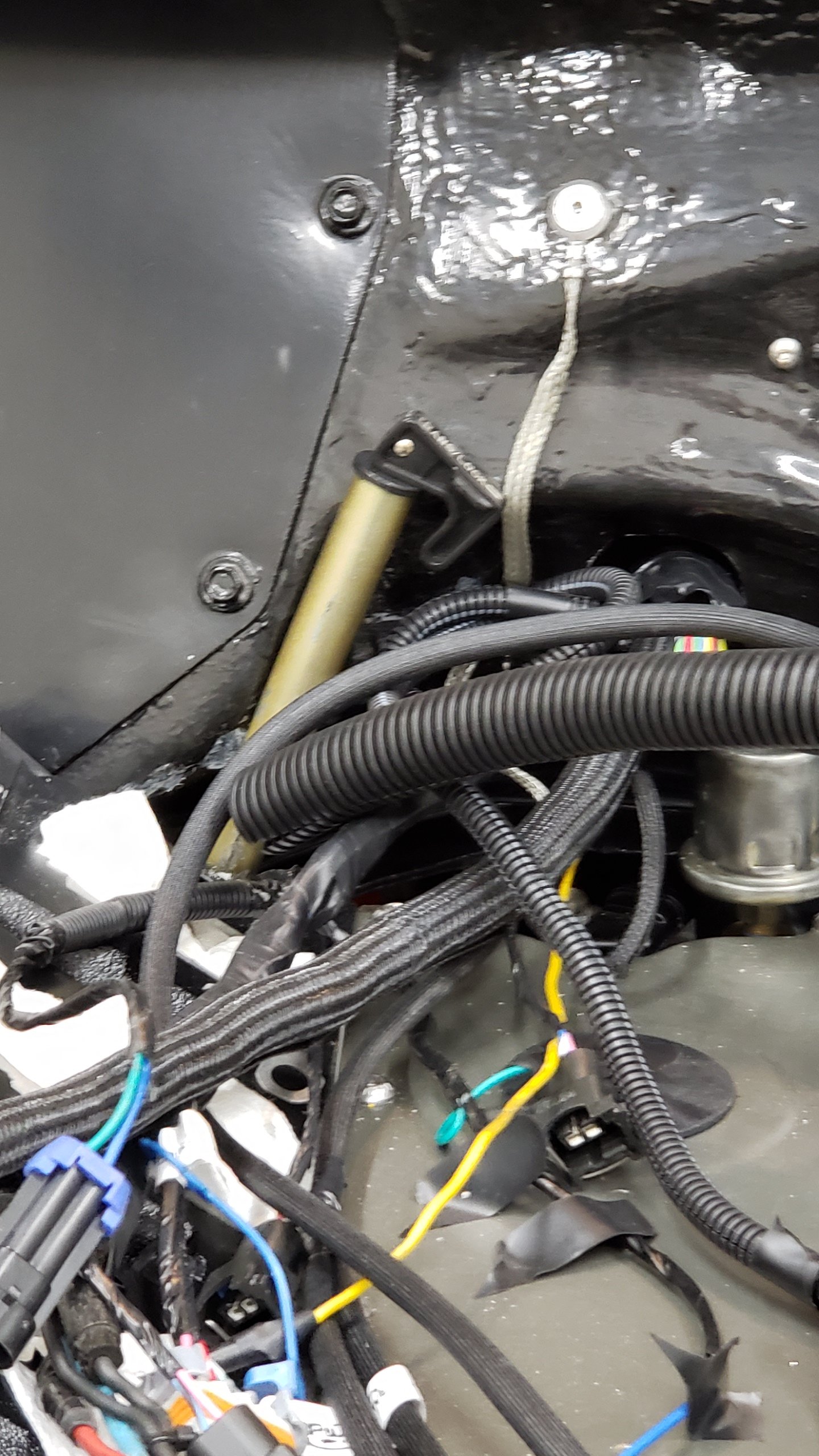

Alright, after getting my tail kicked last night by a stupid trans dipstick I regrouped. It's hard for me to justify spending north of $50 for a damn dipstick, so I used some 'persuasion' and bent mine more towards the driver side to clear the firewall!

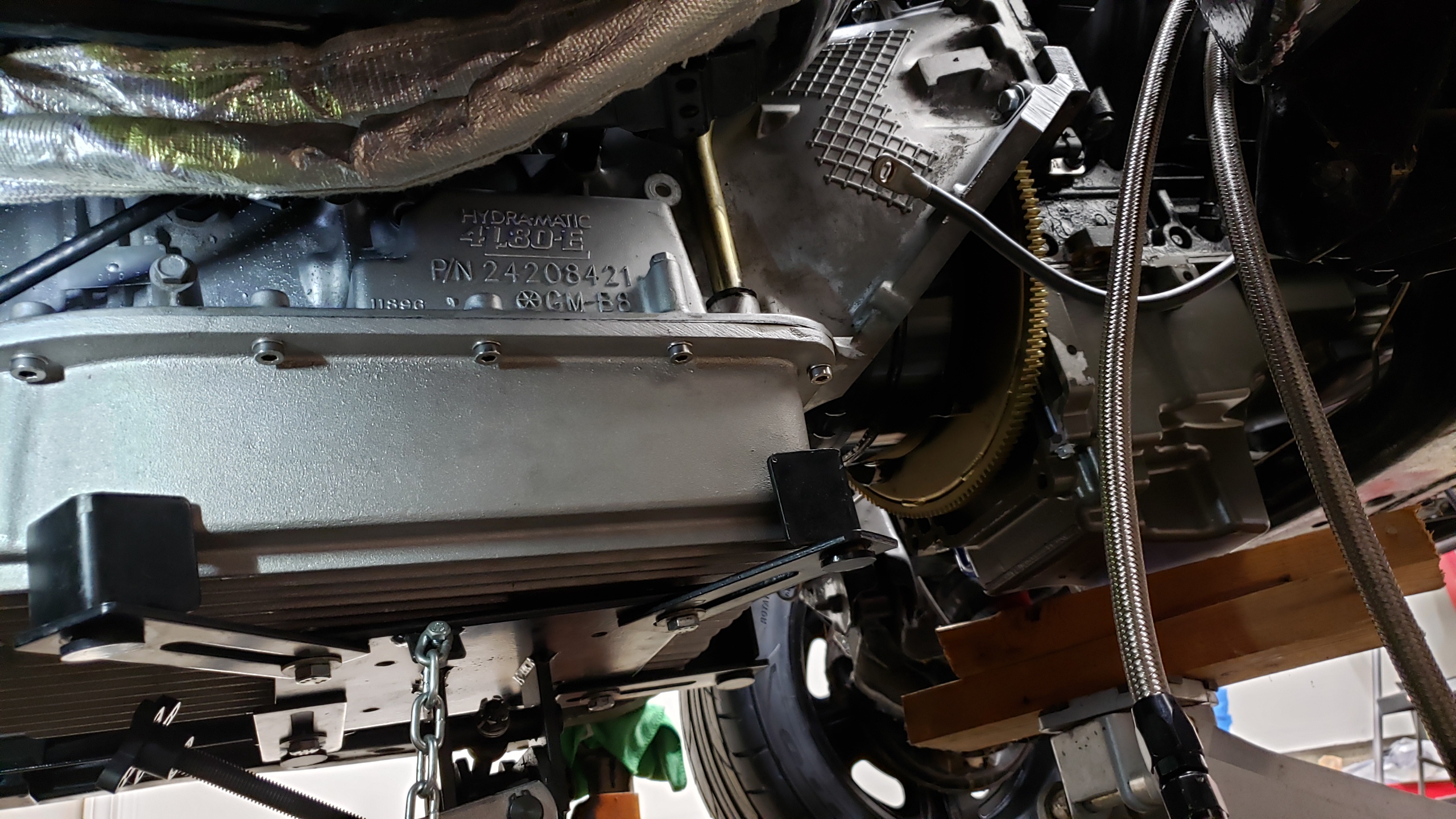

Once done I started the fight of bolting that heavy *ss trans back to the engine! It kept getting askew and the converter was binding so I just had to be patient! I took a break and came back at it and it's done now too! Gotta call it a night due to lack of sleep last night, and a heavy drive/shred schedule tomorrow but I'm back on track.
Once done I started the fight of bolting that heavy *ss trans back to the engine! It kept getting askew and the converter was binding so I just had to be patient! I took a break and came back at it and it's done now too! Gotta call it a night due to lack of sleep last night, and a heavy drive/shred schedule tomorrow but I'm back on track.View attachment 111994View attachment 111995
I know you don't want to hear this...
But, that is abnormally tight. Is there anyway to move the engine forward at least half an inch?
