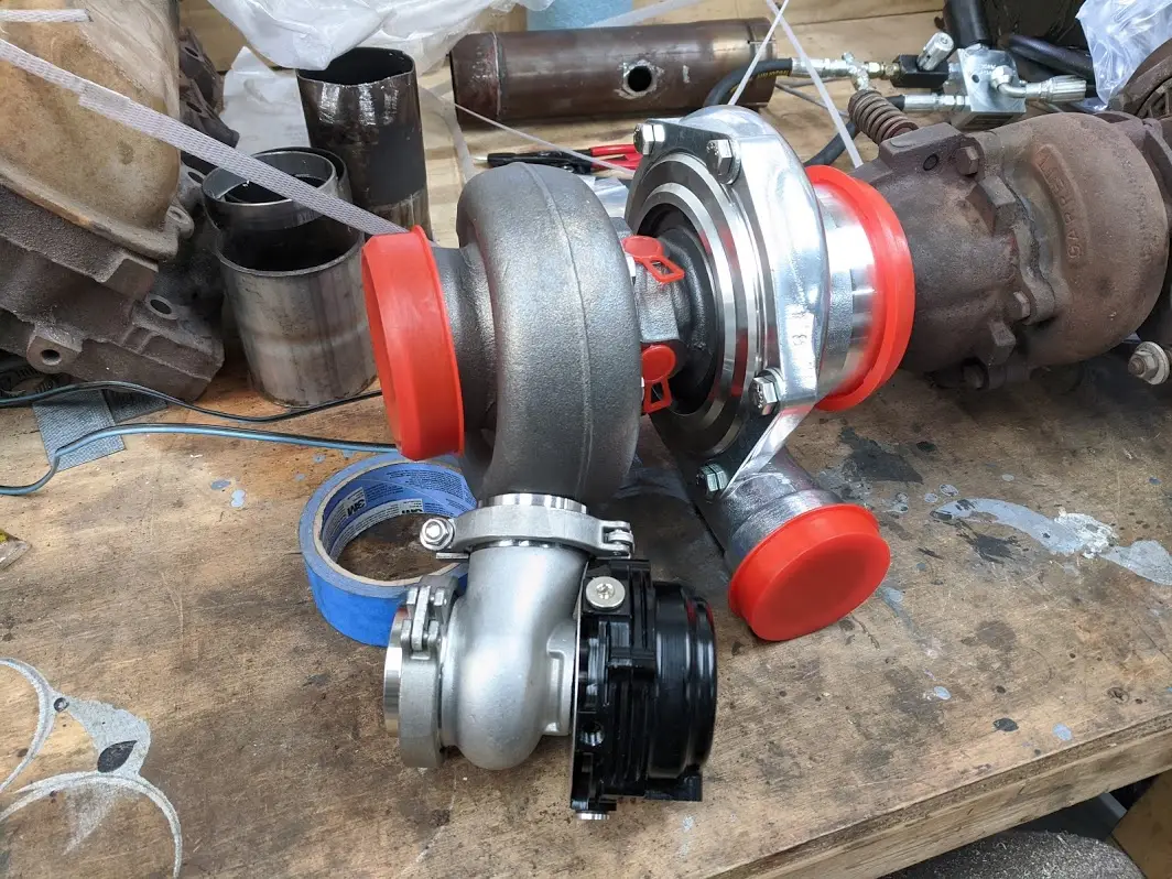

The China Whirly Whoo showed up today.
Beijing Air Bender?
Wuhan War Whistle?
Bankok boost maker?
Turbo Buick Cult 'must run PTE or else' myth buster?

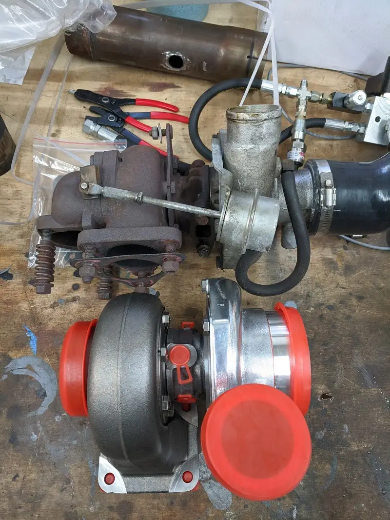

It's a 61/62 VSR T4. I bought the 44mm gate and the turbo from a local guy who moonlights as a VSR dealer so I got $50 off the turbo and $10 off the wastegate so it's like 14% off VSR pricing through their website. If you need VSR stuff I can send you his contact info.
It's a bit bigger diameter wise than the stock GN turbo but very similar in width. The stock GN turbo has a 3" inlet and this has a 4" inlet and the compressor outlet is 2.5" vs 2" on the stocker so I need to rework some stuff there. I am optimistic it will bolt on with a few bracket mods. 😉

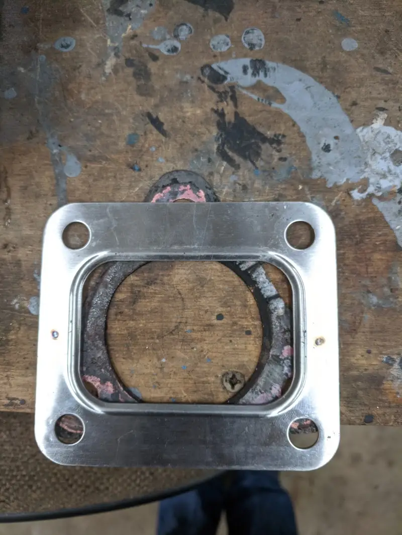

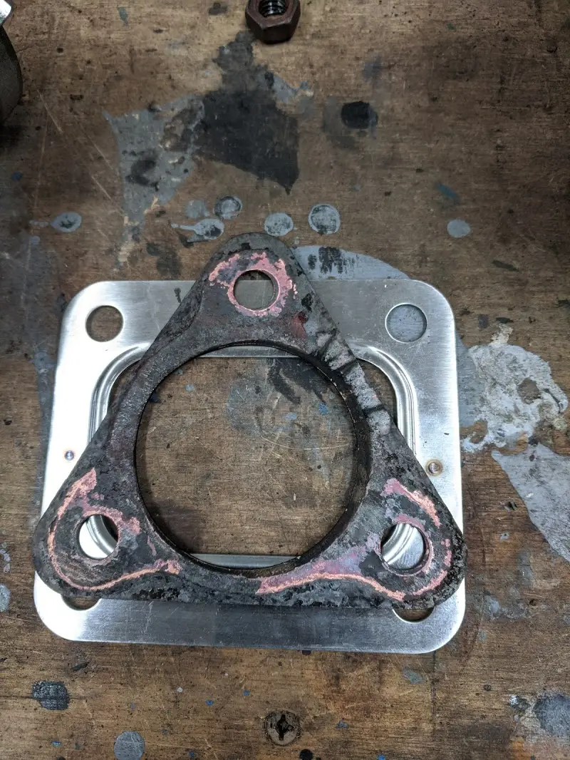

And I need to go from GN to t4 flange so that looks like an hour on a mill 🙂
Beijing Air Bender?
Wuhan War Whistle?
Bankok boost maker?

Whipped up a CAD model of my t4 to Buick flange.
And I am sharing it with the internet 🙂
I want to see all turbo buicks have cheap T4's.
I am renting some mill time tomorrow so hopefully I'll have a part this weekend.
