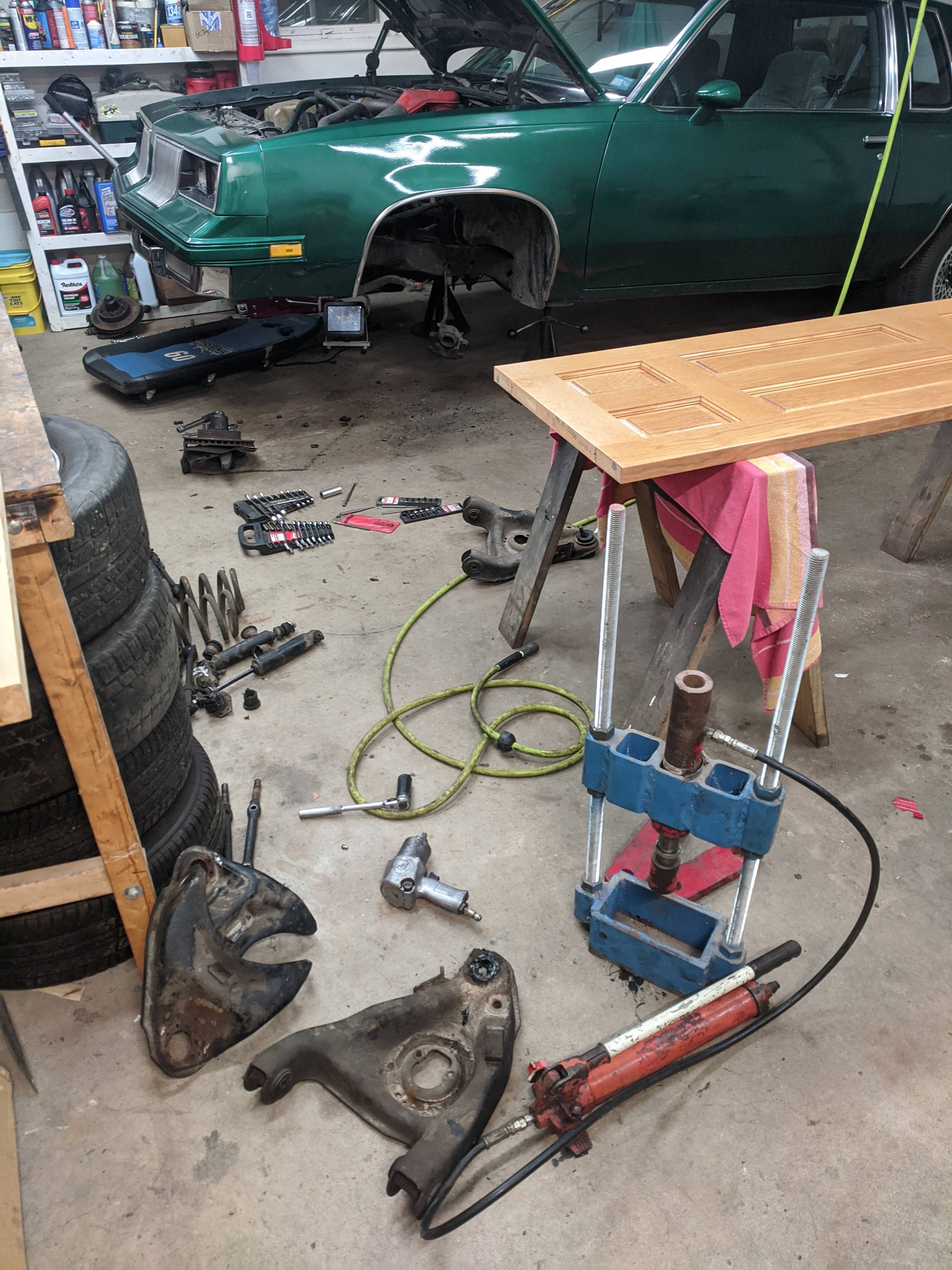

Blasted the front suspension apart tonight.
Both uca's are stripped and ready for bushings and ball joints
Lca's still need to be stripped.
Goal is to pressure wash and paint the stuff I'm saving tomorrow and have it ready to press new stuff in Thursday.
The only thing not oem is the passenger lower ball joint that broke on my when I was 16 and the front shocks (and f41 sway bar stuff but that didn't count)
The Monroe sensatrac front shocks with maybe 15k on them are totally shot, the other lower ball joint fell apart in my press when I was trying to get it apart (cage is still in and everything else fell out the bottom), everything rubber is cracked.
So it was time!

Holy hell, getting these bushings out of the LCA's is a beotch.
Last of the parts arrived today and I knocked the bushings and ball joints out of the lowers. The ball joints fell out but the LCA bushings took like 2hrs to pull out. Had the best success divoting the side with a chisel and then pulling one out with a bolt and the other one with a load of hammer and chisel work to walk them out.
Pressing them in was much easier. I'm for sure set up for this with a lathe, press, and tools to get it done but I can for sure understand why getting entirely new arms for an S10 makes sense for a lot of people.
I also pressure washed the arms off. I need to get some paint off them tomorrow and drop the ball joints in and then get them on the car Saturday.
Usually the lower bushings don't go out but they were on this car!

The trick to replacing those bushings is: a cutting torch. Start the rubber on fire. Once it is burning good. Knock the center out with a punch and hammer. Then cut the iner race part. Knock those peices out. Flap wheel the hole and press new ones in. No big deal, but it tends to piss everyone around you off though.
Not a bad method. I'll keep that in mind in the future.
I've only ever changed rear arm bushings which are easy since they fit in a press. The fronts don't fit in a press (mine anyways) since they are so tall so I was figuring it out as I went.
I was sore this morning and the spot on my hand that a whalloped with my 3lb hammer when I missed the chisel was cursing me from how hard I struggled 🤣
The other method that works really well is to drill multiple 3/8” holes around the perimeter of the middle insert. Knock the insert out, then collapse the rubber in on itself with the void left, knock it out, then repeat the collapsing technique with the outer shell.
The whole process can be done in less than 5-10 minutes per bushing.
