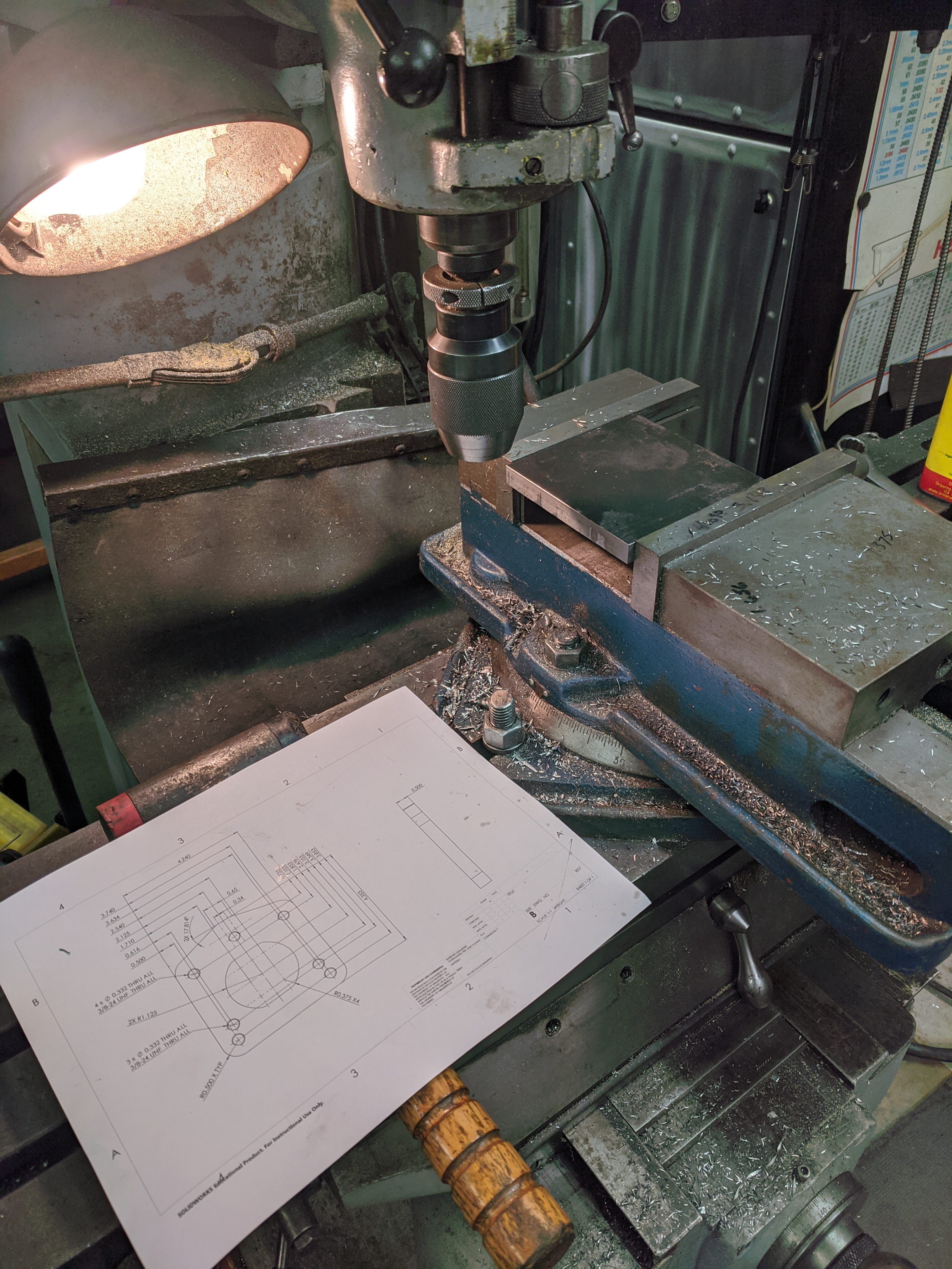

I went to a co drag weekend-ers shop and milled the plate out today. Not only did I get to use his mill, he gave me a beer and all I had to do in return was help him lift on and off a hood a couple times. Couldn't ask for better people.
I need to do some cleanup work with my die grinder and then I'll test bolt the turbo on and see if my stock intercooler fits or if I have to scope creep into a put in a front mount.
