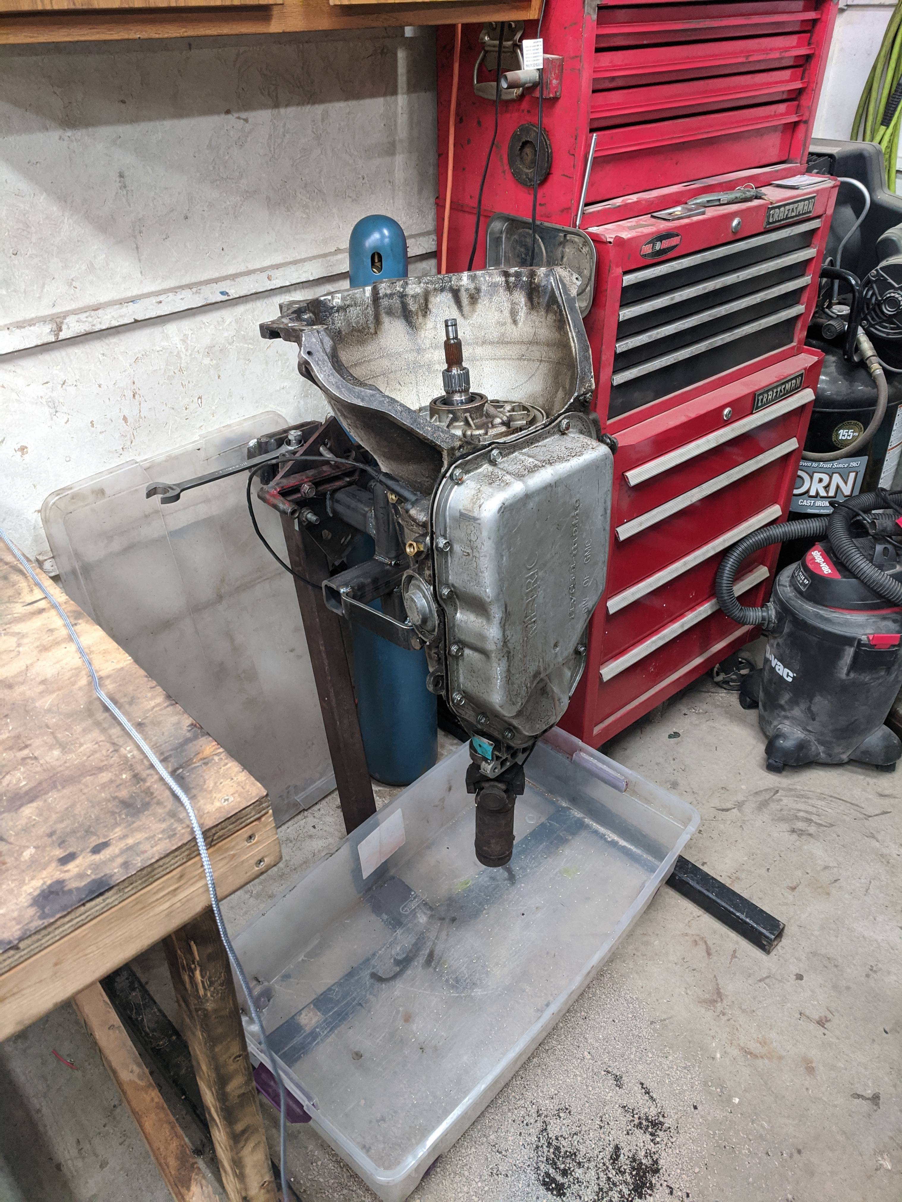

Freed up enough space to get my 200r4 on the stand and start the rebuild. I have been spending lunch going through tech articles for rebuilding the trans and decided what parts I need.
Going with the ~$950 CK performance kit. It's all the clutches and steels, bearings, performance pump, shift kit, big servo and upgraded (Hobbed, not spline rolled) forward drum shaft. Maybe a little overkill for what I'm doing but I'm 90% sure if I called him that's what he'd recommend and it shouldn't have a problem with the 400-450hp the 4.1 should make.
I could probably get away with just putting a hardened stator, high pressure spool valve and spring and a 10 vane pump in my pump I have but the CK pump is like the same price as all the parts separate and it's semi warrantied since I'm buying his kit.
Might also get away without the big arse billet servo and Hobbed front drum shaft but again, it's a few $100 savings total increase and I'm sure the boost will get turned up so it's not a wild increase.

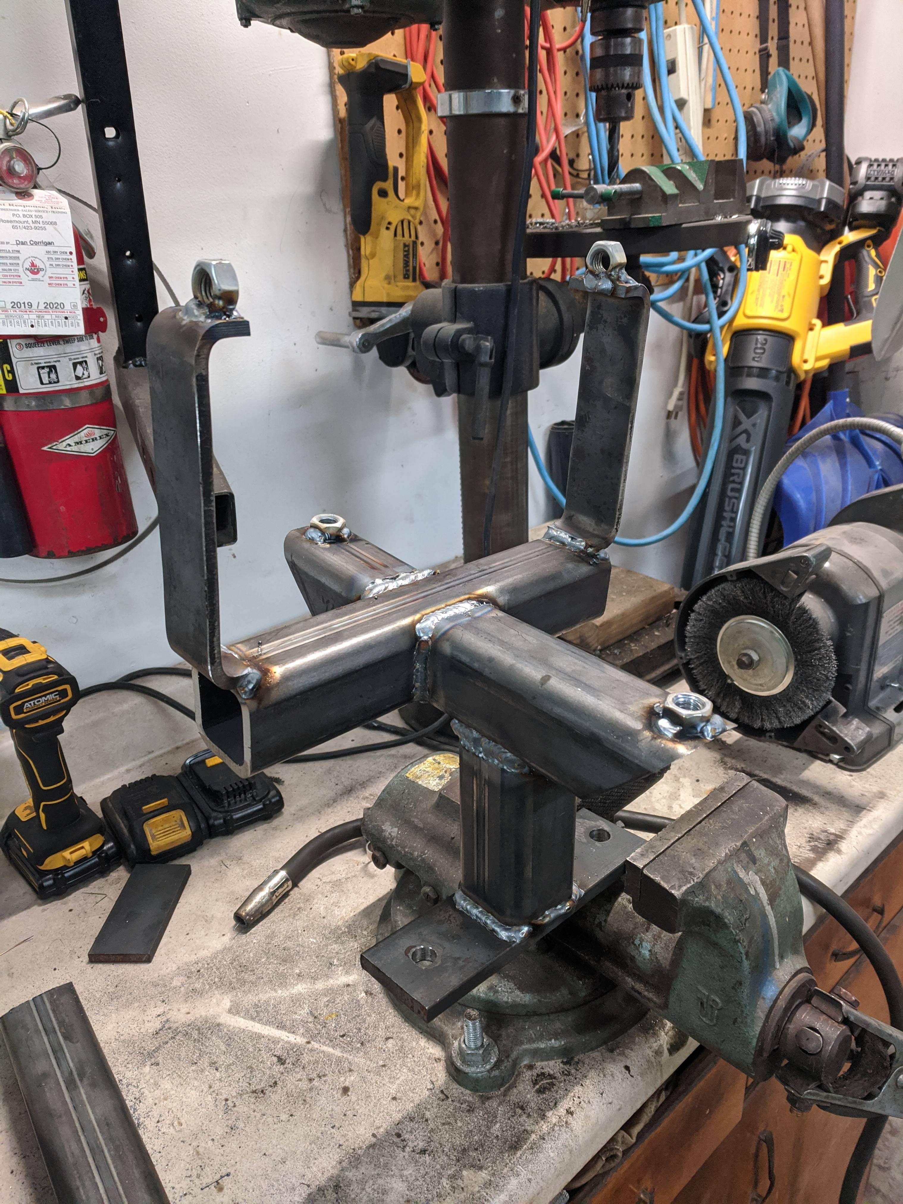

Welded up a trans fixture to install on my engine stand and got it mounted. Some M12 bolts, 2" tube, flat bar and left over scrap and bam! Rebuilding stand!

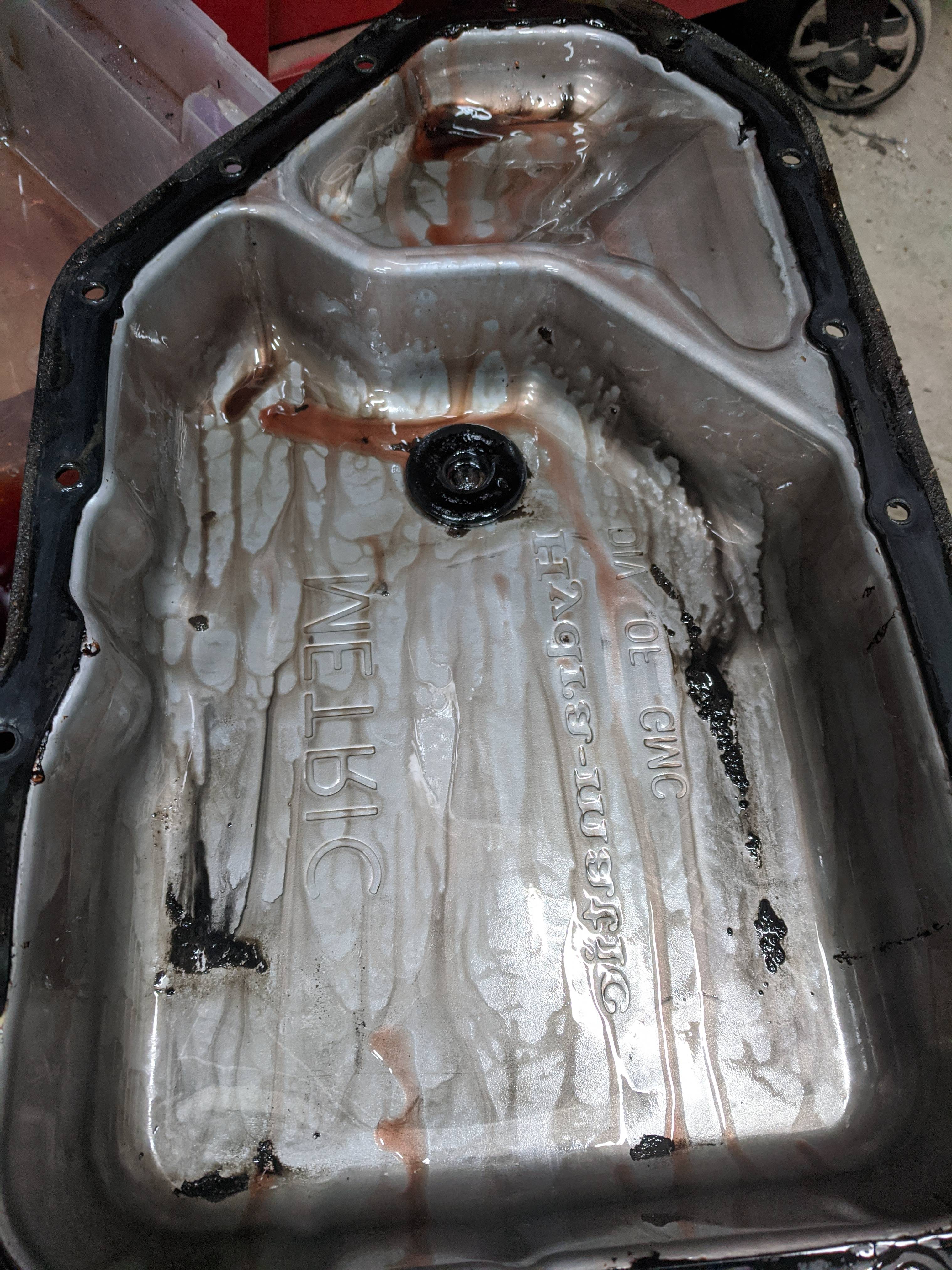

As expected there was some clutch material sitting in the pan. The trans would not shift under full boost with the turbo 4.1 making about 12 psi but it's an un-rebuilt unit out of my 2+2 that's not a performance unit with probably 70k miles on it. All I did was put a larger MCSS servo in, shimmed the pin length, and cut the governor down to GN spec.

That's some good work on the fixture. This is lining up to be a great project.
