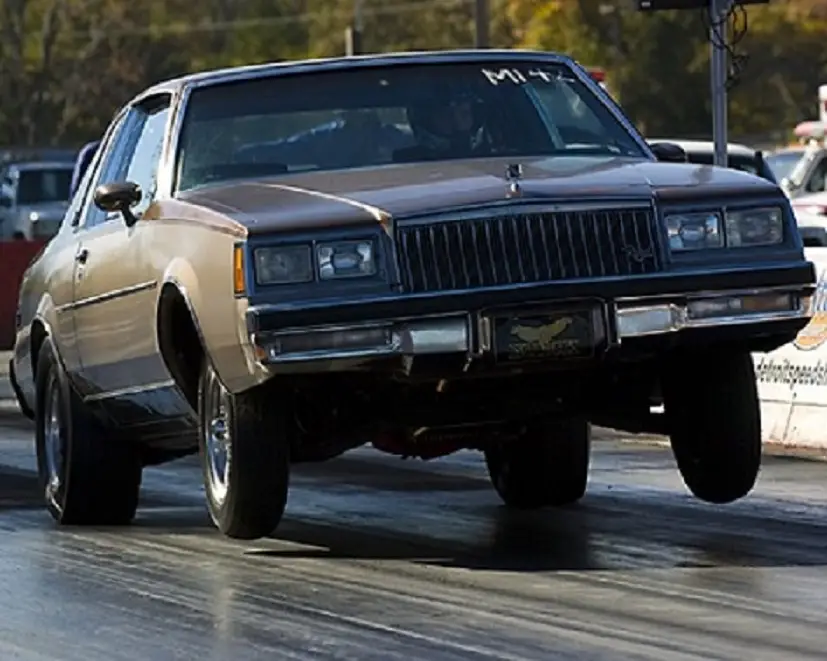

So you want one of these -
That does this -
Get your check book out !!!

So you want one of these -View attachment 94257
That does this -
