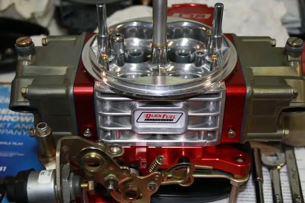

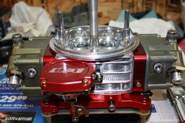

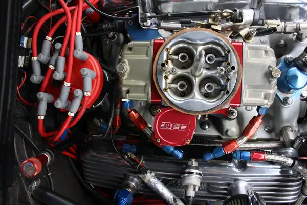

Greetings Ham & all; My $.02 cents worth. Holley style carbs are easer to tune & more prone to leaking from little use. Q Jets are much more complex to tune due to the piston spring needing to be in tune with the cam then it's on to rods with steps poking into the all four jets, pain in the posterior. And because of the single float bowl are much more sensitive to fuel volume. If you're after part & light throttle metering ya can't beat a Q Jet. If ya want easy to tune & great equal flow to all cylinders a Holley style is your only choice! As for size GM put a 780 CFM vacuum Holley on a Dz 302 Z-28 & a very similar 780 on the L78 375-396, L72 425-427 & the mighty Ls6 450-454. All solid lifter engines, sure the 302 & L78 would rev 7000 right off the show room floor & the two larger ones would push 6500. The key word here is VACUUM secondaries, easily tuned with a spring kit. The only way I would consider a mechanical secondary style Holley is if the car was under 3300 Lbs, had 3.70 or tighter rear gears, this is where TOO Big will Bite you very quickly. I'll post a picture of my solution, it works Very well indeed. Ole' Bob.
Ps: Something like this would work on both engines & you would only spend money once. Plus you would only have to plumb it once.
