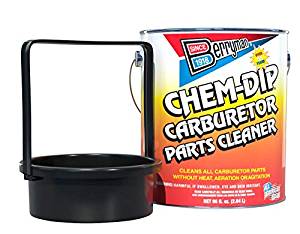

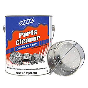

Berrymans is good as is Gunk and the dip basket is a nice thing. Too bad a Q-jet body won't fit. The small parts fit and won't get lost. You can do as I do and use a big enough vessel to hold a dissassembled carb. Then keep the cleaner in another container like a steel bucket. I still feel they are weak but are good for a final cleaning after the #2 oil has dissolved the heavy junk. It is hard to find but Permatex Heavy Duty carb and Choke Cleaner in the gallon can is hands down the best. Stinks to holy hell but the parts come out like new. View attachment 128948 View attachment 128950
Ive used the berrymans and have a couple gallon here in the garage. Good stuff
