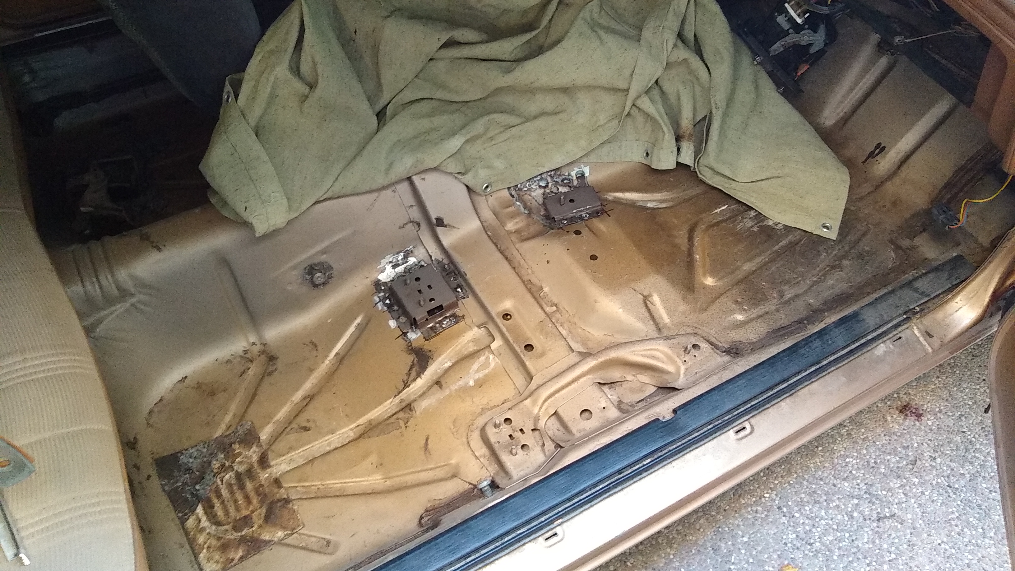

For others that have bench seats & considering a swap, there are aftermarket G-body specific brackets available for buckets & 60/40 seats (Google g-body bucket seat mounts). As for possible donors, here in TX, I find S10 blazer seats are the most common find in wrecking yards. I have a clean pair sitting in my shop now that I picked-up on C-list a couple years ago for $125.
The brackets are spot welded in place from the factory. For someone w/o a welder, after removing all the carpet & padding you could mock up their placement & have a local muffler shop tack them in for a few bucks. I did 2 bucket seat swaps using brackets from wrecking yard cars (Regal T-type/Monte Carlo SS) before the aftermarket ones were available. I'll likely do yet another but will utilize the aftermarket brackets this time & look forward to not having to pry them off the floor w/o worrying about damaging them in the removal process.

If you have a car that has a 1 piece bench seat, you will need the inner floor mounts, which will allow you to use bucket seat tracks. As for seat selection, most GM bucket seats that were produced from the late '70s to the early 2000s will bolt directly to the correct G body bucket seat tracks. When I upgraded the interior in my '84 Monte SS, I tried Buick GN seats-direct bolt in. I tried late '80s Firebird seats-direct bolt in. I tried early 2000s Cavalier/Sunfire seats-direct bolt in. I finally ended up using seats from a '96-'98 Pontiac Grand Am GT, and they were also a direct bolt in. I've seen plenty of aftermarket seats in these cars, but they usually require an adapter bracket that will allow you to bolt the aftermarket seat to the G body seat track. You can fabricate a similiar type bracket, which will allow you to use seats from other vehicles. I had a local welding shop fab up a pair of adapter brackets, so that I could mount a pair of 1988 Toyota Celica GTS bucket seats in my 1980 Malibu. There are lots of different ways that you can go.

As stated, you will need the inner brackets, which should be welded in.

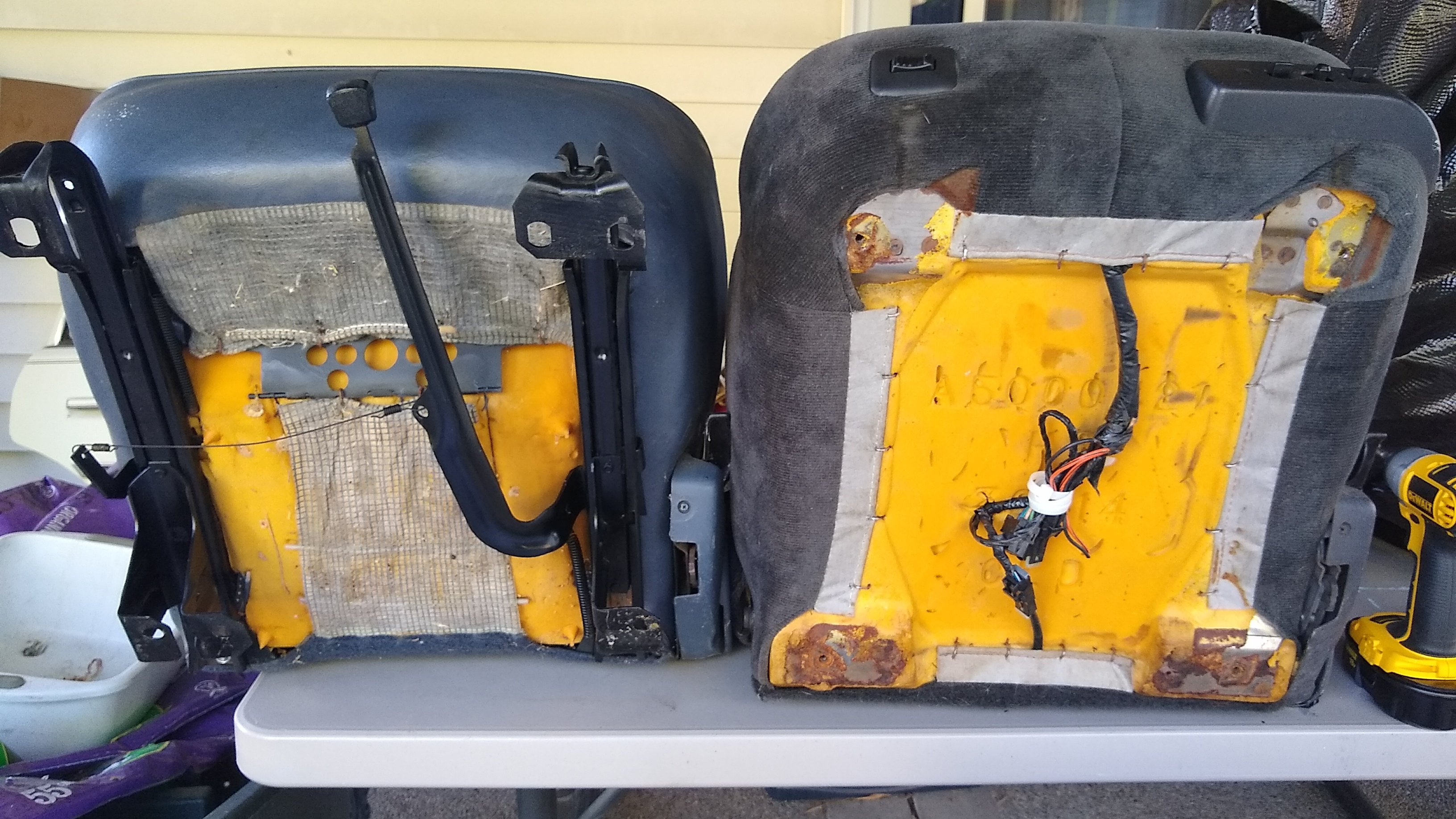

S10 Blazer is a good candidate. Since you have no back seat, you don't have to match the upholstery.
The inner tracks' mount pads are available aftermarket (OPGI, etc.).

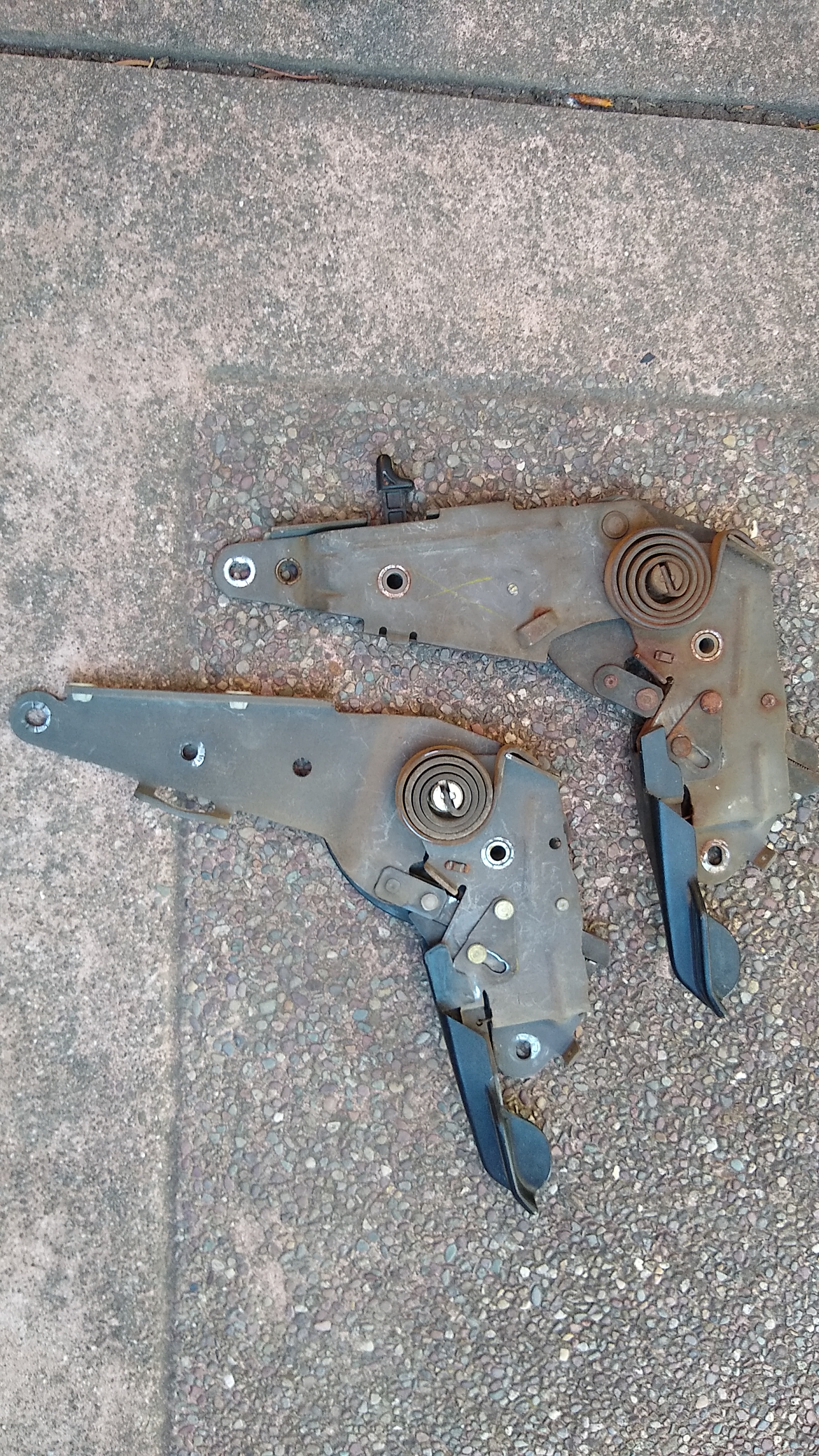

The S10 seats use the identical four-bolt pattern, but the tracks themselves are unique to the S10 floorpan. You'll need the inner pair. Not sure if a second set of bench tracks can be used. There was a good post on this.

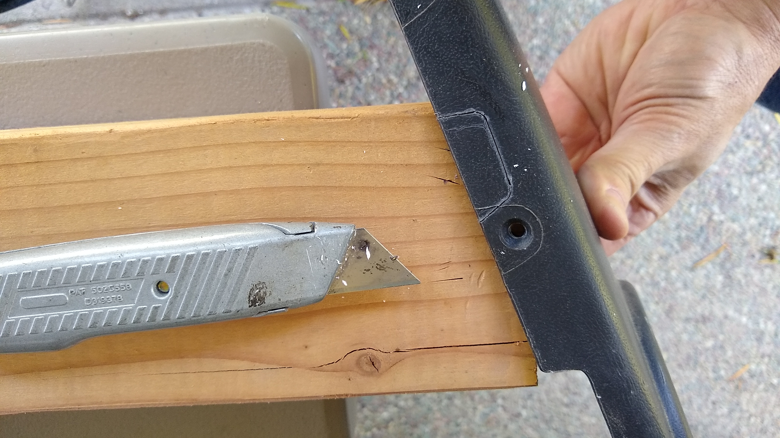

My Blazer seats were non-flip, as there were dedicated doors for the rear seat. The tilt mechanisms have an extra feature...look for a 2-door Blazer. I just cut out the beauty covers for the flip levers.
