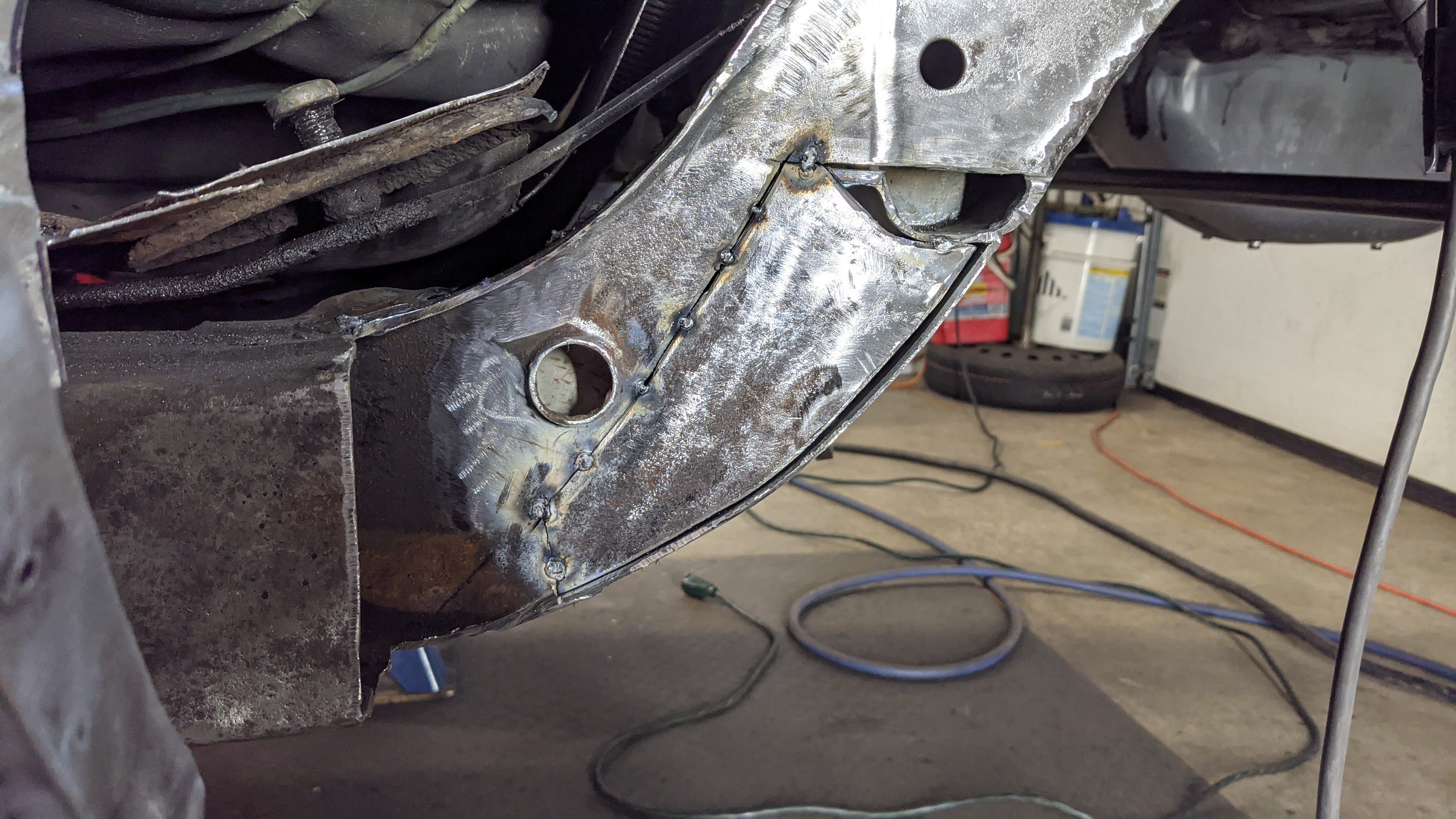

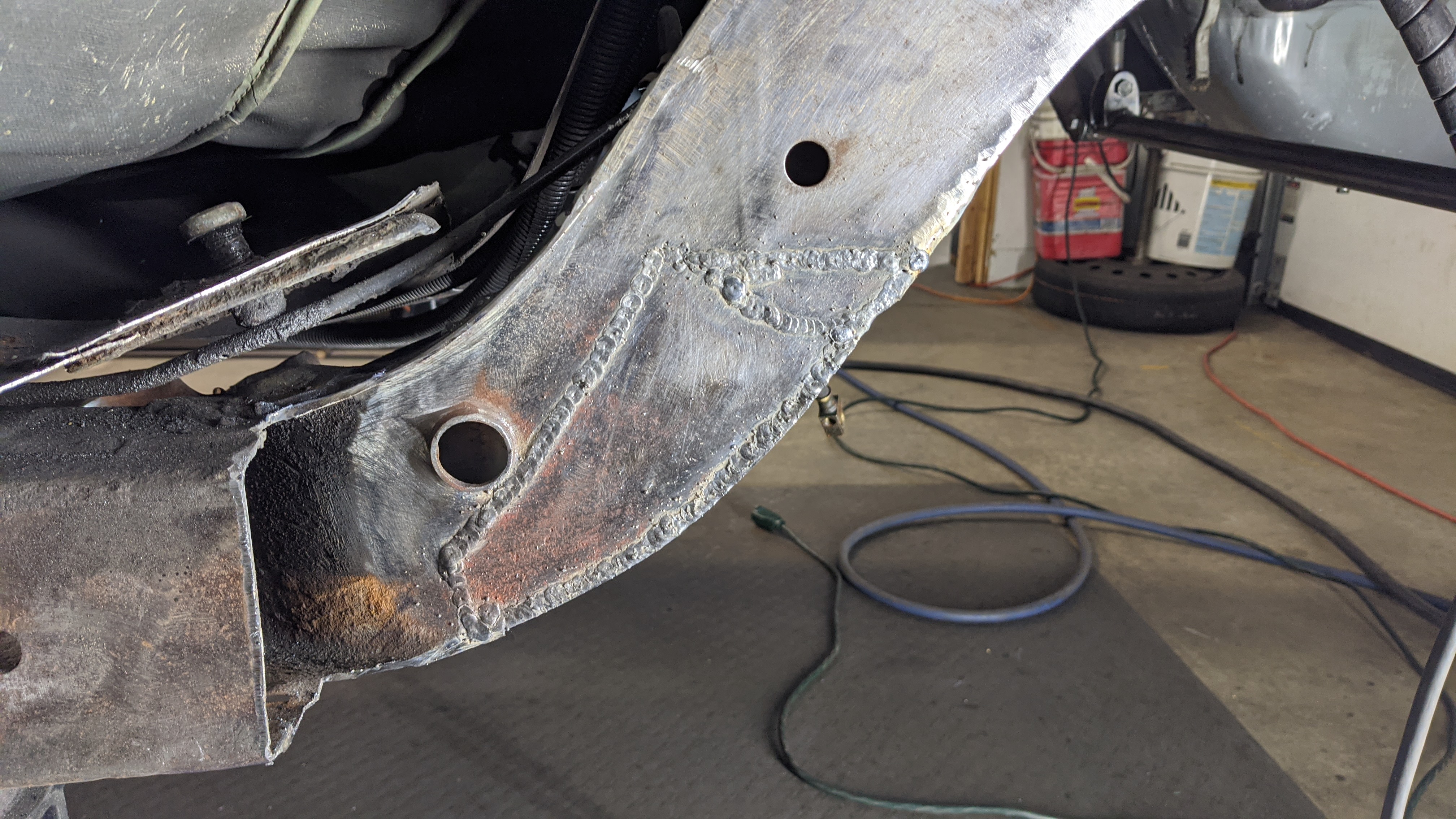

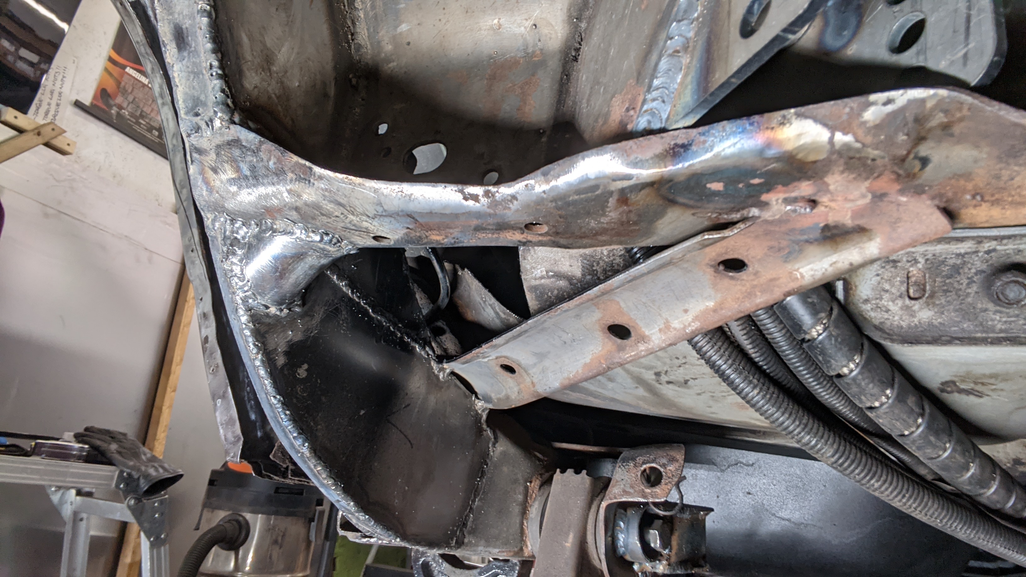

Well this monkey is officially off my back.
Couple of process pics.
I end up in the zone and often forget to pause to capture the moment. Also time is money.
To help compensate for the narrowed rails I added a couple of gussets.
Will it make a difference? I dunno. But, I feel better having had done it. Options were limited due to the space between the rail and LCA. If I really get concerned I can always splice in a section of the stock rails I cut out and bulk up that area between the torque box and control arm. Something something aftermarket parts would solve that now...
64nailhead, I rather run more tubing under the car than in the car. There is nothing stopping me from going full-retard on this car other than the limitations I am imposing on myself. Maybe it'll get the full treatment once the girls aren't riding in the backseat.
