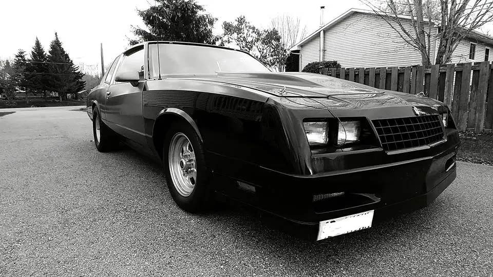

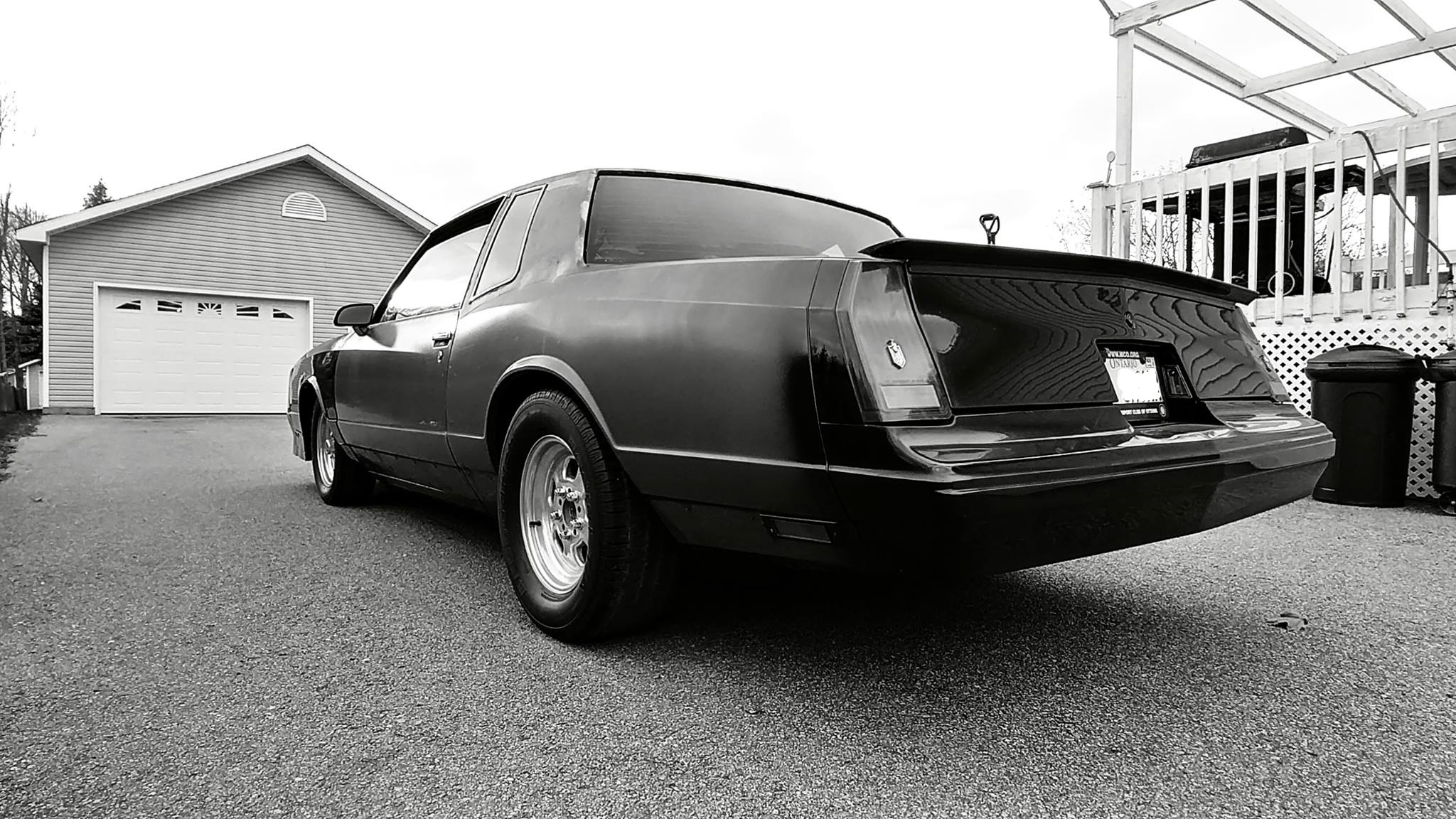

OOOOOOOOHHHHH! I understand now why this is a throwback to your highschool car. Its a body swap for the front/rear clips lol.
The parting out of the other car, and the metal work in the trunk had me confused but i see the vision now. Nice work.
Yeah, more or less. Truthfully there is only so much that is original about a car that has been worked over as a much mine have. After a while it stops being "that original thing" so much as a "concept" or "idea" of itself and what it has become. This is the premise behind Theseus's paradox: https://en.wikipedia.org/wiki/Ship_of_Theseus
This is what makes truly hot rodding something so fascinating.

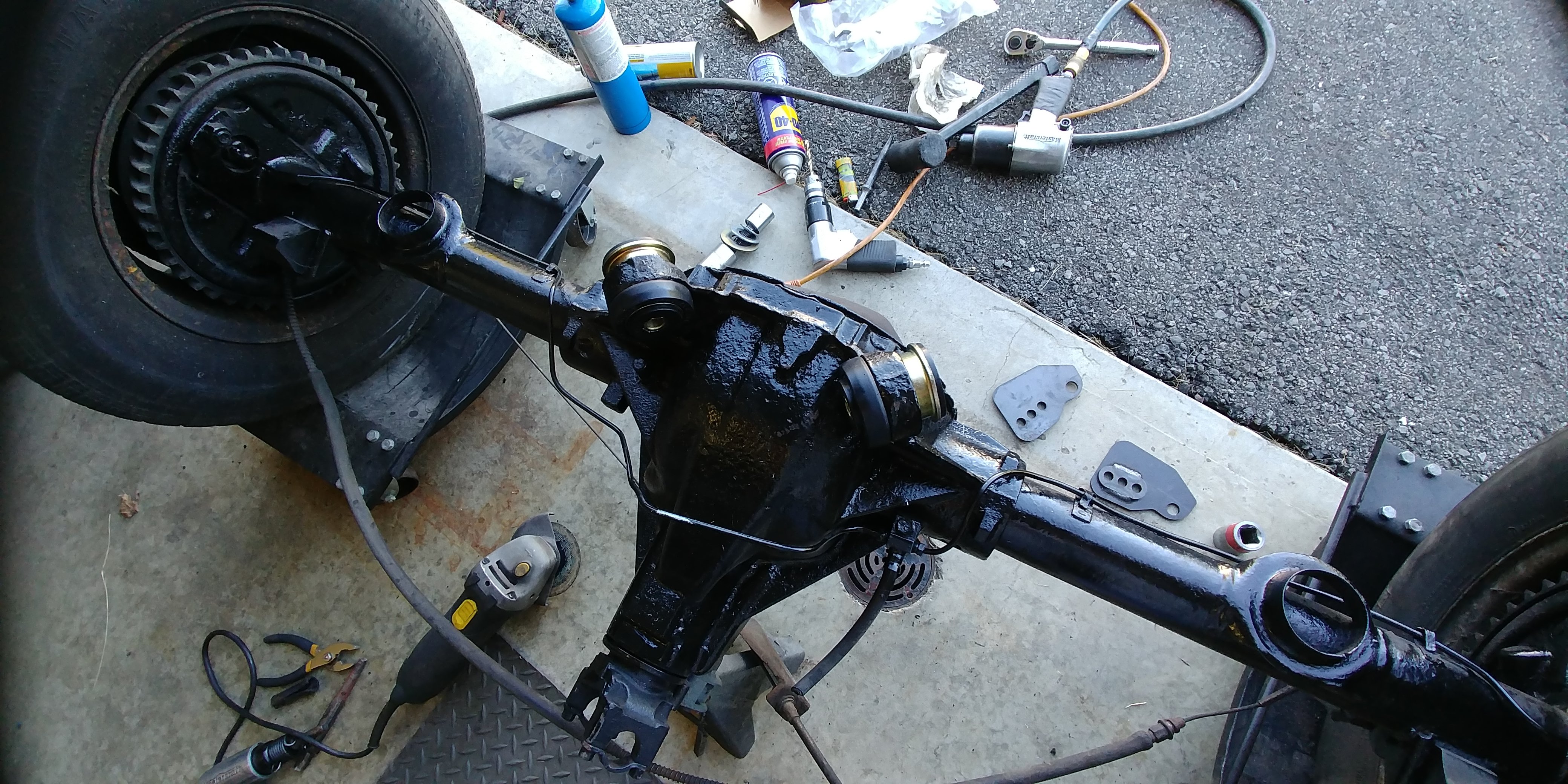

Decided I need to get moving on this car a bit to clear some space around the house before the snow flies. I need to do a couple of things to the 8.5" before it takes up residence in this car: change the bushings, and weld in the UMI LCA relocation brackets.
I decided to hit it with my purse a few times and show those bushings who's boss.
Fine job. Looks great.
