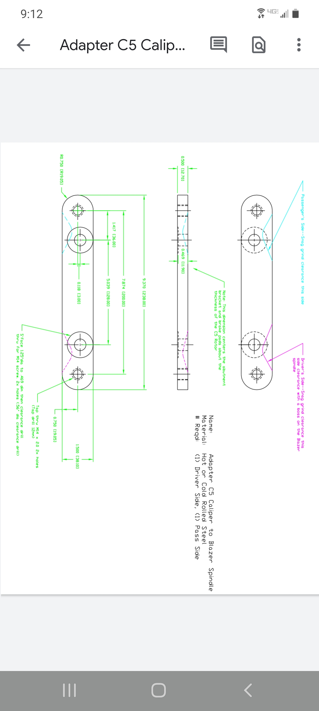

Here is one I found a couple of years ago. I have NOT verified fitment with Blazer spindles.View attachment 165585
Little late on the response thanks for the info. Im am still am way from actually needing brakes, but Im getting pretty close. Finished the front suspension this morning. Steering is complete minus the steering shaft between the column and box. Once I get that squared away Ill be moving on to my braking system.
