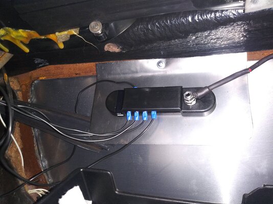

I grounded gauge to dash support and tank to the frame. Red/pink went to gauge sender screw. I have a grounding block under das i have all my grounds to for gauges. Keeps neat.

my wire was aluminum and pink. WTF? Instructions for my fuel gage said not to ground to instrument ground, but instead go back to the tank. I grounded to the cluster ground and it worked fine like you mentioned.
