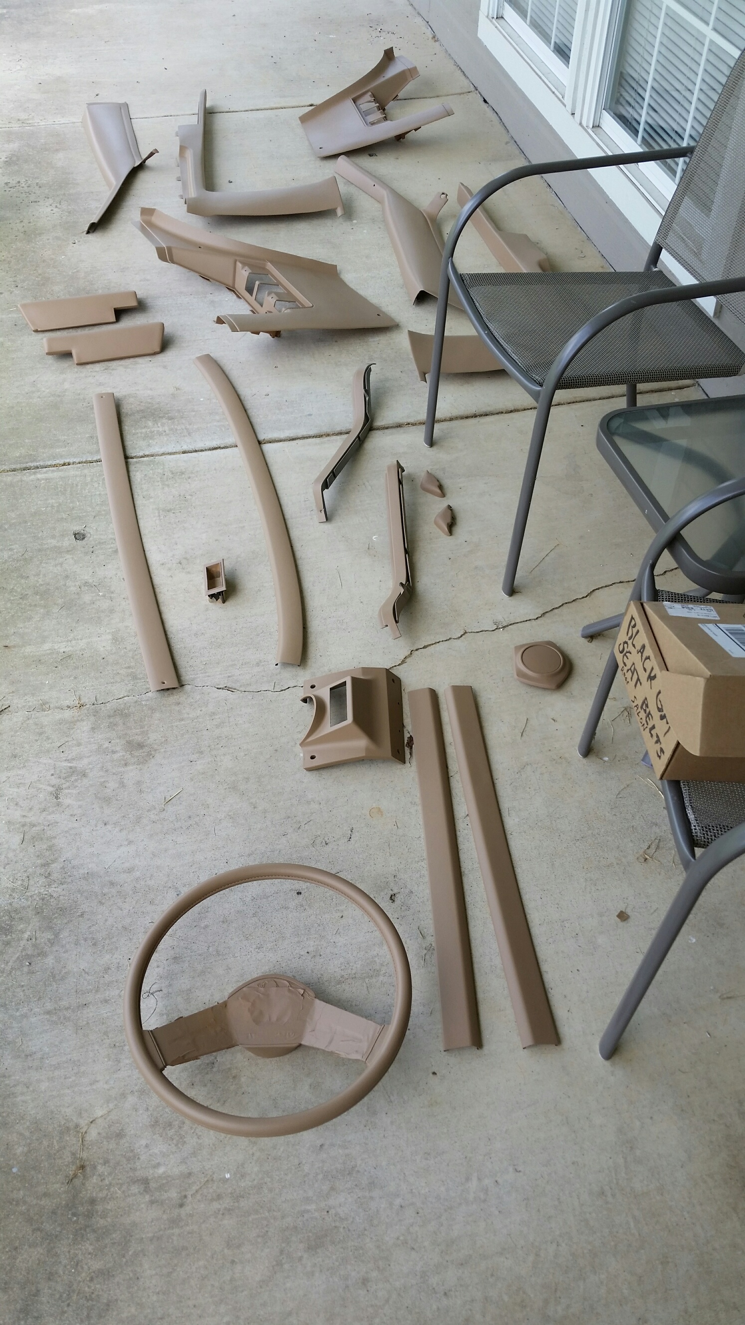

Today I scotch brited all my interior pieces and cleaned them with Sem Solve twice on a microfiber towel. Those towels seem to pull all the grime out of the grain. I had already washed them with Dawn dish soap a few months ago. I have interior pieces from MANY different cars and they were all the different interior colors that were available through the years :rofl: I tack ragged them and shot them with some of my custom mixed gallon of interior paint. I'm not going to do the lower door panels today. I will need to build upper door panels first. This way the lowers won't get scratched by being set somewhere for who knows how long. Tomorrow I plan on installing all the other trim parts, rear seat belts, and back seat. I'm getting ready to spray the steering wheel but need to get it off the car first.
