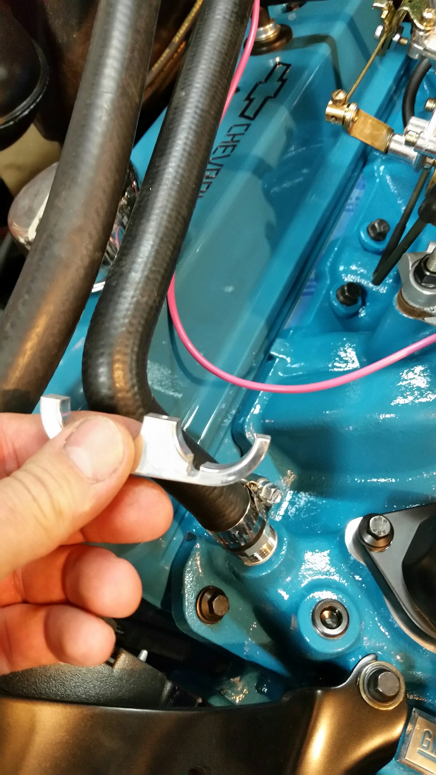

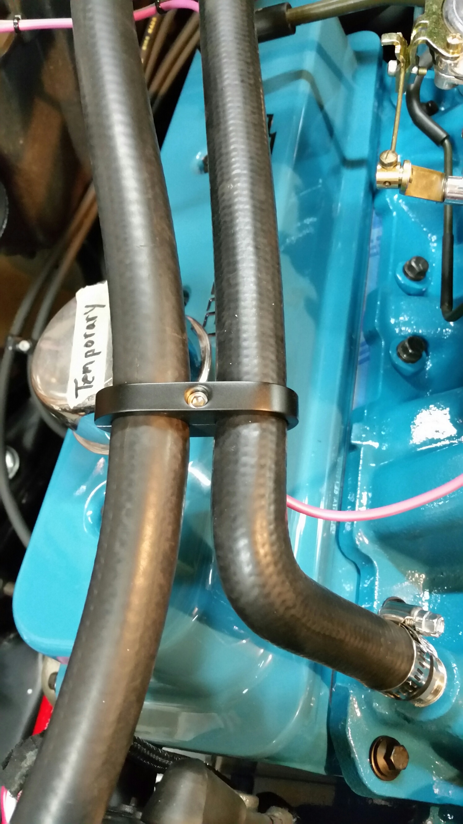

I just went back out to try one of the hose separator ideas I had. I drilled a hole the same size as the purple hose and finalized the sides with a small file. I scotch brited the two pieces and painted it flat black. Now the purple hose runs underneath the heater hose. A bit cleaner than the temporary zip ties. Now I have to do one more.
View attachment 68026 View attachment 68027
Do you have a part number for that separator or do you know the 2 sizes on it
I can't find a 3/4 5/8 one.
I had to use a digital caliper cause Summit has it in MM if I remember right. It is 3/4 and 5/8
