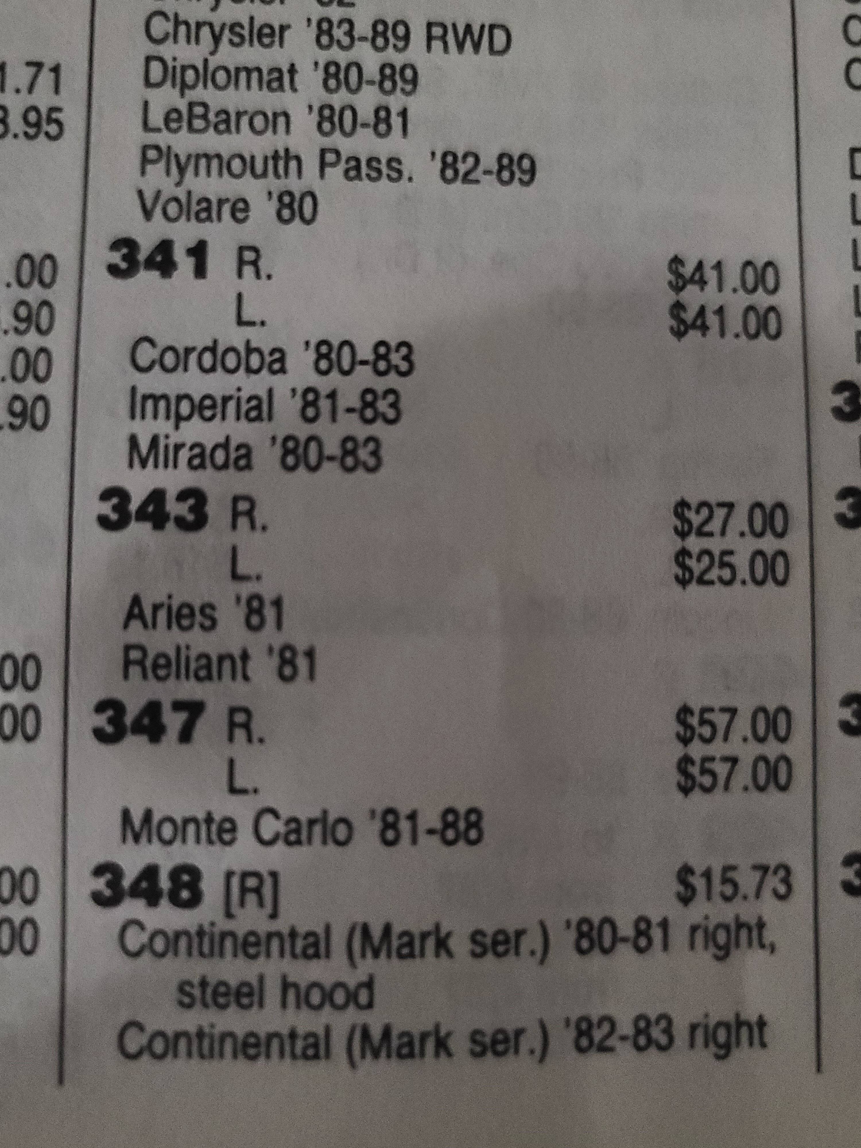

FWIW, and I hate to complicate things further, there appear to be at least 3 types of hood hinge.
The 317 style which covers many gbodies, then there's these:
So, at a minimum both grand prix and monte carlo have unique body-specific hinges, both being sprung type, not shock type supports.
