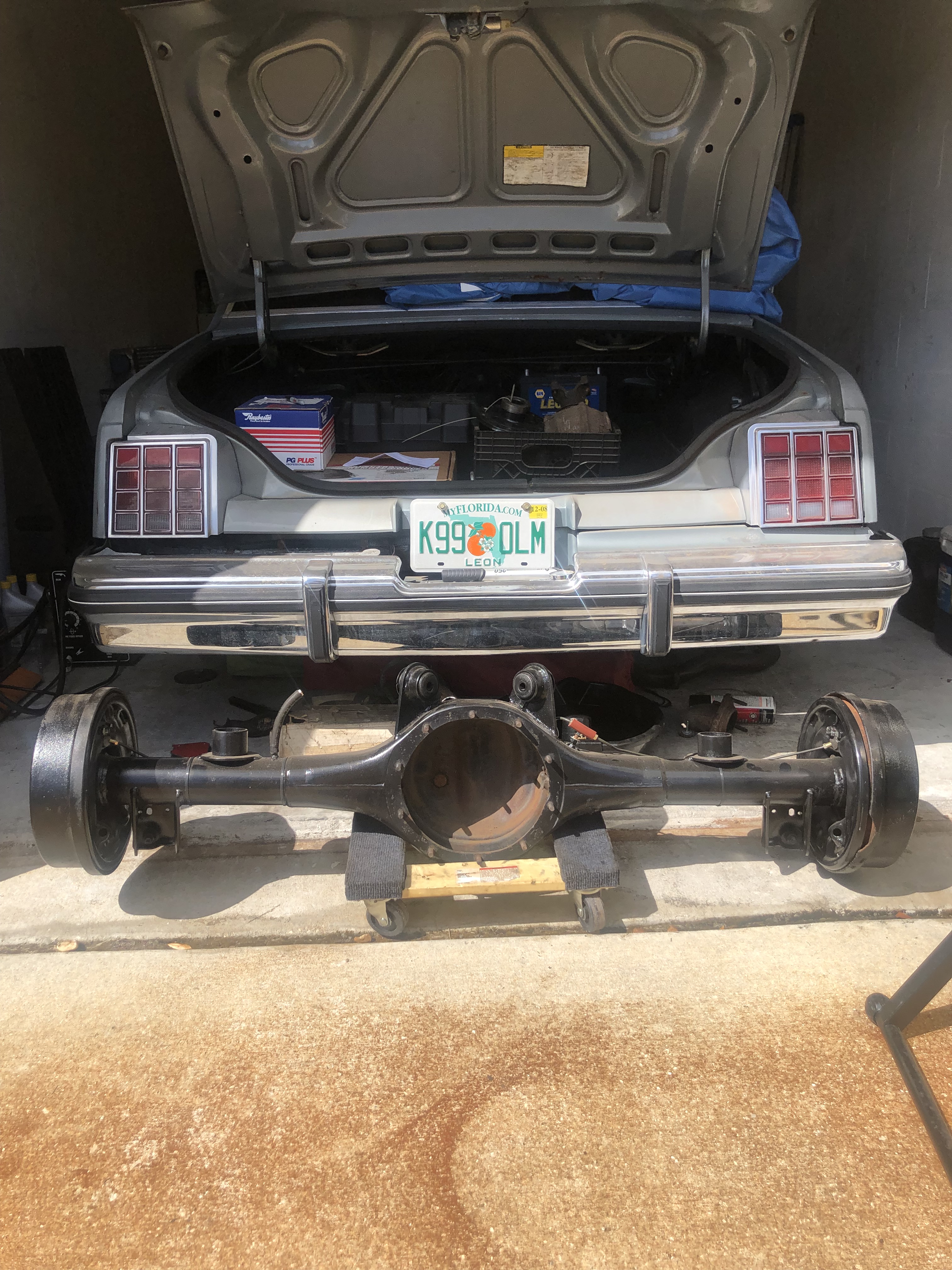

This was a good read from the beginning, thought I share...back in the day ~1999, my working place had it's own network classified ads which came up on the screen looking like a DOS screen. G-body drum to drum Currie 9" posi 3.90 w racing axles $600. That was a steal even for back then. I was sporting the stock 7.5 3.73s and thought 3.90s would be a bit much for a daily street car with no OD. I passed on it and perhaps 10 years later I met this person who put the ad up, he told me "Oh yeah I sold it cheap, if I knew you were into g-bodies I would've given it to you!!!"
Probably in the mid 80s I was given a 68-72 Chevelle 12-bolt w 2.56 peg leg for a measely $60. Never did anything with it except for purchasing the control arm kit to install it.
I don't even remember when I acquired the 442 8.5 rearend but that quickly got bolted up under the '87 Monte stock LG4 got into a wreck, parked it and never messed with that car since. Just to let you know, I wasn't driving. Some lady plowed into it in the parking lot!!!
Knowing I had a control arm kit for a 68-72 Chevelle 12-bolt, stumbled across a 12-bolt on CL that I couldn't pass up. Drum to drum welded axles, Moroso brute strength, 4.56 gears, Moser racing axles, c-clip eliminators and an aluminum girdle cover zero miles $700. The spring perch still needs to be relocated should I decide to put it into one of my current rides but I was also thinking this rear might be more suited with a T56 with a .50 OD so that's another project in itself.
As you can see, maybe 2 of these may have survived behind some serious horsepower but the other 2 would definitely need some upgrade$.
