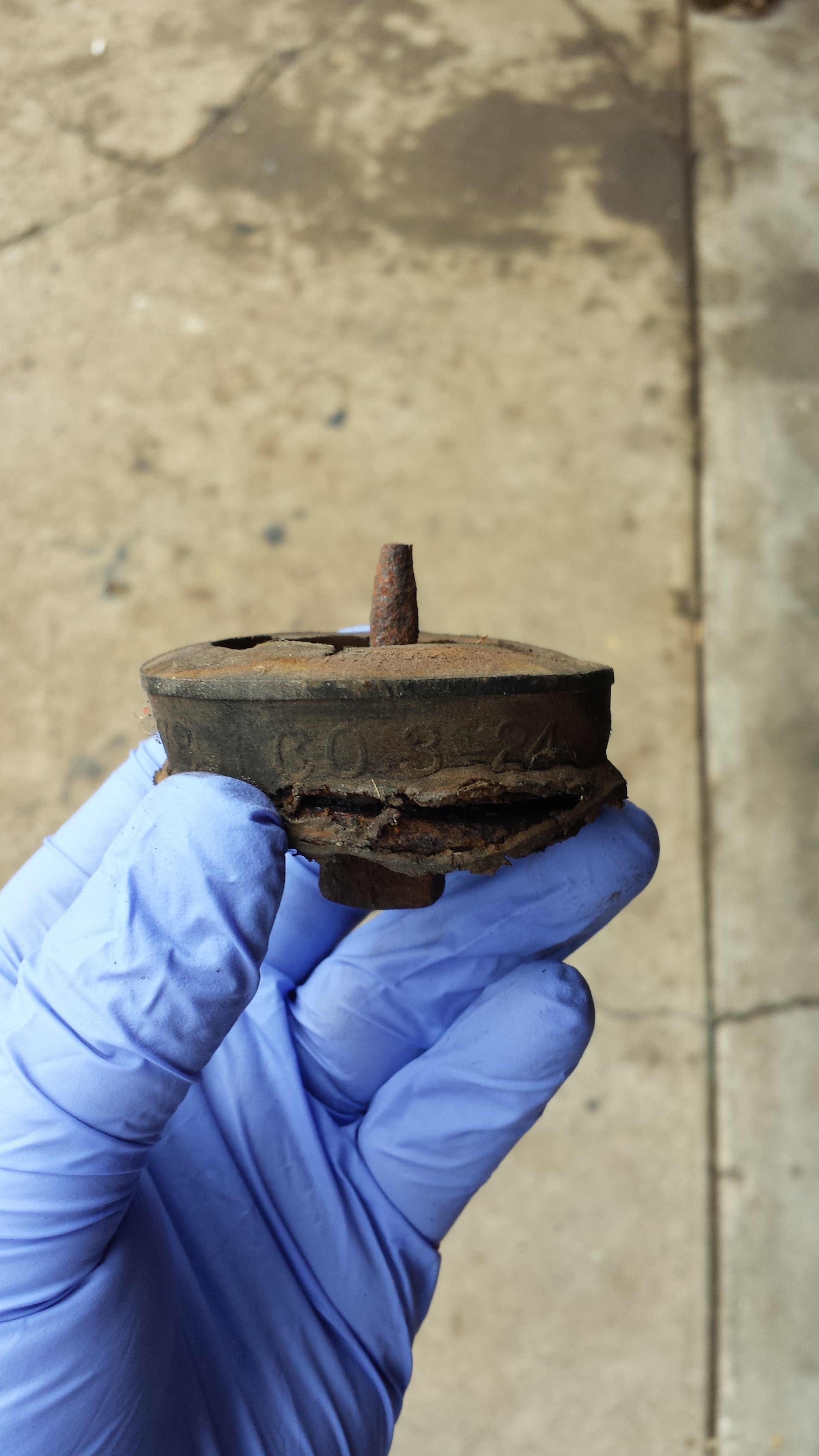

Oh the memories lol! This is one i pulled from the trunk area of my cutlass. All 4 broke and the top halves had to be removed after cutting holes. The norm for most of our cars.View attachment 65664
