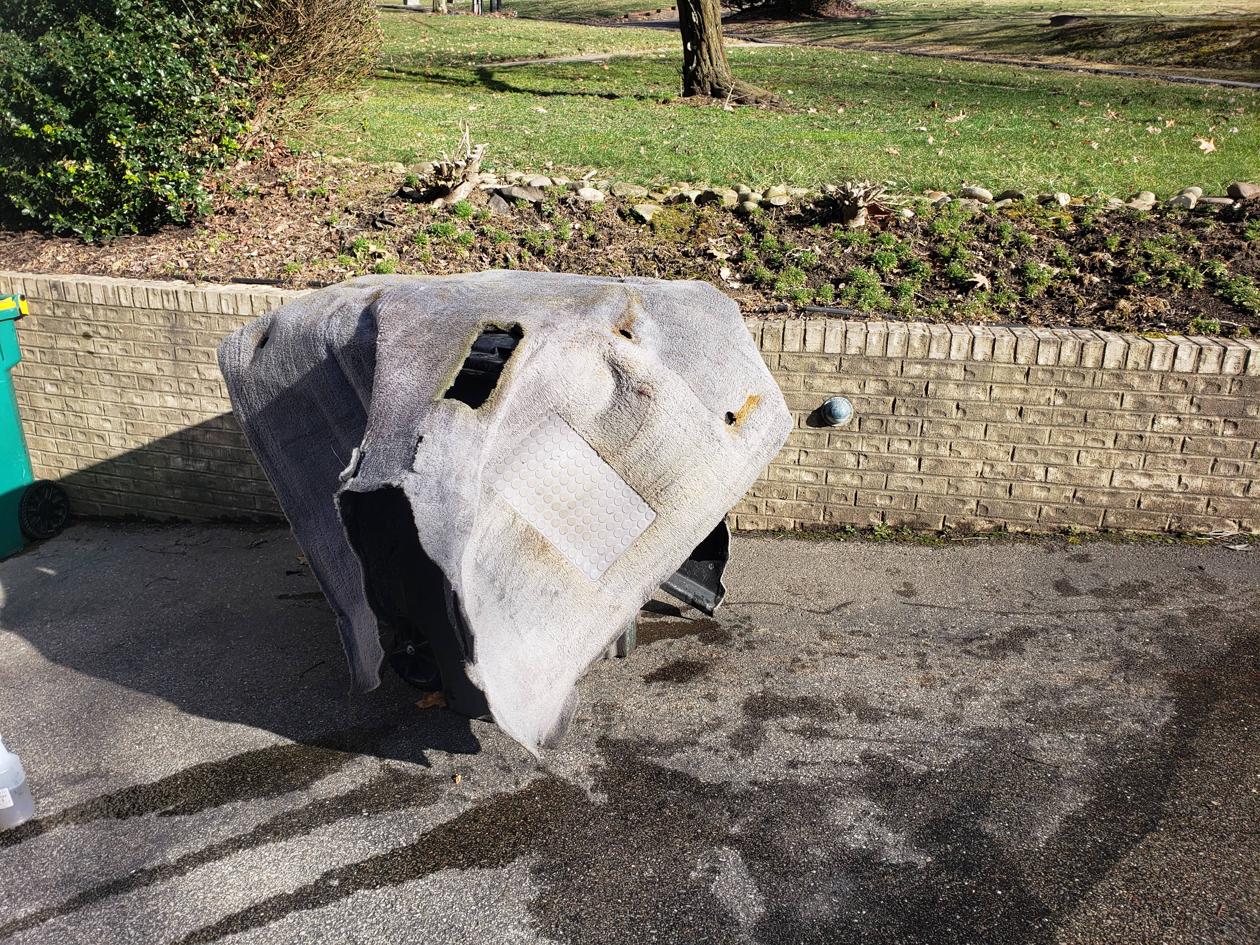

I took out the Zebra's carpet and towed the flatbed trailer to the car wash. Cleaned the trailer first, rolled out the carpet, then wetted it down thoroughly and sprayed the worst spots with a 50/50 of laundry soap and water and let it soak while I got breakfast across the street. Came back later and used the power brush to scrub the darker spots, then multiple passes with the rinse cycle. I tied it down and let it air dry in the sun. Had to prop up the spots with jute backing, but all but the darkest spots were gone. About 14 bucks with breakfast!

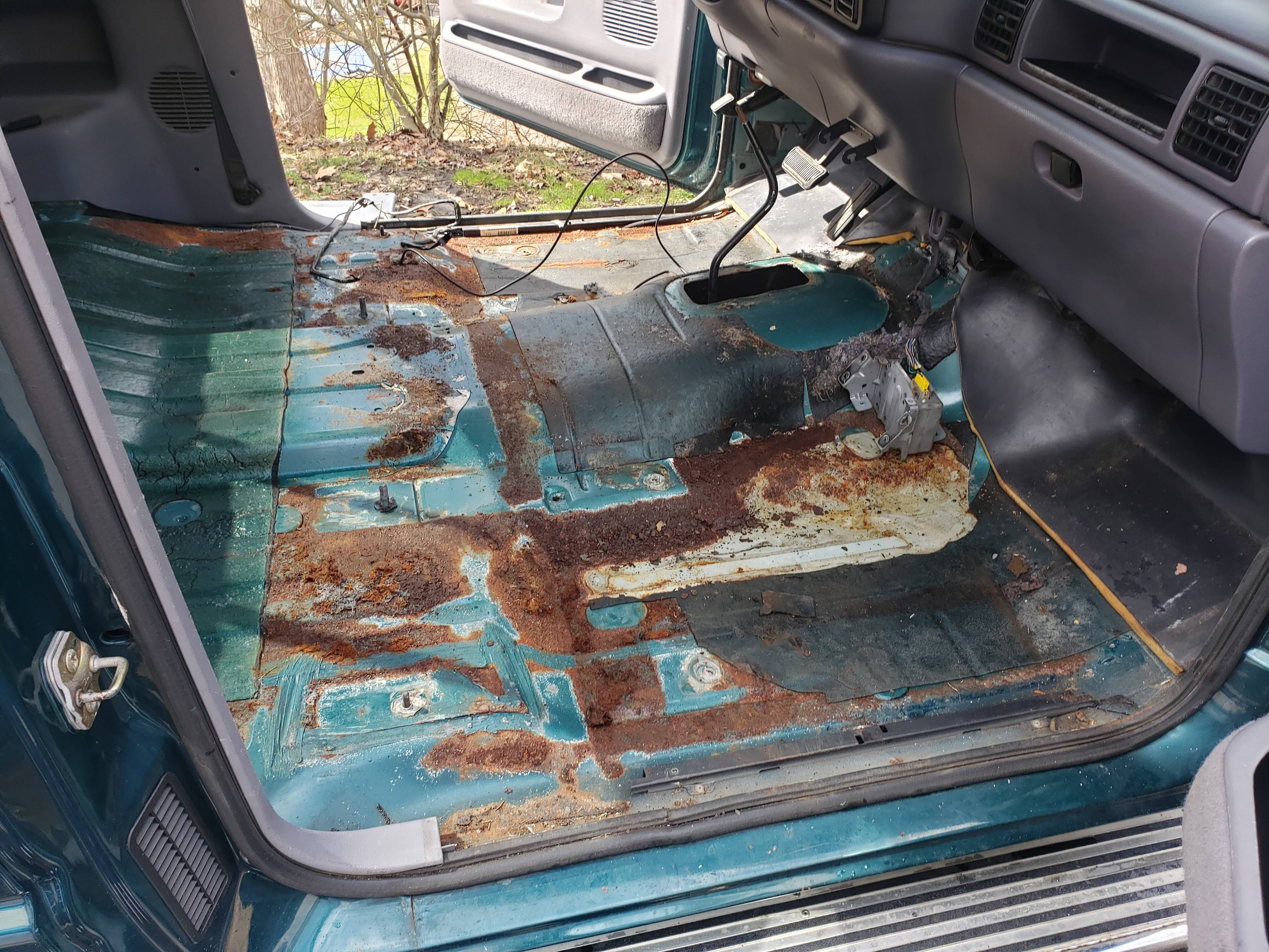

Well I simply can't stand still. I got the carpet pulled. It was actually very easy, only took maybe a half hour. Didn't break anything either.

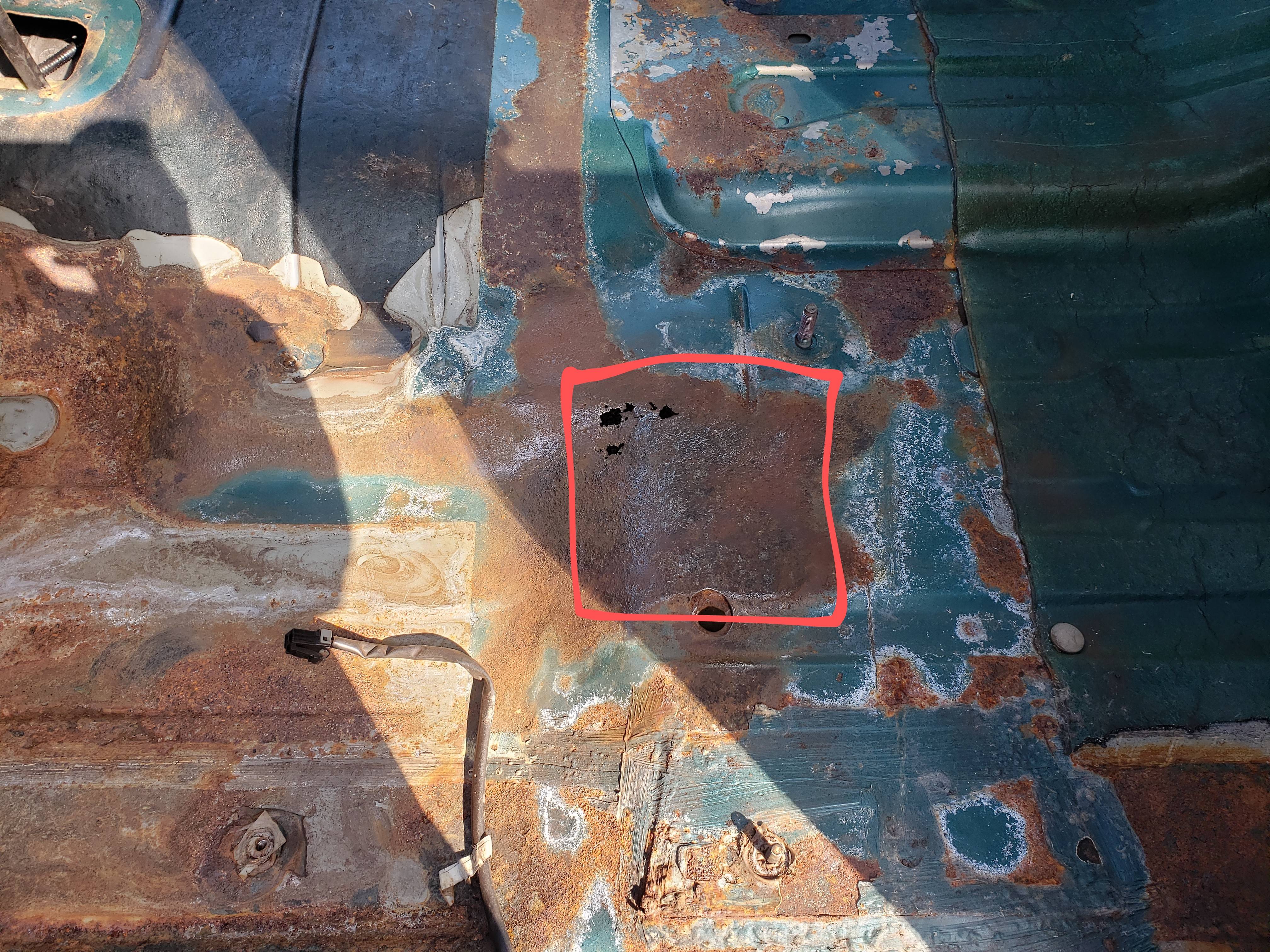

The floor was a little ugly underneath. Not awful but not as nice as I was hoping. This is all from moisture under the carpet. The underside of the truck looks spotless in this area. So I hammered on all of it with a body hammer and found a few holes. Nothing too scary. A couple small patches and some paint and it'll be fine.

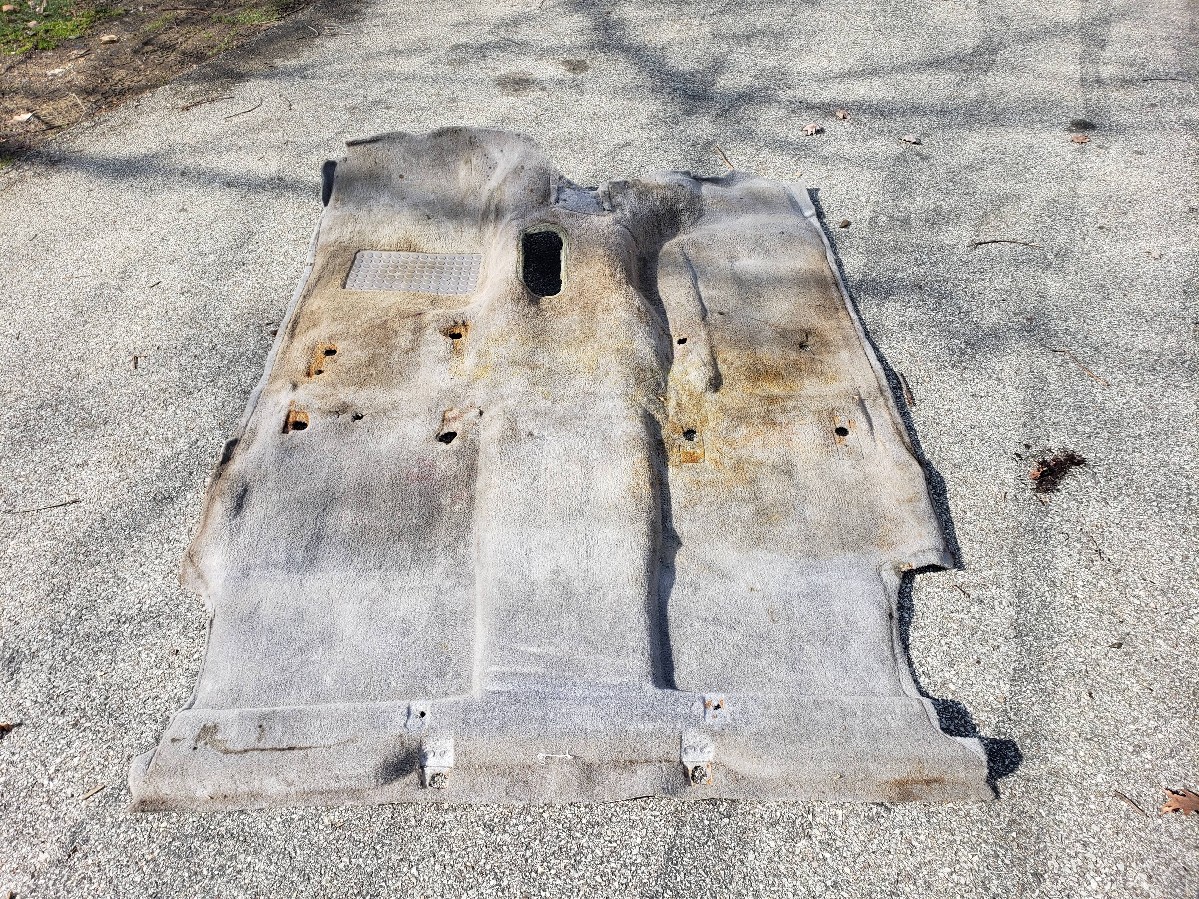

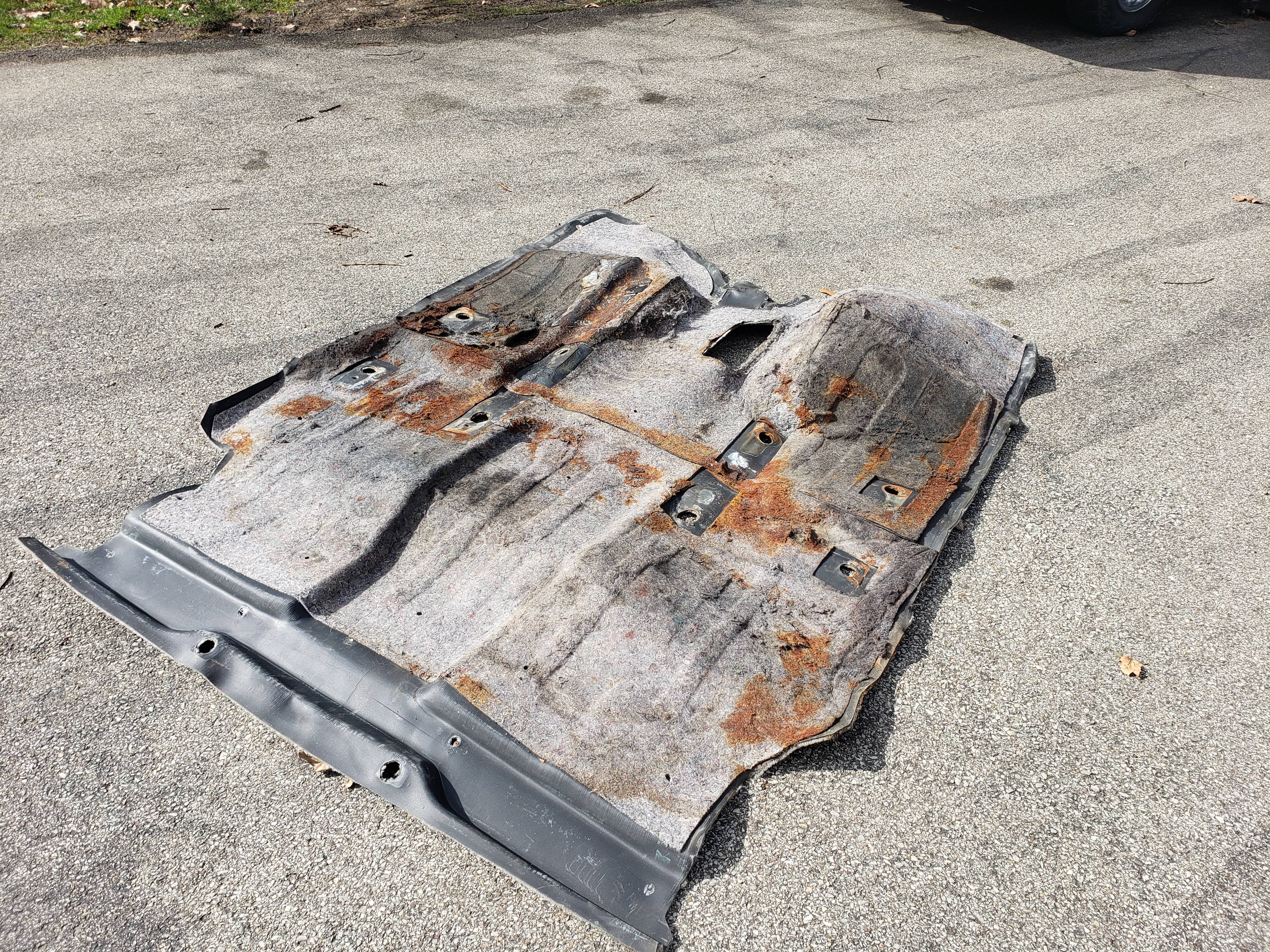

I got some laundry detergent and hot water and scrubbed the carpet again with the drill brush. Immediately I could see dirty water coming out. Then I hooked the pressure washer up to the hot water tap and pressure washed it. It looks a lot better but the stains behind the passenger seat are still there. Not nearly as dark but not gone. The fibers themselves might be stained. I'll see how it looks when it dries.
Before-
Hung up to dry-
View attachment 194683View attachment 194684
View attachment 194686View attachment 194687
Before-
Hung up to dry-
Still a night and day improvement. Maybe you could pick up a couple used weathertech type mats for cheap and cover the worst of it up?

Wow, is it taking on water somewhere?
I looked carefully, I don't see any obvious leaks. It appears to mostly be where the driver and passenger's feet would be. No puddles, just damp. I'll check it with a hose before I put the carpet back in.
Don't worry Jared, i know that rust might be totalled by Texas standards but this is what we consider light rust in PA 😁
It is much better than it was. The water running out of the carpet while I was pressure washing was blackish brown. Husky makes some floor liners that might work nicely.
