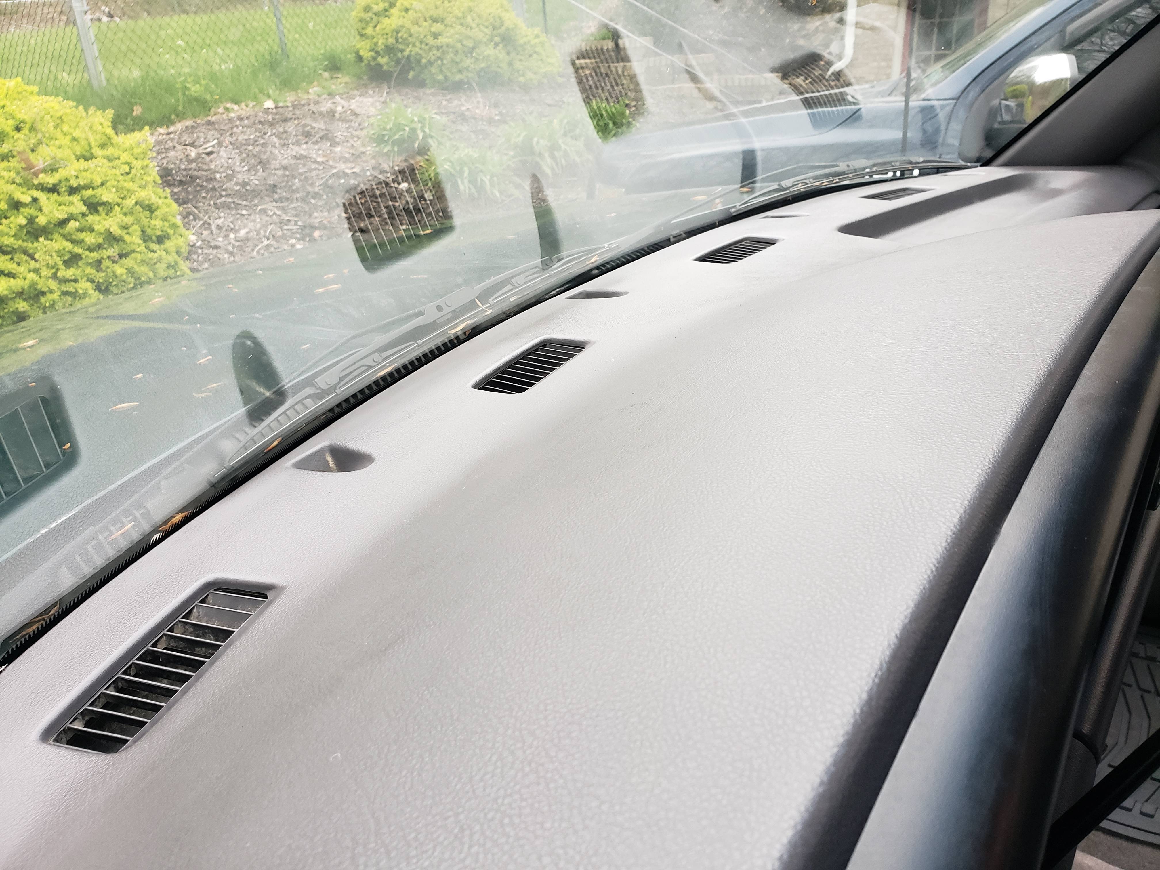

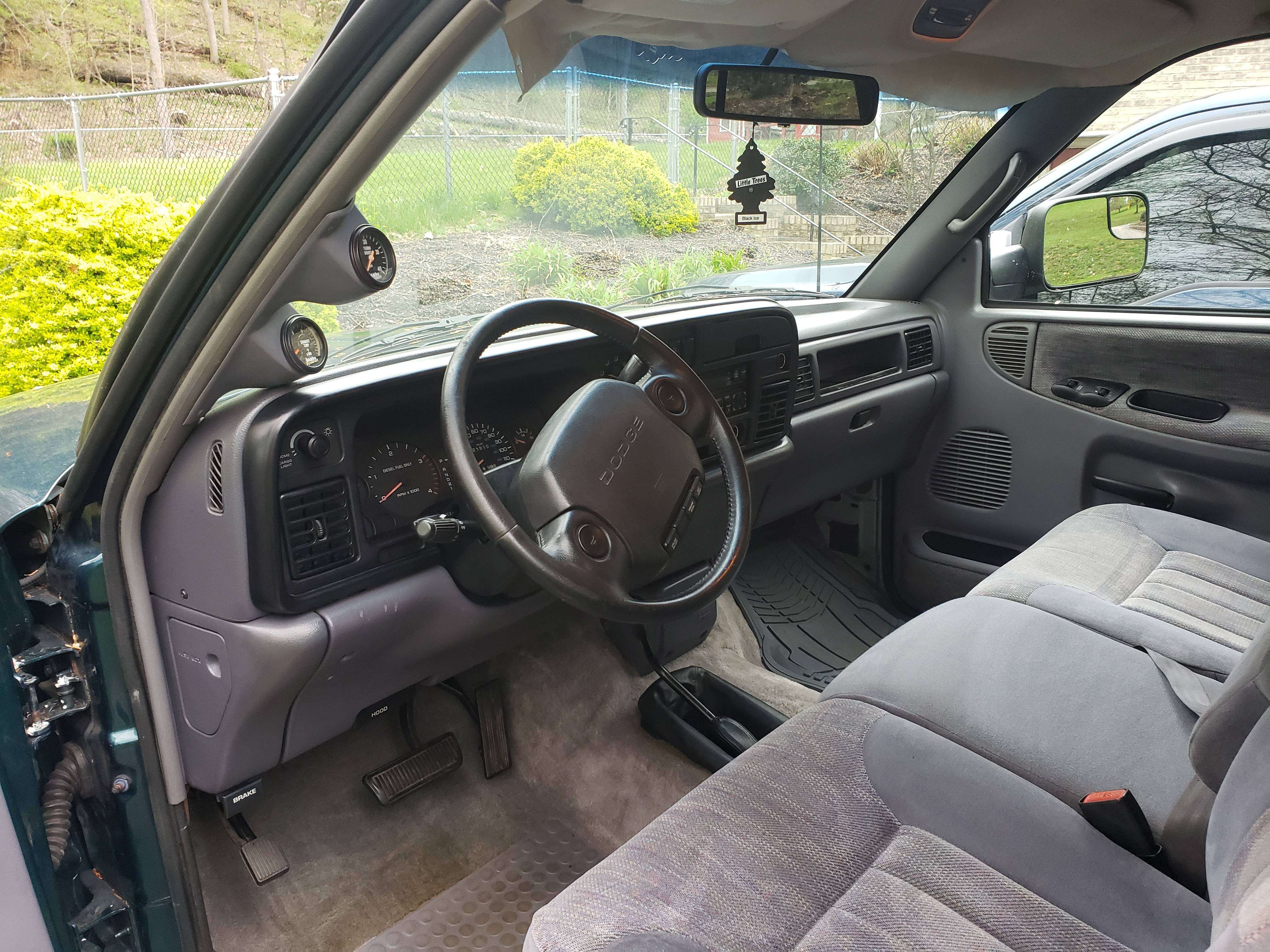

We had heavy storms night before last and there was no sign of water intrusion. Got the dash finished up yesterday and got my pillar gauges back into place and hooked up.

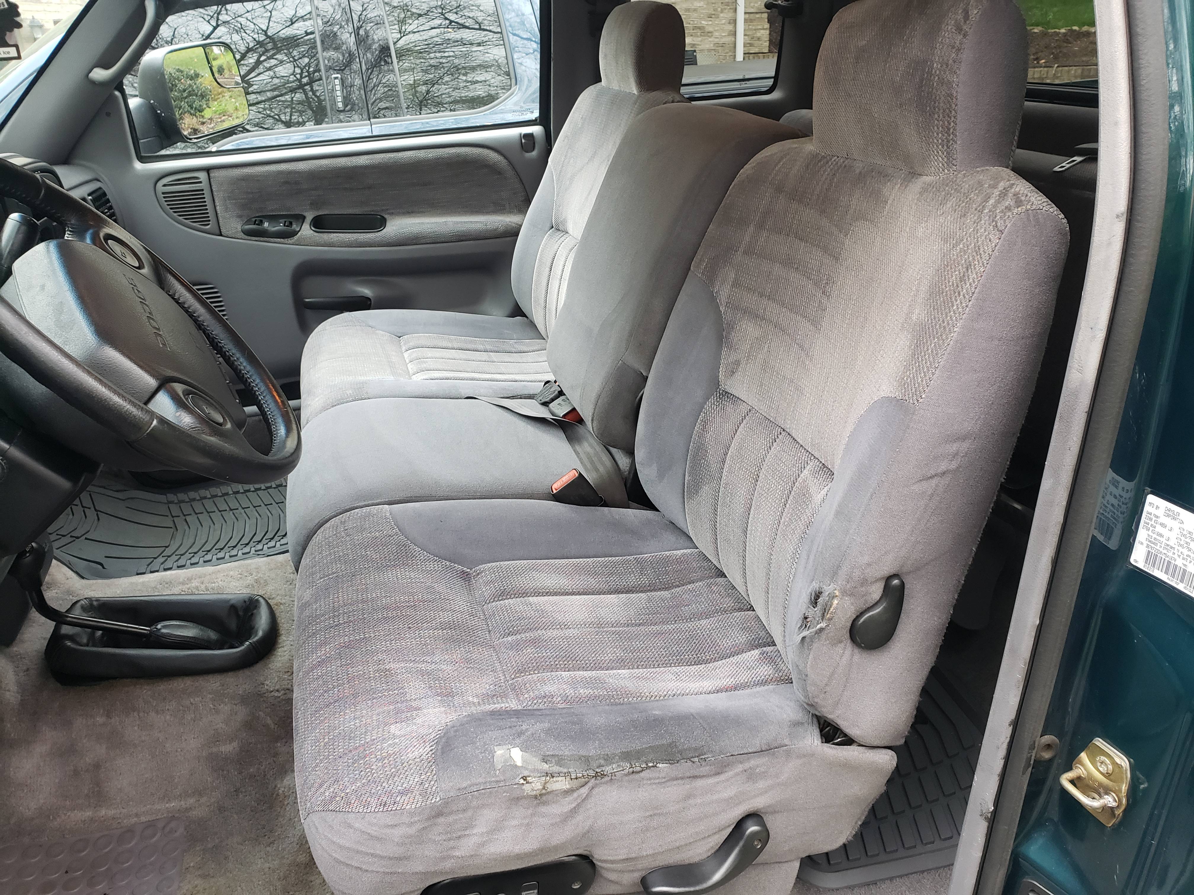

I also used a little Bissell upholstery extractor on the front seat and the door panels. Pulled a gallon or two of mucky brown water out of them. I'm prbably going to replace the driver's seat at some point but they look a whole lot better for now.

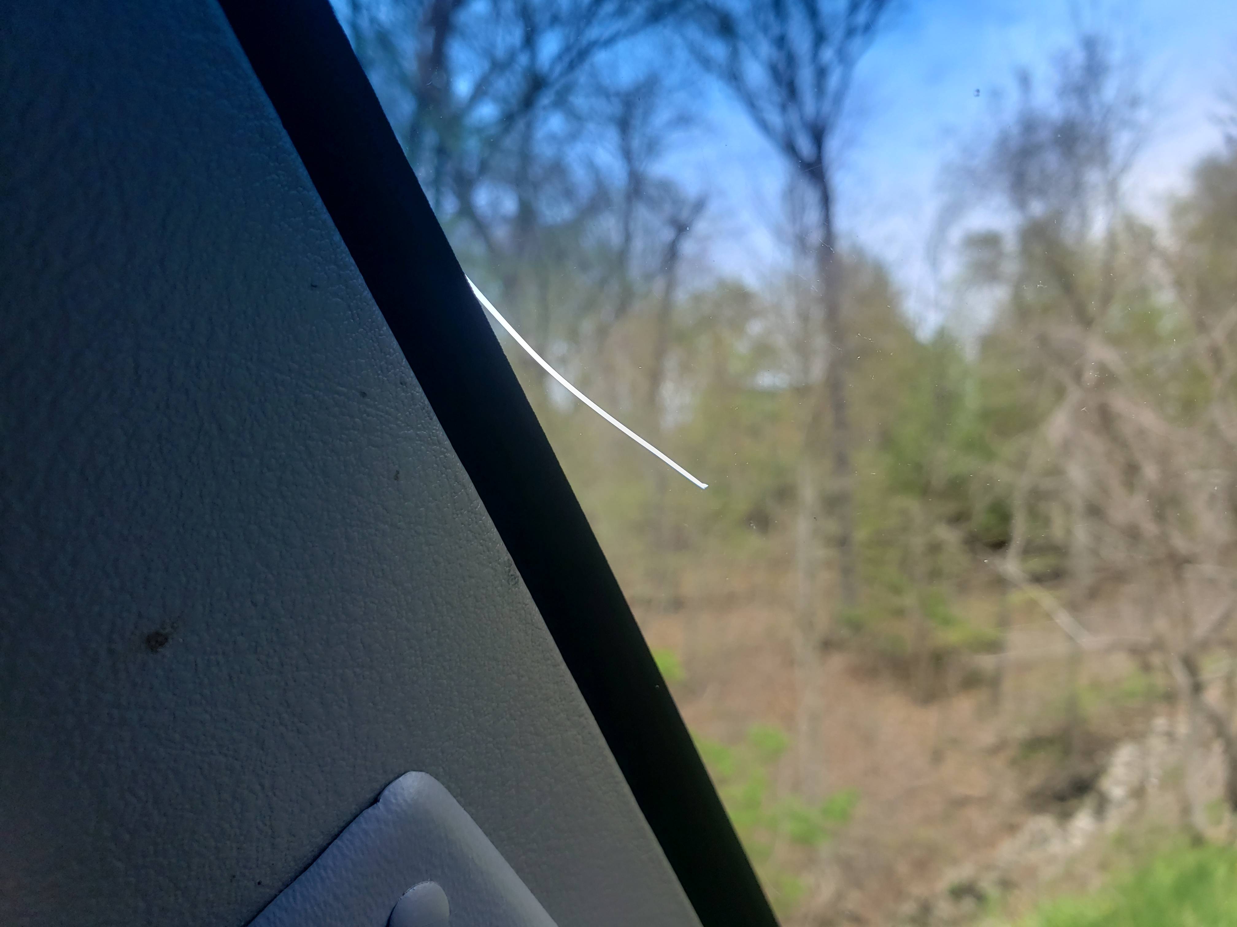

And despite my efforts to seal the windshield... I think I'm gonna need to replace it anyways.
Not sure what happened. Didn't notice it until I was putting the floor mats back in earlier today. I swore a whole lot when I first saw it. It's on the inside of the glass. Not a huge deal as it is but it will probably get bigger. My insurance will cover it and my deductible is a lot less than a windshield but I'm not gonna mess with it until it gets worse.
