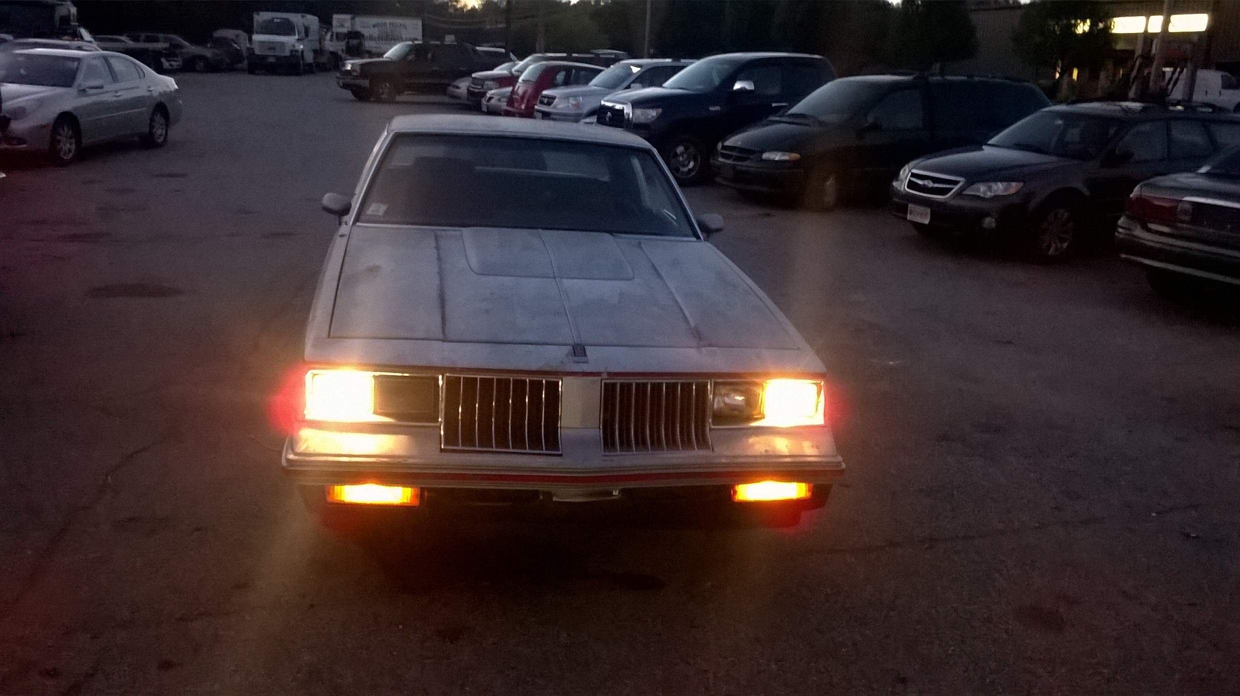

So I drove the Hurst home tonight; it's longest ride yet. It felt great to open it up on the freeway. Ran extremely hot; when I got home, I realized the coolant was leaking out. No big deal. A hose piece had rotted out. However, after getting the thing home, I do feel a little overwhelmed. Is that normal?

Totally normal. Welcome to the site from Houston. That's a cool ride. Good luck with it. That $10k figure with someone else doing all the work is realistic.

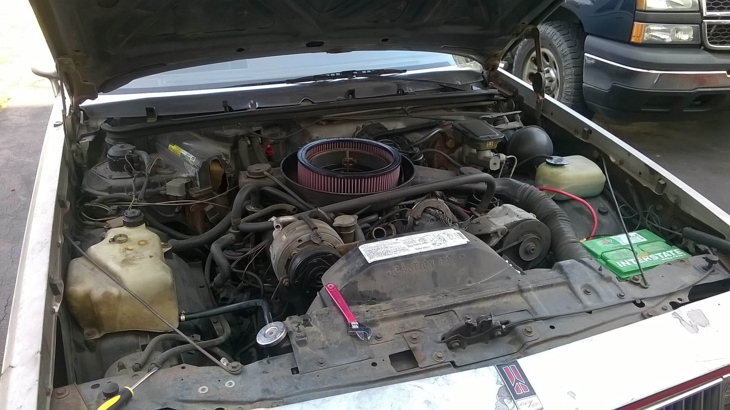

Ok, so at least some progress this weekend in between other work. I replaced all of the coolant and radiator hoses, flushed the system, replaced the grimy old Fram air filter with a K&N (as seen in the picture), replaced the thermostat, and removed and thoroughly cleaned the cast iron thermostat housing. It was pretty grimy. Replaced the gasket, made sure everything was free of debris and gunk. Since my last posting I've decided to keep the 307 in the vehicle. It's made it this far from 1984; I don't want to hack it up. It'd feel wrong. Plus, since bringing this puppy home and beginning it's transition to a fully restored beauty, I feel somewhat of a connection to this car-guts n all.
Also, my gauges currently don't work correctly, so I'm having a hard time with temp. From what I've noticed thus far, the engine seems to run pretty hot. Is this normal? Oil looks good, coolant seems to now be circulating correctly, air flow is good. Maybe I'm just being paranoid. Any input any of you guys have would be much appreciated. I bought an IR thermometer for cheap online, and will have to check it out this week when it's up and running again.

When properly built and setup, the quadrajet "is" a performance carburetor. They tend to get a bad rap from folks that don't know how to work on them, have had them rebuilt by folks that don't know how to work on them, or when they simply are not set up properly. If the factory ECM is still intact, you are going to want to keep the QJ. Find a reputable shop near you that specializes in quadrajets and you will be glad you did.
