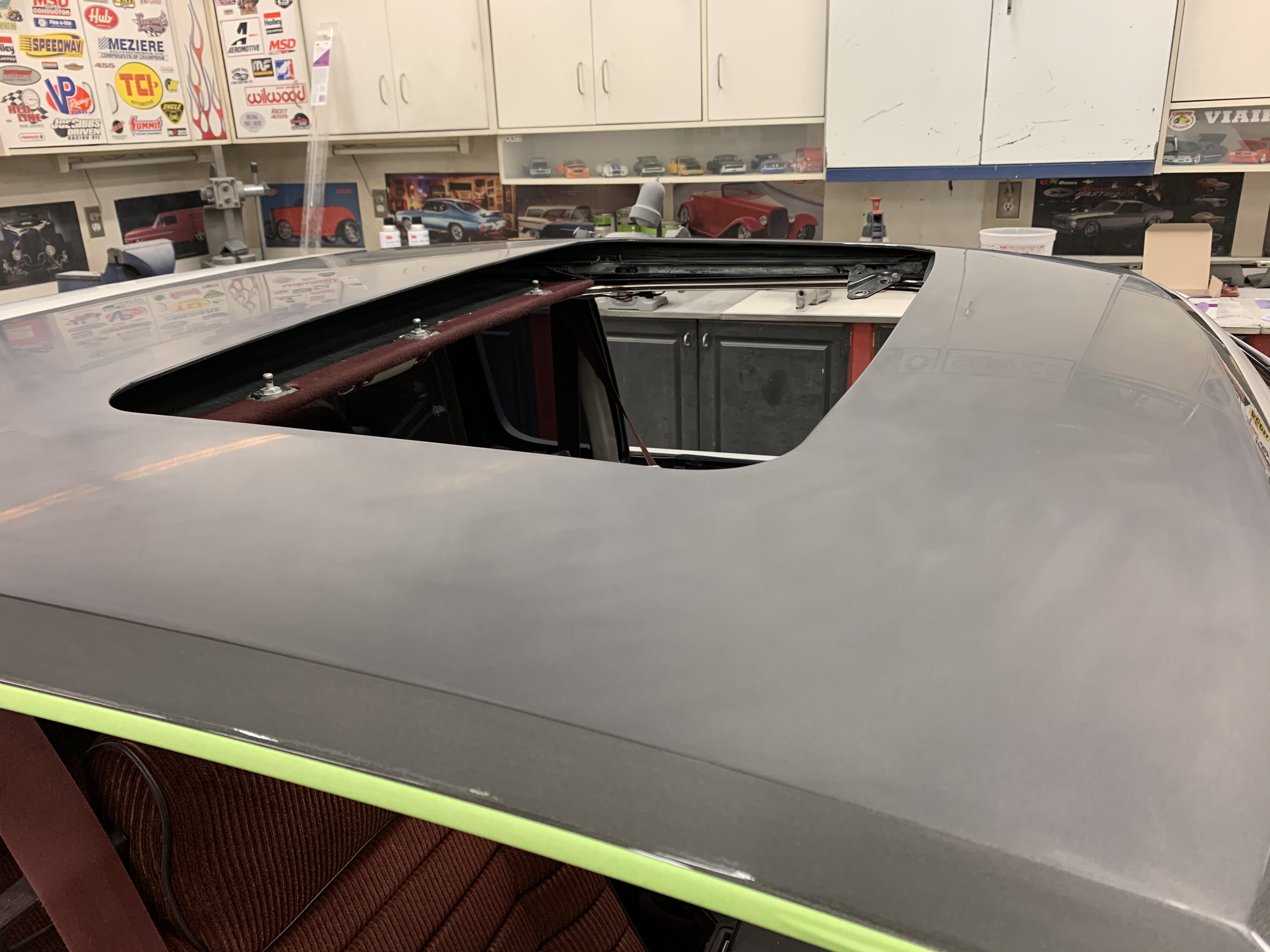

For runs and drips I find this to be the best tool for the job. It doesn’t give around the imperfections like sandpaper does. I’ve saved many jobs over the years that couldn’t have been saved with sandpaper alone.
https://www.amazon.com/dp/B0009IQYXK/?tag=gbody-20
Thanks for the link and tip, I’ll have to keep my eyes peeled for one of those. I stopped by my supplier on the way home tonight and picked these up...
...an intermediate pad and some 1000 grit 6” discs for the DA. I only have 2 spots with actual runs, so I’ve got a run file on order, but these should make levelling out the wide flat surfaces much easier and quicker.

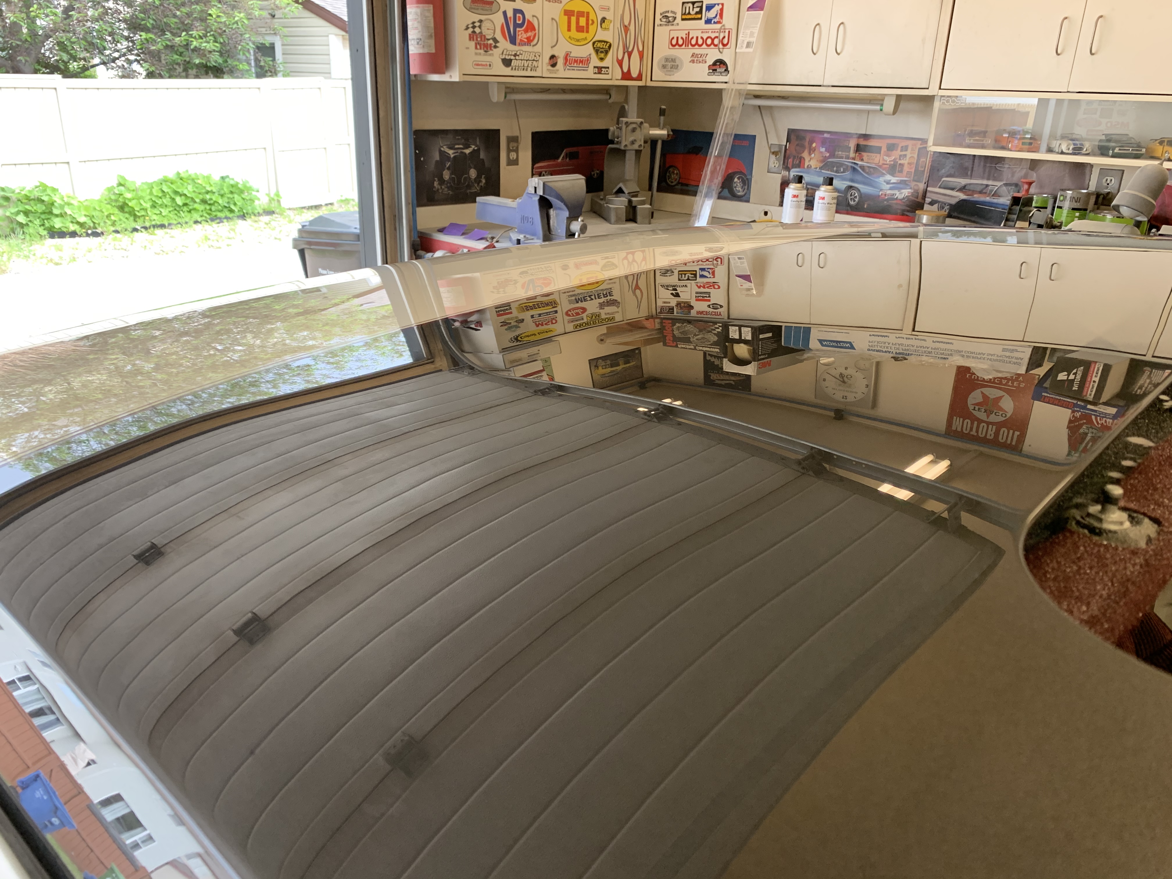

Bummer having to go over the sun roof again, Donovan, hopefully this time it passes your inspection. 👍
I really like the paint treatment on the trunk rocket emblem, looks classy.

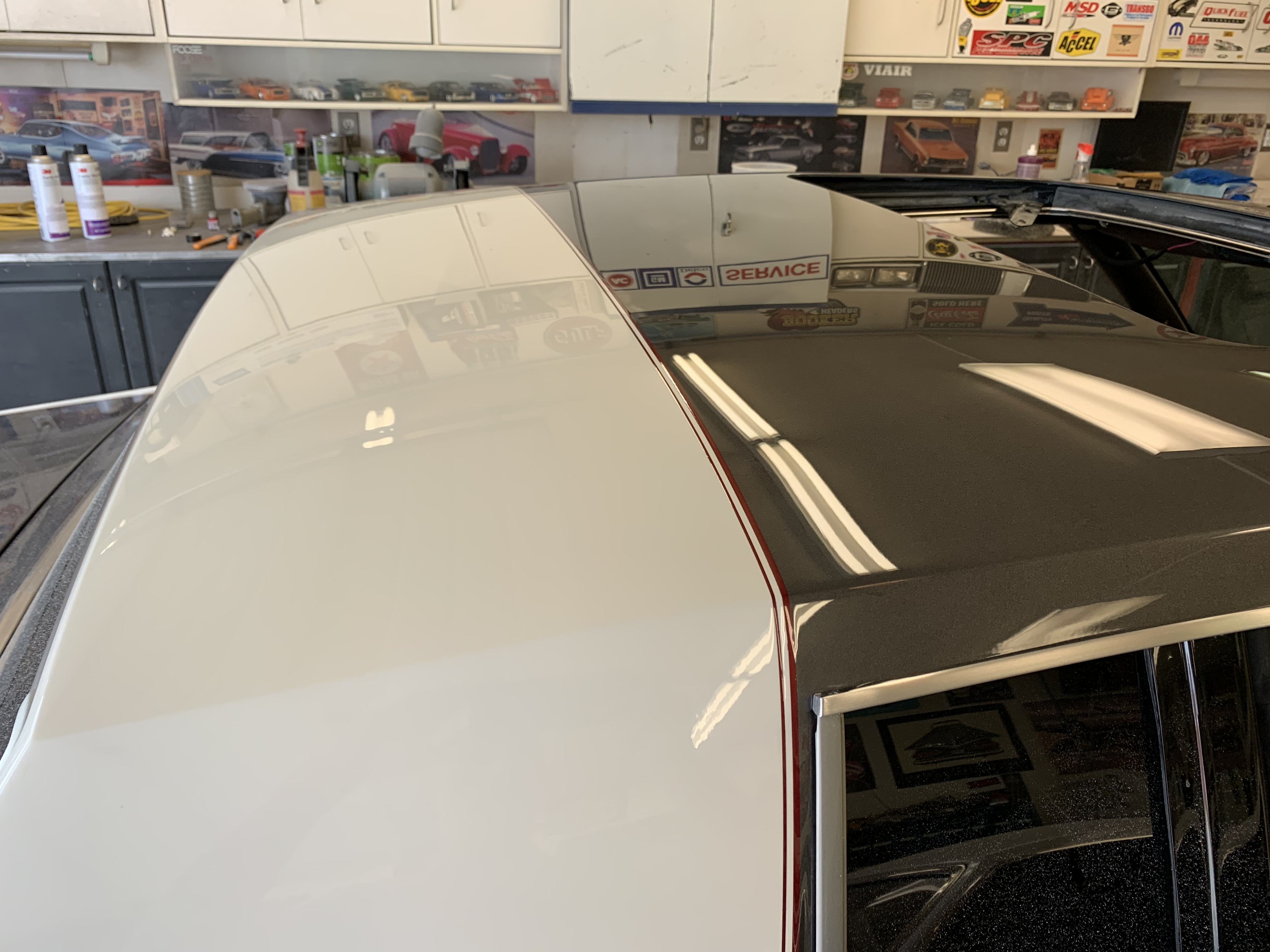

Meh, it’s not really so bad Mike. Once it’s been sanded once it doesn’t take very much to go over it again because it’s already flat. I actually polished up a test section last night after posting and it’s waaay better now.
