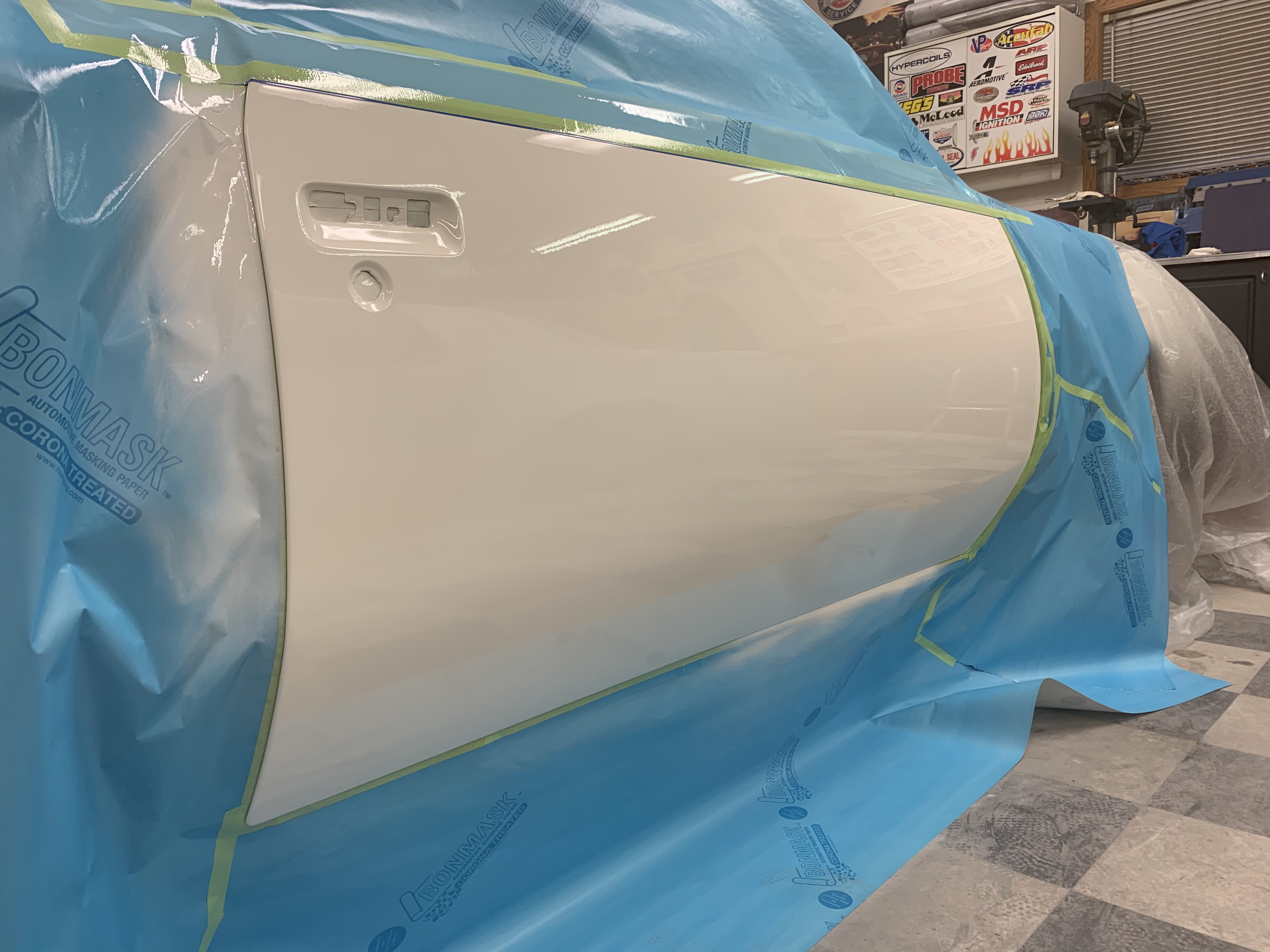

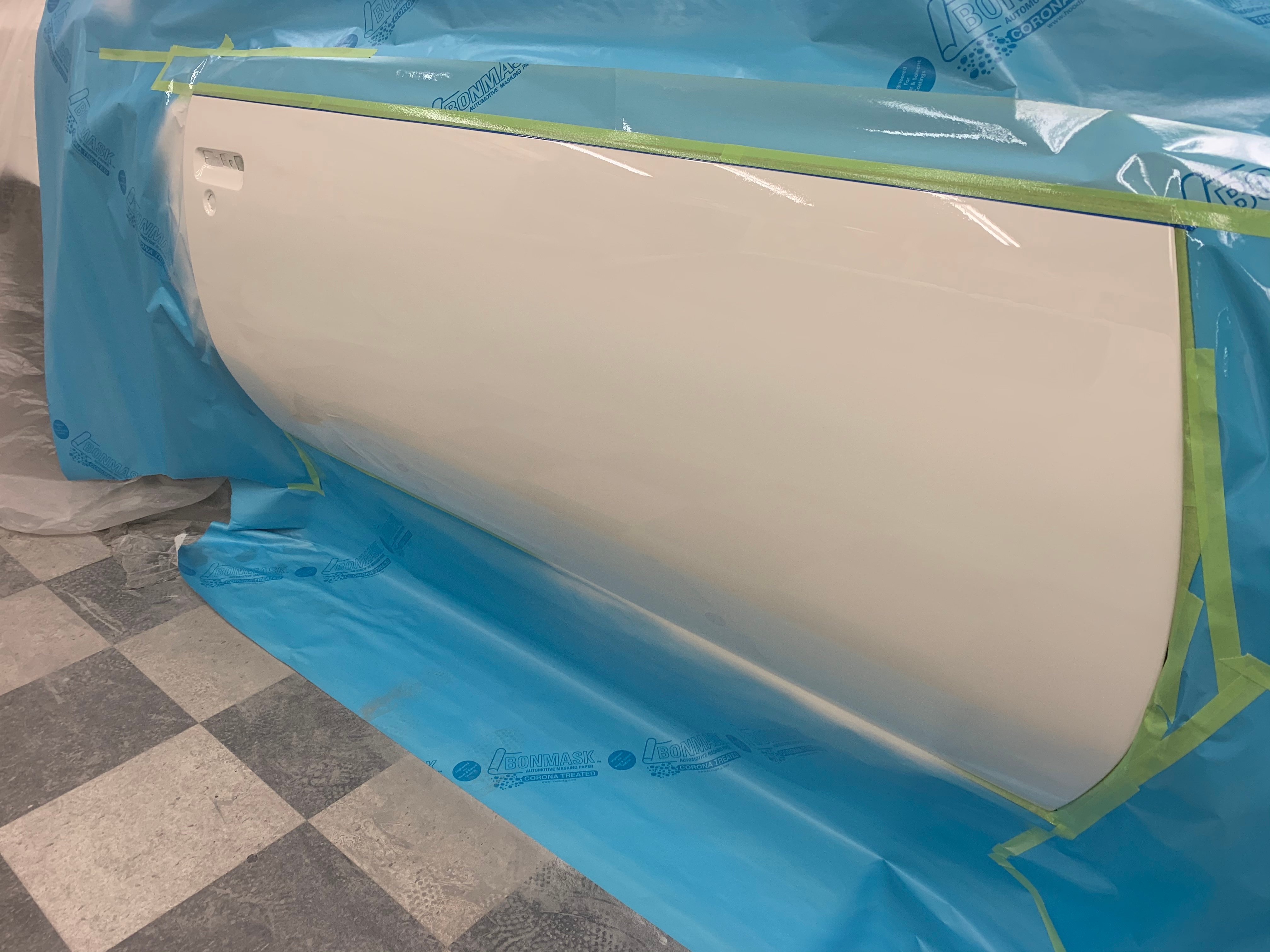

And done. No big deal, like I said just more time and material.

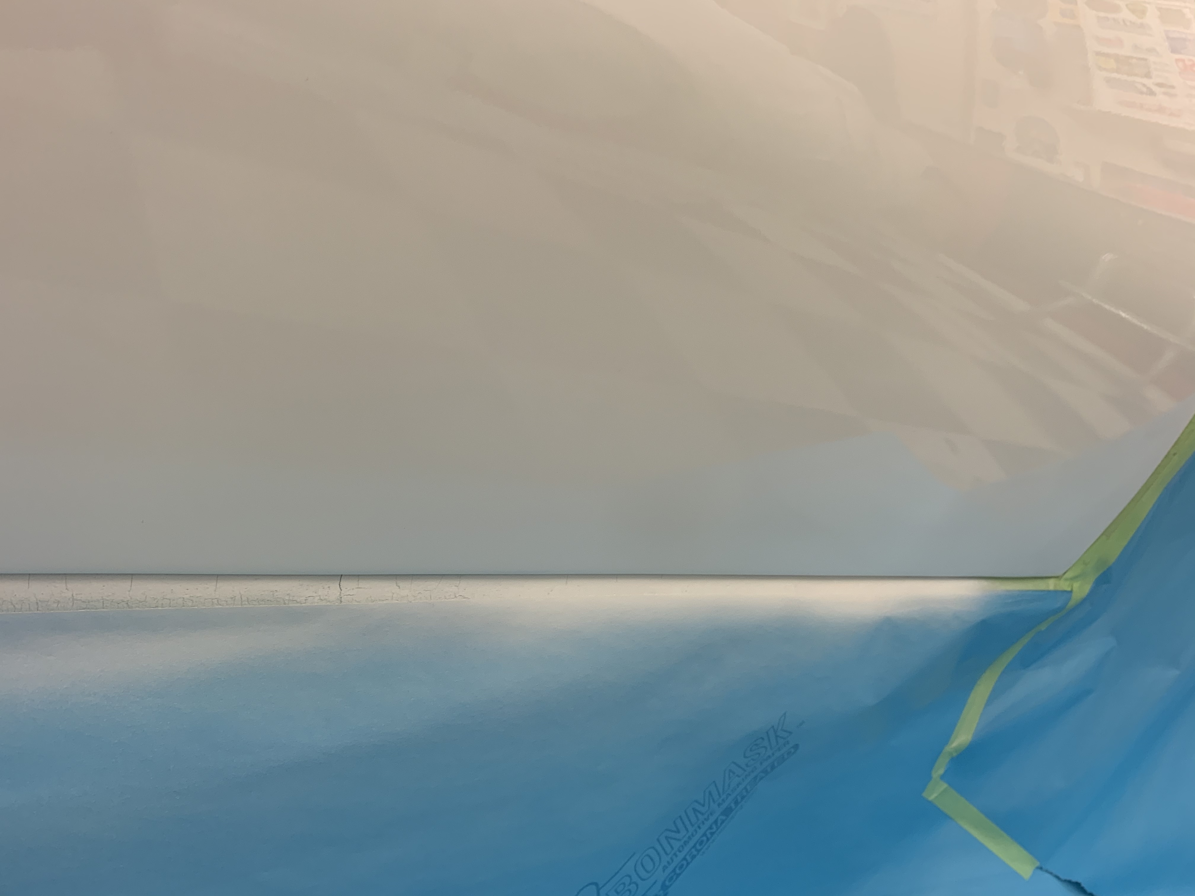

Spotted in the burn through spots, then re-cleared the whole door with 3 coats of PPG EC530.
I’ll have to re-wet sand the whole door again in 2000, but that ain’t but a thing.
The reason I burn through so easily on this thing is because I was STRONGLY recommended to not apply more than 3 coats initially. Otherwise I was told some catastrophic things could happen. These new environmentally friendly clearcoats aren’t like the old ones where you could just keep pounding coats on to have material to work with. So that’s what we did, only 3 medium-wet coats were applied in the booth. But the downside is less room for error in the wet sanding process.
Oh well, it is what it is, and I’m dealing with it as I come across it.
