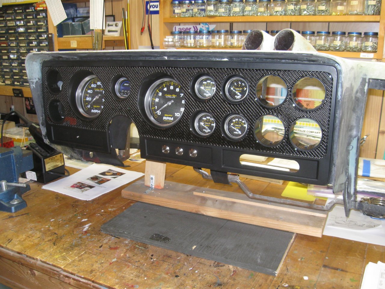

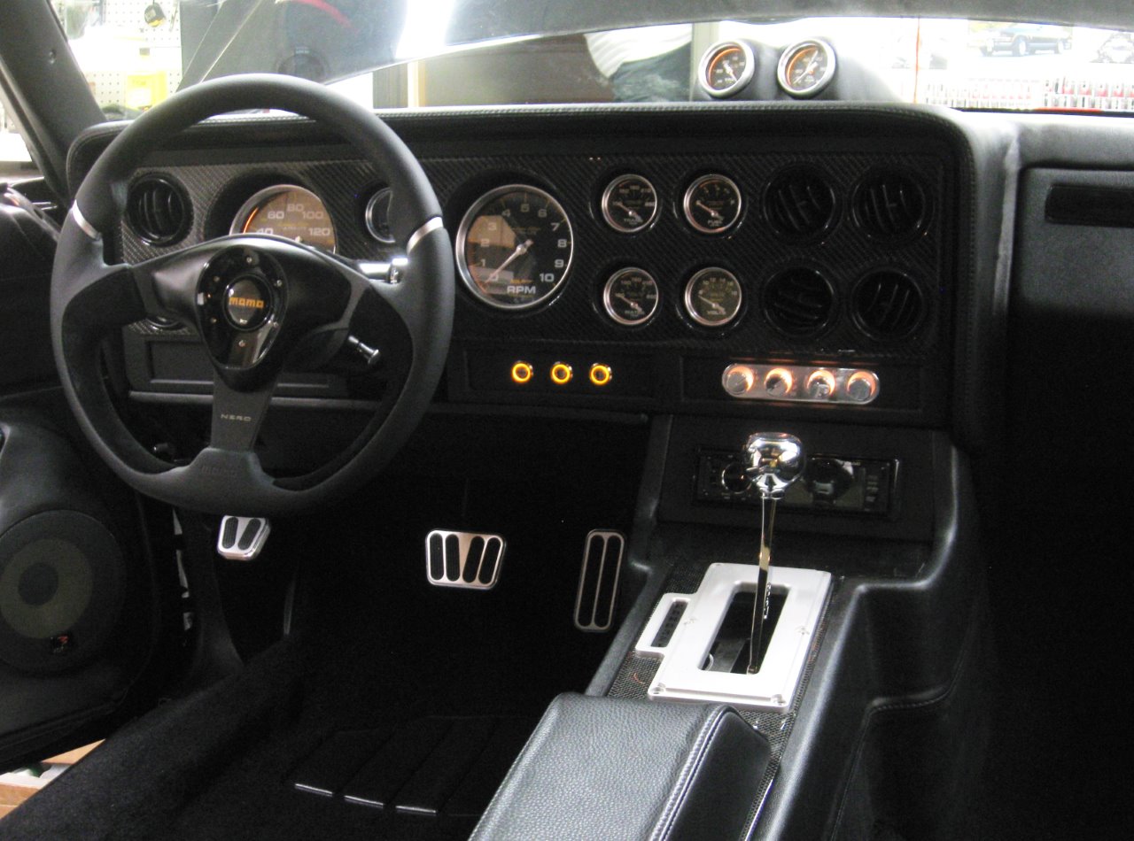

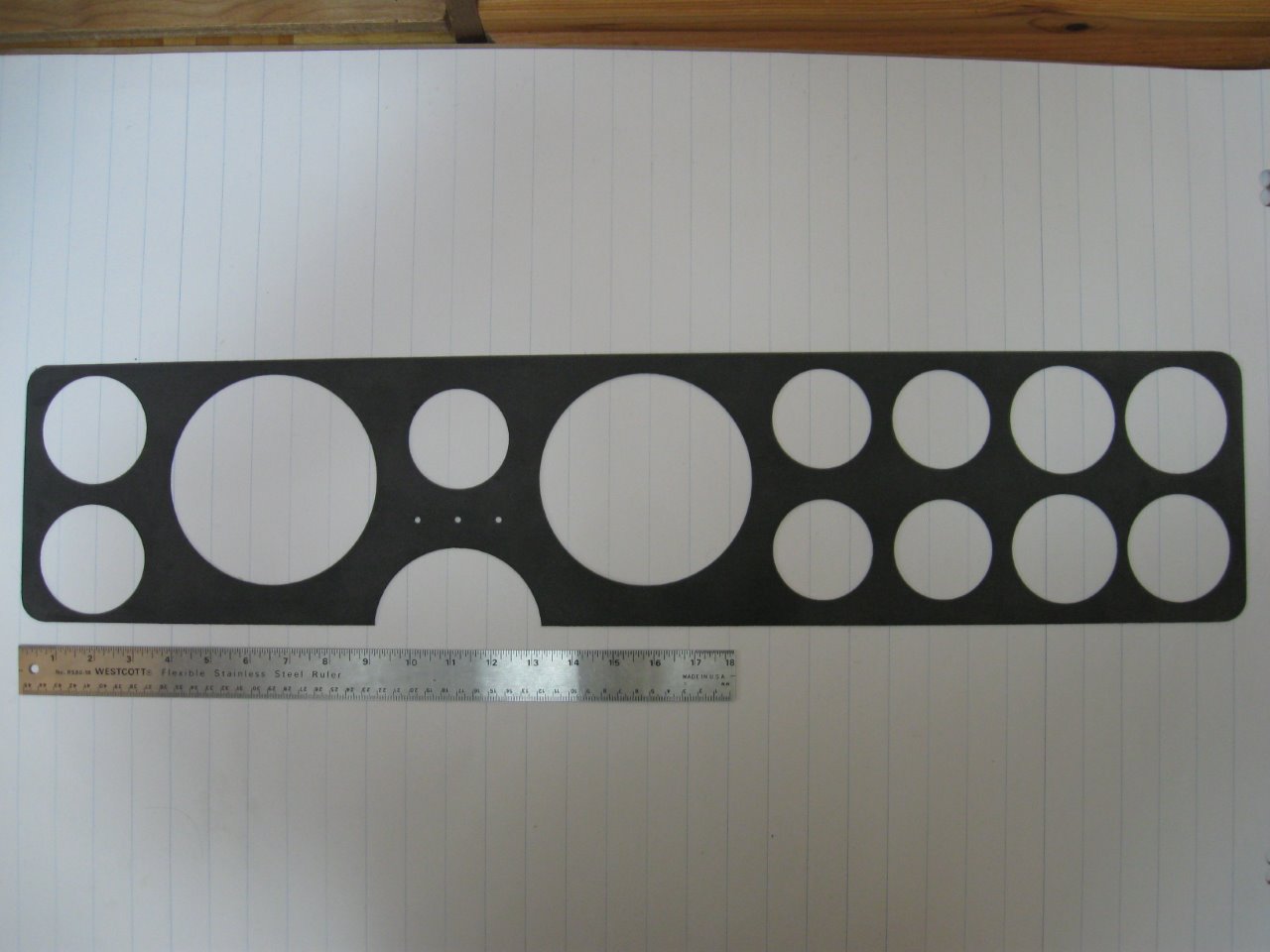

Yes, we did touch base regarding this issue back in Jan. However, I'll save you the trouble of having to search for the thread 😉 ... The dash panel is made from real carbon fiber with gel-coat applied over top. I made a CAD template, and a local outfit used a CNC machine to cut out the ABS back panel insert. The carbon fiber was then bonded to this panel.
View attachment 69509 View attachment 69510 View attachment 69511
