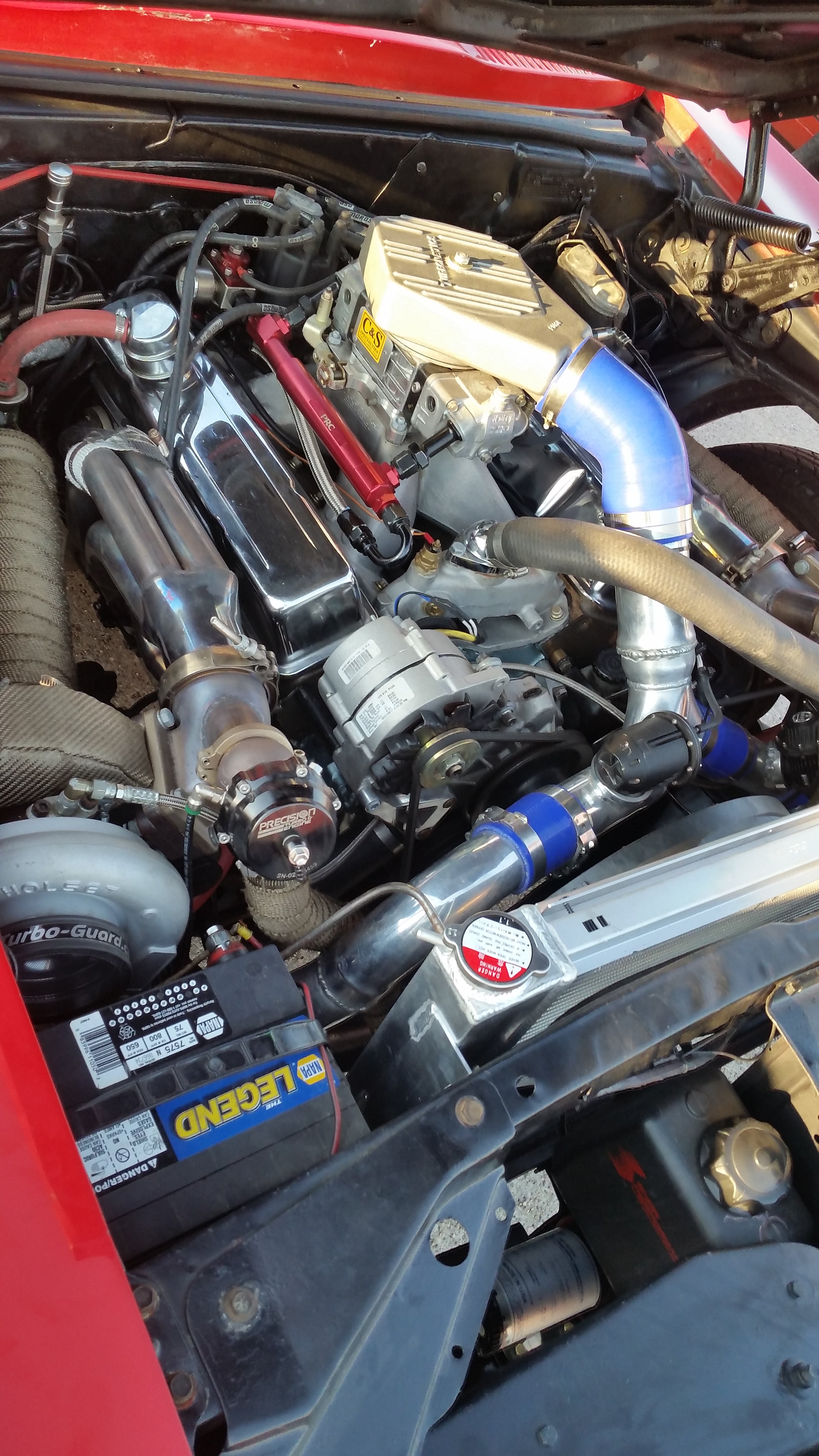

I had a little time tonight and I tried messing with my tune. I tried your suggestions. The engine ran like sh*t. Ended setting it up like this and it worked a lot better.
I took pictures of the AFR's, but they are too blurry to see. 14.1 at idle, 13 at cruise, and 11.5 at wot. Still getting a lot of knock on the gauge. It is pretty consistent, but if you back out of the throttle and get back into it it goes away. Fauls knock? I am only getting about 10 psi boost right now. Don't really think it should have any real knock at that low of a boost level. I did see kind of what is going on with the low-end power. At idle or low rpm under a load the timing is jumping around and way retarded, like 0 or 9 degrees from 17 degrees and then it jumps back up. What would cause this i don't know? I am thinking about buying a BTM MSD box and doing away with the Holley timing control for now. The problem I see with that is my distributor does not have any advance any more. It is locked out. I bought it that way. What do you guys think? On a lighter note, I took the car to town to get gas for the skidloader. Every were I went people were giving me the thumbs up. Even a bike rider going down the highway gave me a thumbs up. I must be doing something wright i guess.

Well I found some time tonight to play around with the car and get bugs splattered all over the windshield. I found my base timing was way off. I put my timing light on it. It should have been reading 15* but was not on the chart. I think it was advanced too much. I moved the distributor before I figured out how to run my timing light so I am not sure. I ran the car up and down the highway and adjusted my settings a little bit. This is were I am at right now.
It runs a hole lot better! Pulls like a freight train now, and I am only getting 7-10 psi of boost. I can only imagine what 20 psi would be like. I still have some issues yet though. It will not fry the tires!? When you try and launch the car or do a brake stand the timing backs of to 0 and once you get rolling it jumps up to were it should be. Any ideas? Second issue is I am getting into the red on the knock gauge at 7psi of boost. Is it faulse knock? I have a hard time believing it is getting that much knock at that low of a boost. Timing did not change the gauge reading any. Even with the hesitation off the line I bet I am pulling a hundred MPH in the quarter mile. It gets up and rocks. MrSony better look out! I am starting to see what the stink is all about when people talk about Grand National's now. I would post a video if I knew how. P.S. The hell with that draw though crap. Throw it in the junk and blow through!
I drove the old girl to work Friday.View attachment 91315 It is running pretty good. It does not have the power yet I think it should though. It drives good and will get up for a driver, but it should have more. I think I can take a certain some one with a Buick 350, but don't know if I can beat a four door pig.
