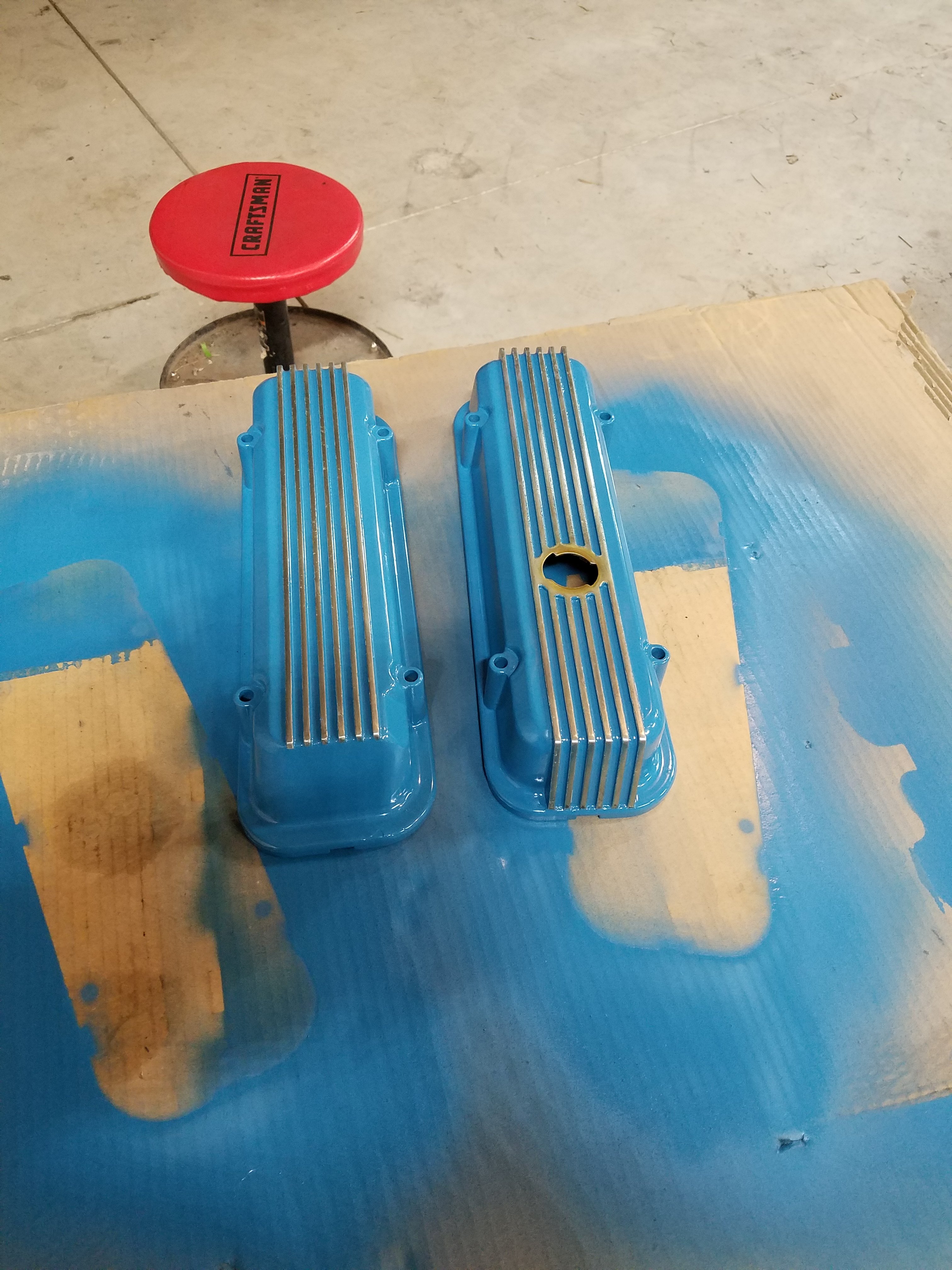

Just a little tip to make your life easier if you have to redo your valve covers again, next time just paint them all over, complete. Then take a little lacquer thinner on a clean rag or towel and wipe the paint off the tops of the fins. Q-tips dipped in lacquer thinner works equally as well, that’s what I use to do mine. Or you could sand the fins with some coarse sandpaper, but that tends to just clog up the paper.
It’s way less frustrating than trying to mask them all off ahead of time.

I have been chipping away at getting my car fixed. Seems like everyone and everything in my life have been needy lately. Hard to find time to work on it. Almost have all my parts to put it back together. Me and Fedup ****ed up last week. One of my packages with my headgasket said it was delivered Thursday, but it wasn't. I called Fedex Saturday to find it. That was not much good. A neighbor a few miles away had it delivered to them Saturday afternoon. They were nice enough to bring it over. Opened the box and found Rockauto sent me the wrong intake gasket and I only ordered one headgasket instead of two. The block is ready to go. View attachment 146472 Kind of a cute little fart. For such a little engine it sure does make some power. I have been cleaning up and repainting engine parts. Heads and intake are ready to go. View attachment 146473 Valve covers turned out good. View attachment 146474 They were kind of a c*ck to mask though. View attachment 146475 I painted the headers with some grill paint. Supposed to be good to 1500*. We will see how long that last. View attachment 146476 Looks like I get to sand and repaint my air cooler again. View attachment 146477 Yesterday when I painted it, it fisheyed. I tried hitting it with another coat tonight and that happened. Kind of boring stuff, but it has been kind of quiet around GBF so I posted it.

I know what you are saying. The thing is. I polished the fins before with a buffer and clear coated them. That is why I taped them off. Thanks for the compliments and advice. Much appreciated. If I ever do another set of valve covers like this I will do it your way for sure.
