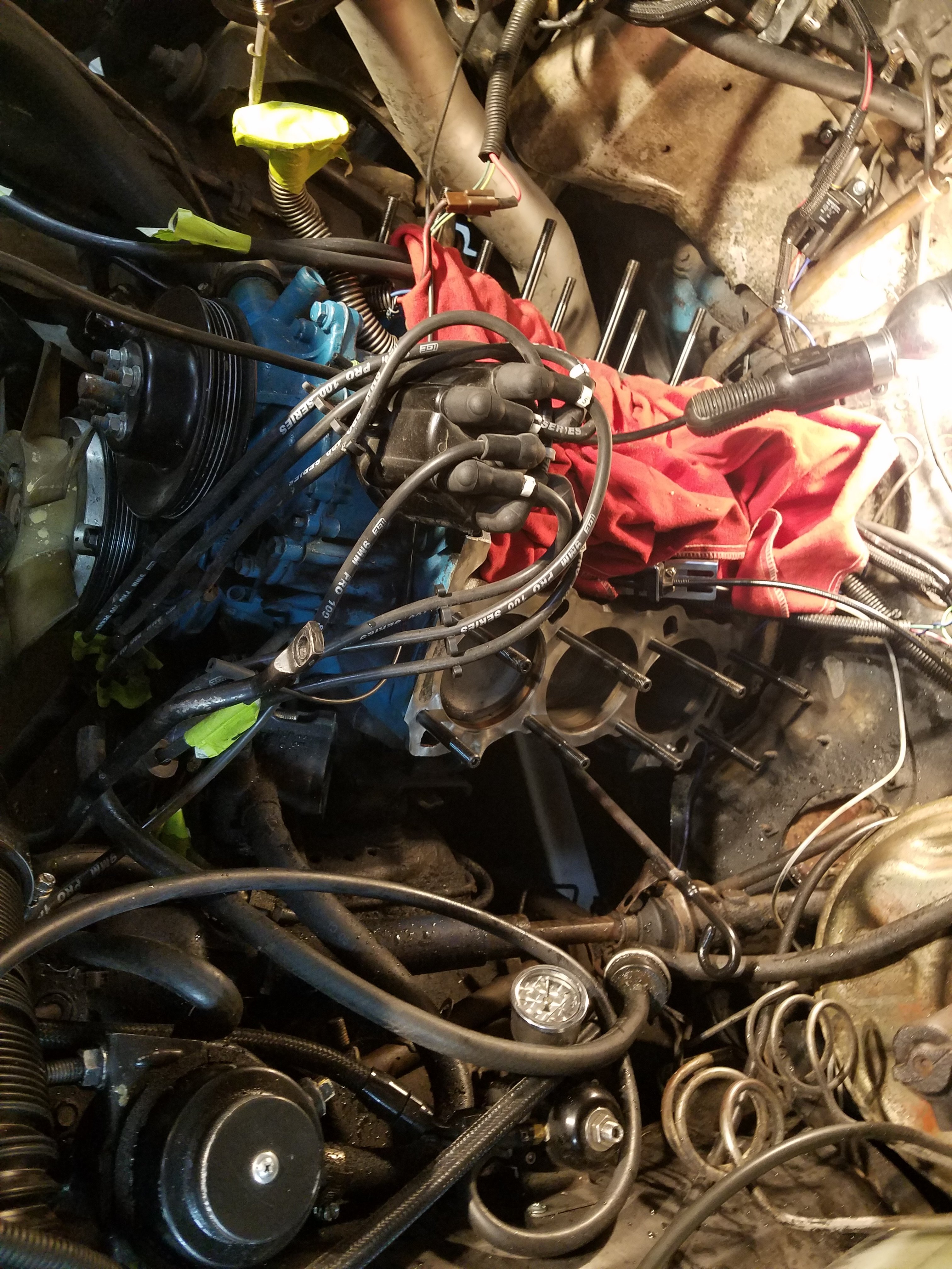

I have been chipping away at getting my car fixed. Seems like everyone and everything in my life have been needy lately. Hard to find time to work on it. Almost have all my parts to put it back together. Me and Fedup ****ed up last week. One of my packages with my headgasket said it was delivered Thursday, but it wasn't. I called Fedex Saturday to find it. That was not much good. A neighbor a few miles away had it delivered to them Saturday afternoon. They were nice enough to bring it over. Opened the box and found Rockauto sent me the wrong intake gasket and I only ordered one headgasket instead of two. The block is ready to go.
Kind of a cute little fart. For such a little engine it sure does make some power. I have been cleaning up and repainting engine parts. Heads and intake are ready to go.

I have been chipping away at getting my car fixed. Seems like everyone and everything in my life have been needy lately. Hard to find time to work on it. Almost have all my parts to put it back together. Me and Fedup ****ed up last week. One of my packages with my headgasket said it was delivered Thursday, but it wasn't. I called Fedex Saturday to find it. That was not much good. A neighbor a few miles away had it delivered to them Saturday afternoon. They were nice enough to bring it over. Opened the box and found Rockauto sent me the wrong intake gasket and I only ordered one headgasket instead of two. The block is ready to go. View attachment 146472 Kind of a cute little fart. For such a little engine it sure does make some power. I have been cleaning up and repainting engine parts. Heads and intake are ready to go. Valve covers turned out good. They were kind of a c*ck to mask though.I painted the headers with some grill paint. Supposed to be good to 1500*. We will see how long that last. Looks like I get to sand and repaint my air cooler again. Yesterday when I painted it, it fisheyed. I tried hitting it with another coat tonight and that happened. Kind of boring stuff, but it has been kind of quiet around GBF so I posted it.
