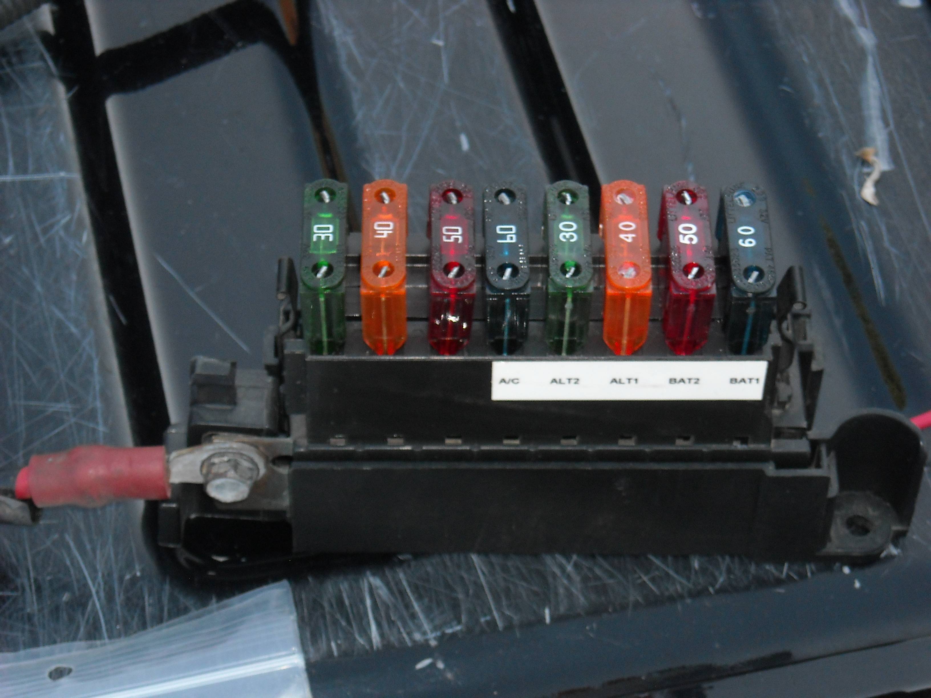

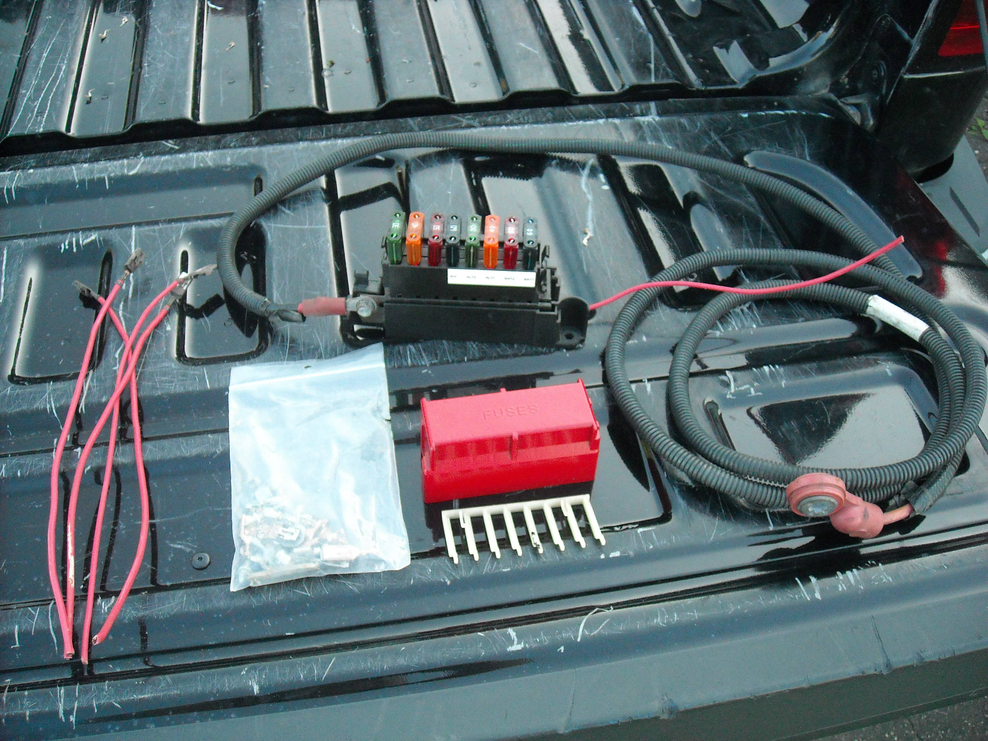

Yah, mon. Y'all are on the right track. Those fusible linked 10 gauges at the starter and alternator can absolutely be consolidated somewhere other than the starter. I've been looking for a multiple, MAXI fuse distribution block for a while, and haven't seen one. You could probably slide with 30a ATCs, but I'd feel more comfortable with 40-50a since they feed the ignition switch.
