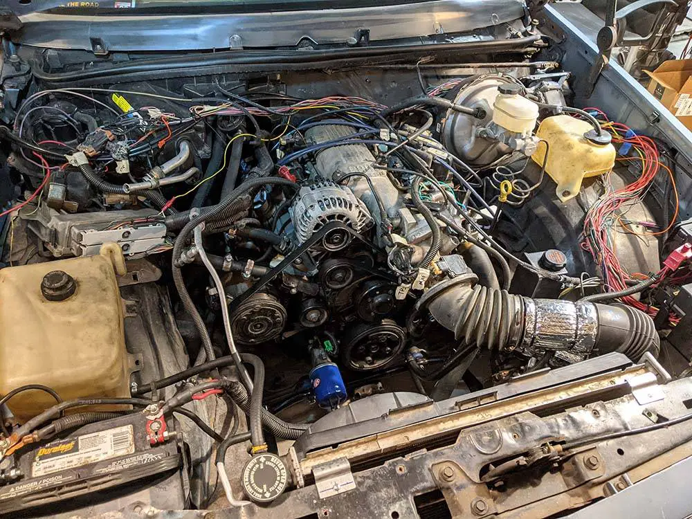

Your car inspired me to do my own 3800 swap. The information you've posted, as well as others (Operation Lipstick on Pig for example) were a huge help in getting it done. It's taken me a good half year to get it finished, aside from some final details here and there (clean wiring :rolleyes:). I Bought a wrecked Camaro for $500 and was able to use just about everything from it. I'd love to go the turbo route next.
How are you tuning it? Are you using a gm pcm?
View attachment 182582 View attachment 182583
This is really awesome! I love how you were able to fit the A/C compressor down in the bottom location too, that's something I wish I would have done.
Wiring was probably the most time consuming part of the swap because you're basically rebuilding your own harness and power distribution. I feel your pain haha!
I'm tuning it with DHP myself but you could also use HPTuners too if you're using the stock PCM.
Fun fact, the 98-00 PCMs don't have any theft deterrent coded into them so you can pretty much just grab one of those and be ready to fire.
If you need any tuning help to get it going feel free to message me!
