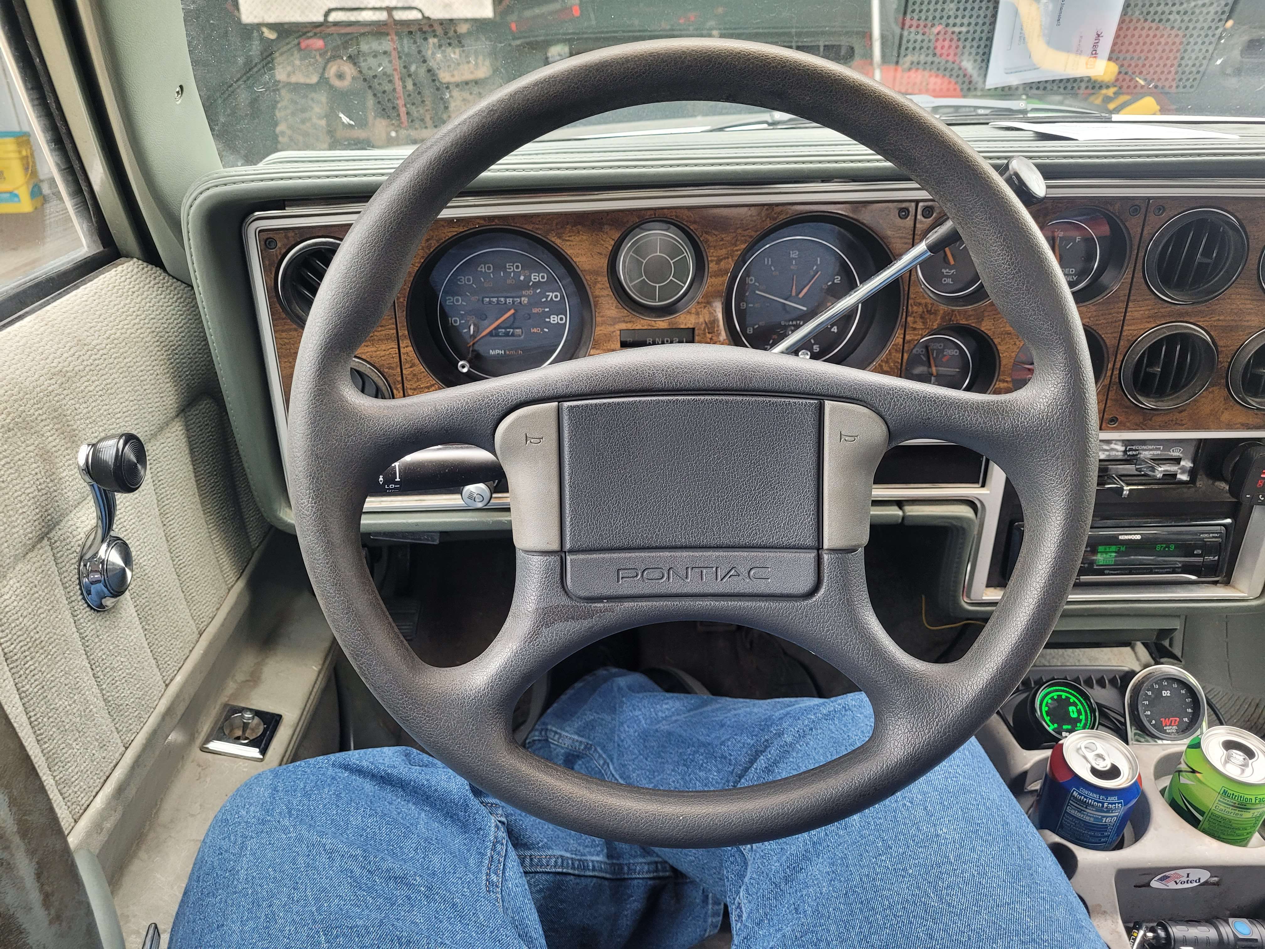

Put my new steering wheel on today and while it definitely feels different I think I am going to like it. The light gray doesn't look too out of place and since the car the wheel came from had a Saginaw column in it, it fits like it belongs there.

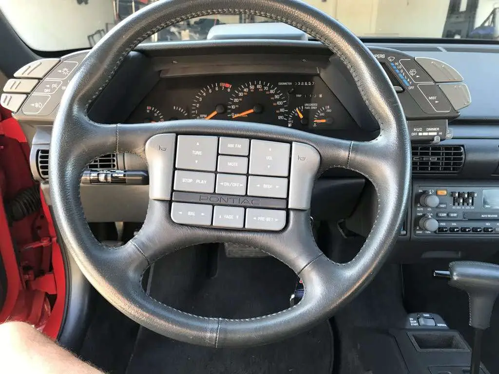

In the longer term, this wheel opens up the option of period-ish correct Pontiac steering wheel controls so I don't have to constantly keep track of my head unit's tiny little remote.
nineties-nirvana-clean-low-mile-1992-pontiac-grand-prix-se-coupe1992_pontiac_grand_prix_2_dr_s...jpg

So sacrificial column is in the future to see if the needed electrical will fit our columns?
Kind of. I will have to swap in an upper column out of a 90's Grand Prix or a Pre-VATS Cadillac to gain the needed clock spring and extended steering shaft. Then just run the wires to an adapter box or straight to a remote-capable Delco radio (which I already have on the shelf). Apparently this is not an uncommon swap in the Fiero world, so I won't be blazing a new trail or anything.
I already have an adapter box from my old ZJ that will work, but I would honestly rather be set on fire than disassemble that steering column again after changing that wiper switch for the 3rd time. I will probably still do it, but it won't be right now.
