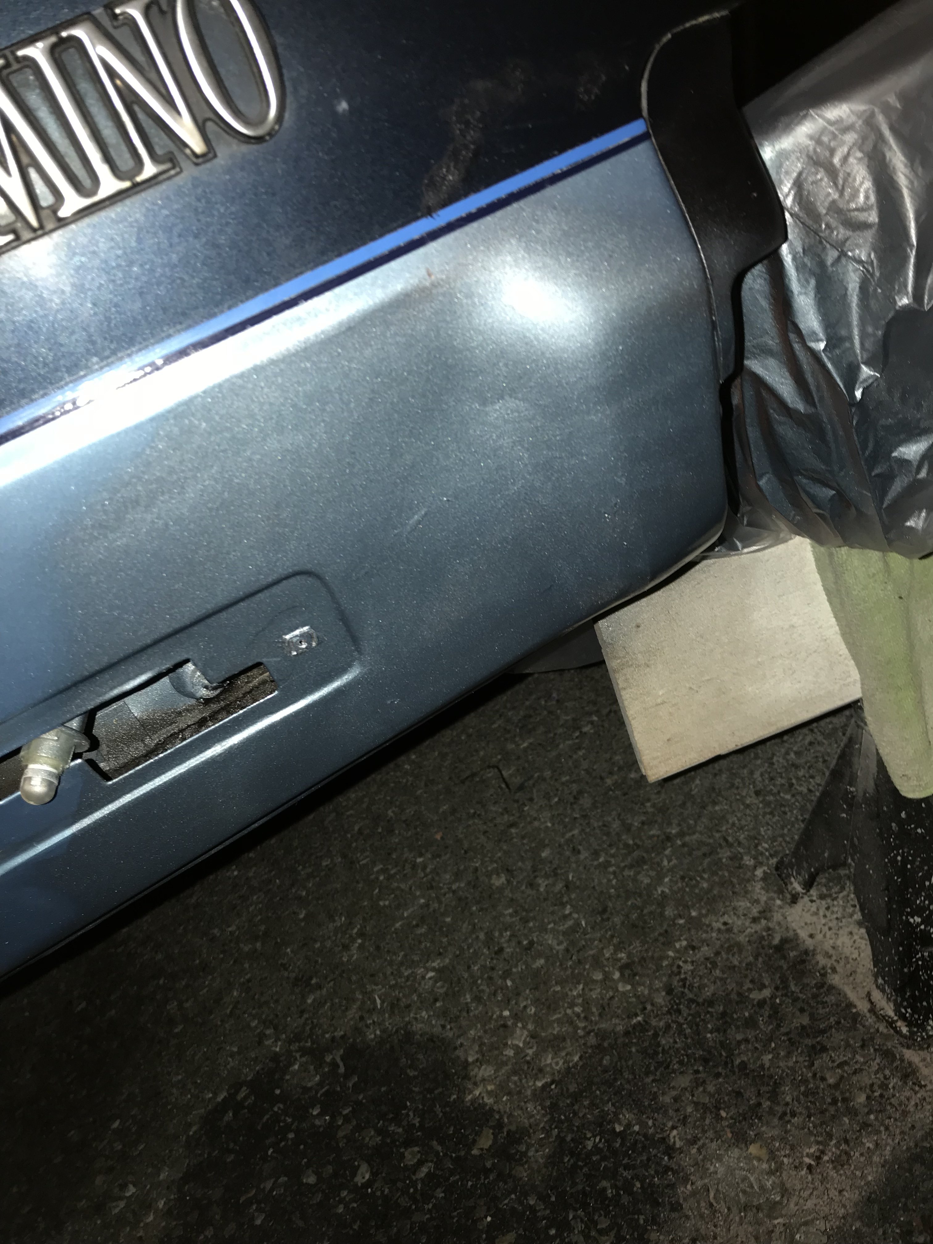

Cut out a rust hole in the Camino and patched her up. Not show car quality but it's not a show car so it's all good with me

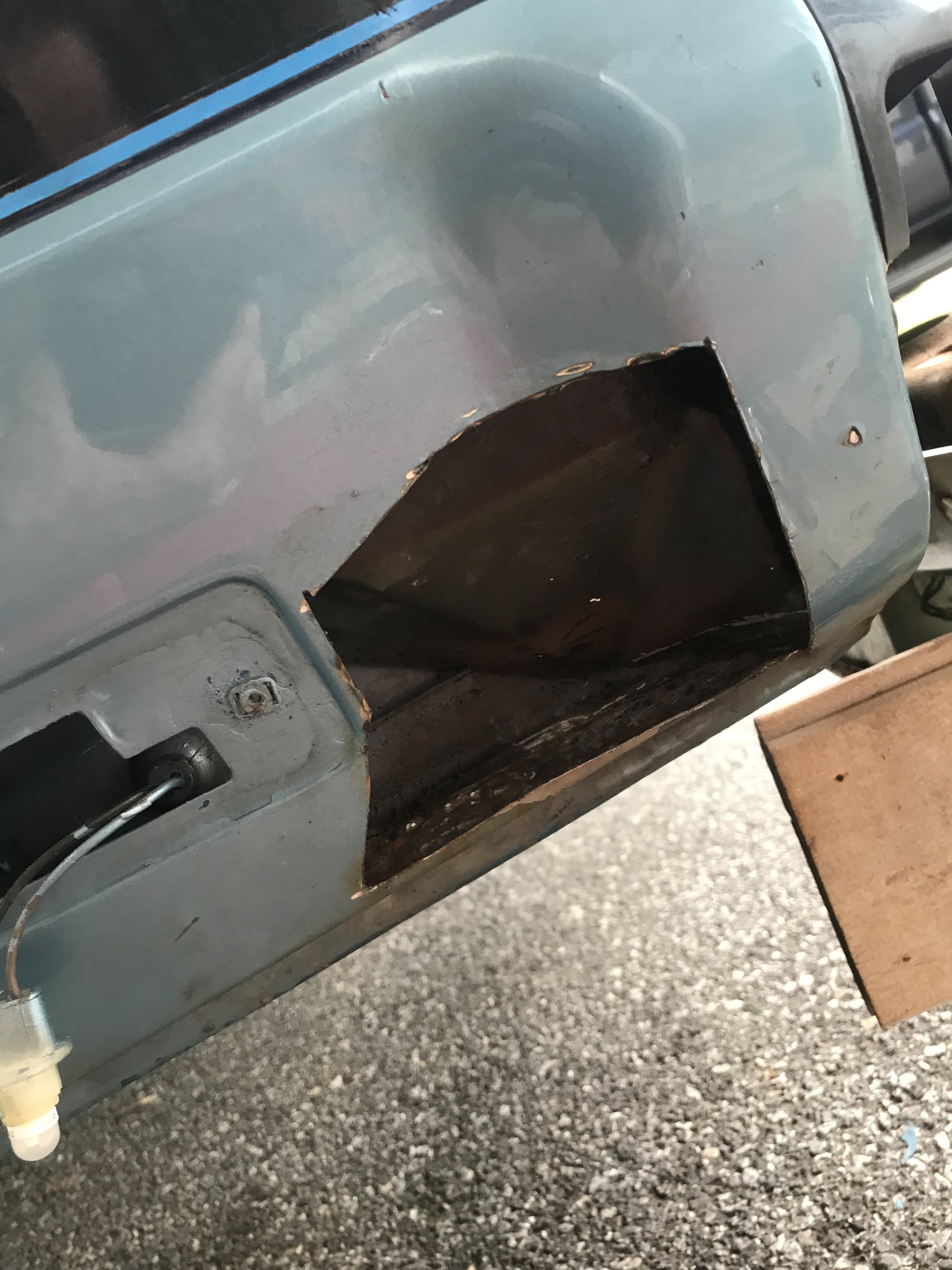

I shoulda took a pic of the rust spot. It was really bad, from underneath the bumper almost to my side marker light. Got her sawed out and grinded/sanded all the rust away inside

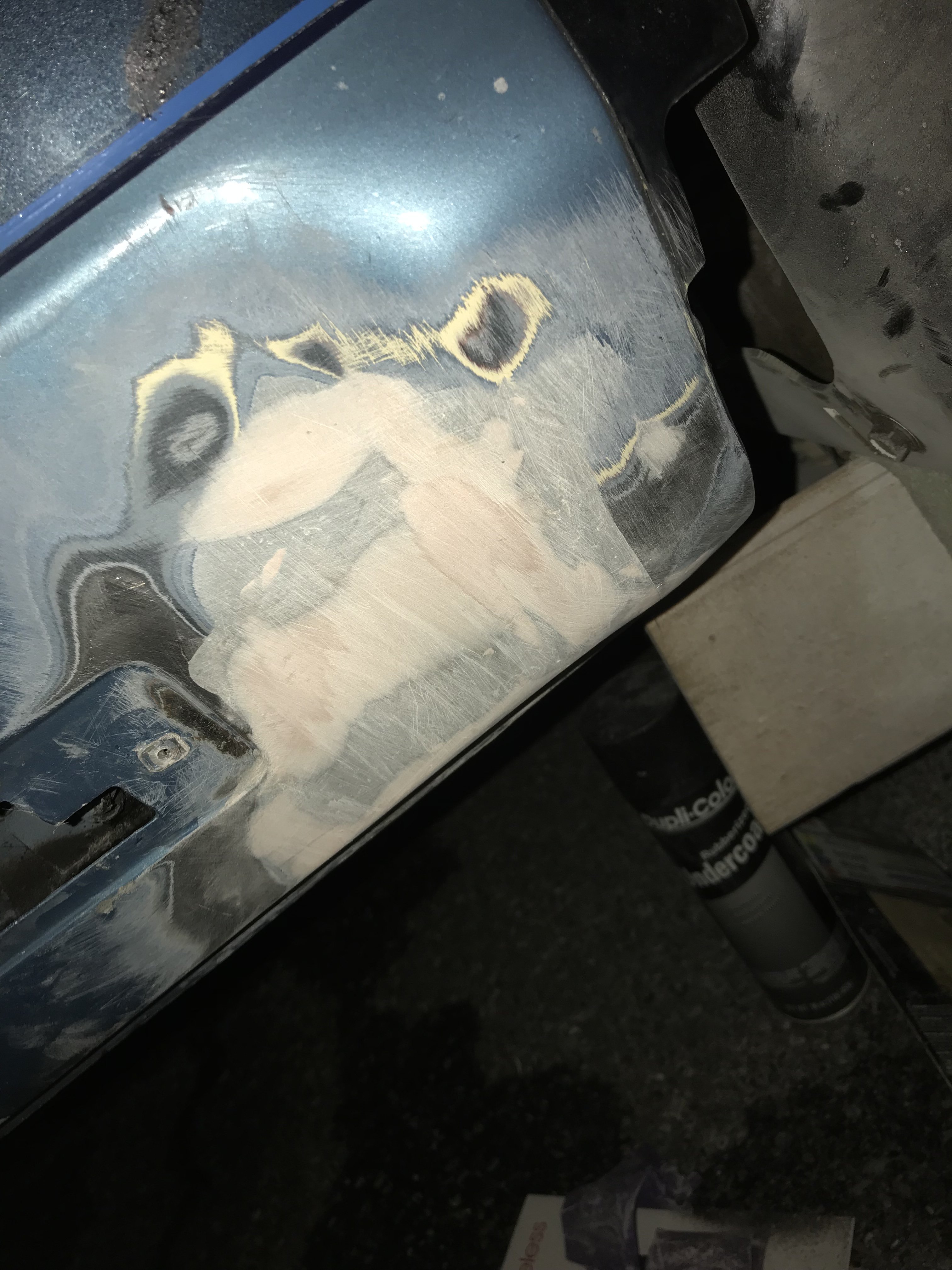

After the first bit of Bondo and sanding. Used wire mesh to reshape the body so the fiberglass filler had something to hold on to

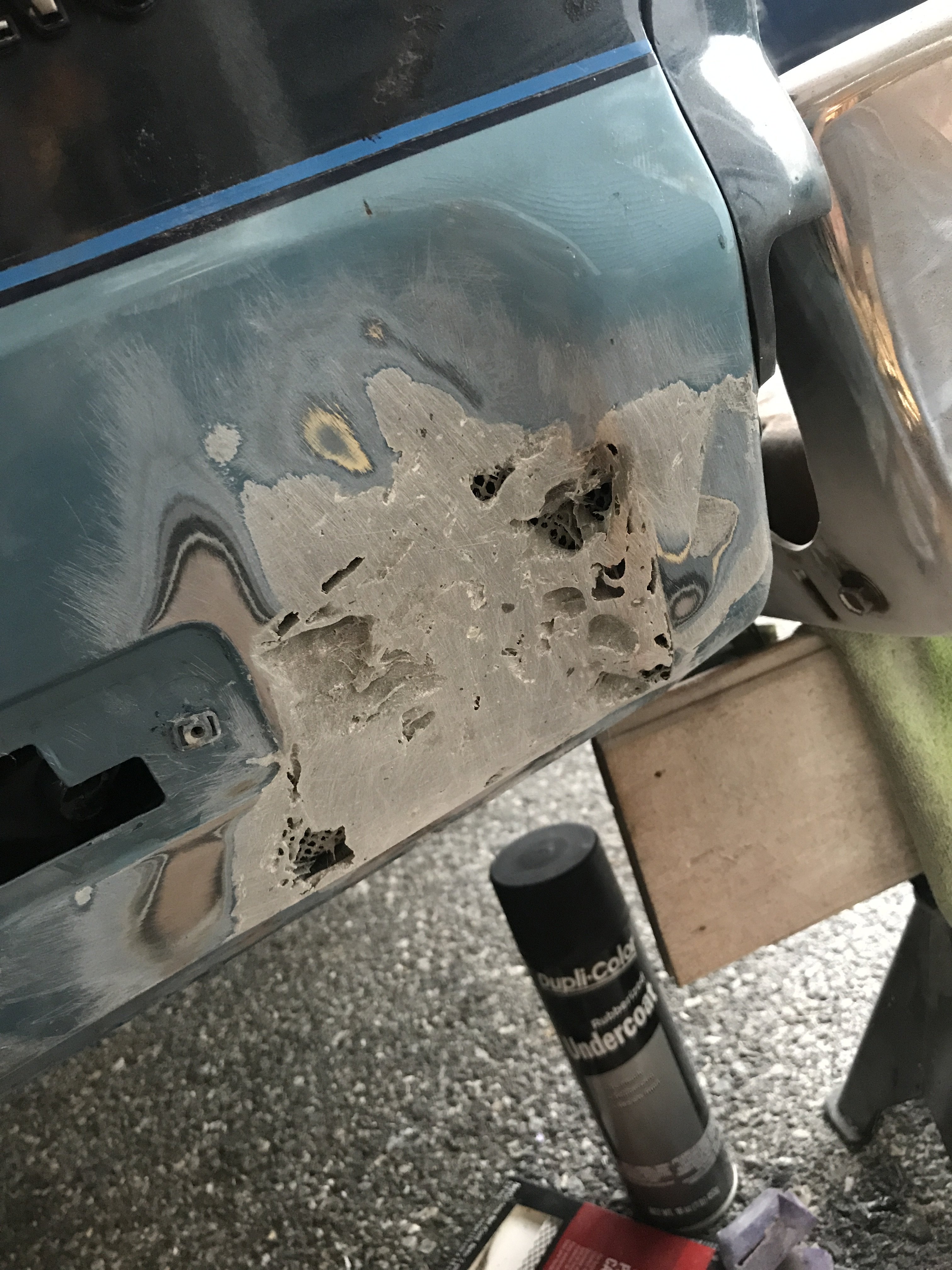

After a few layers of fiberglass and Bondo gold

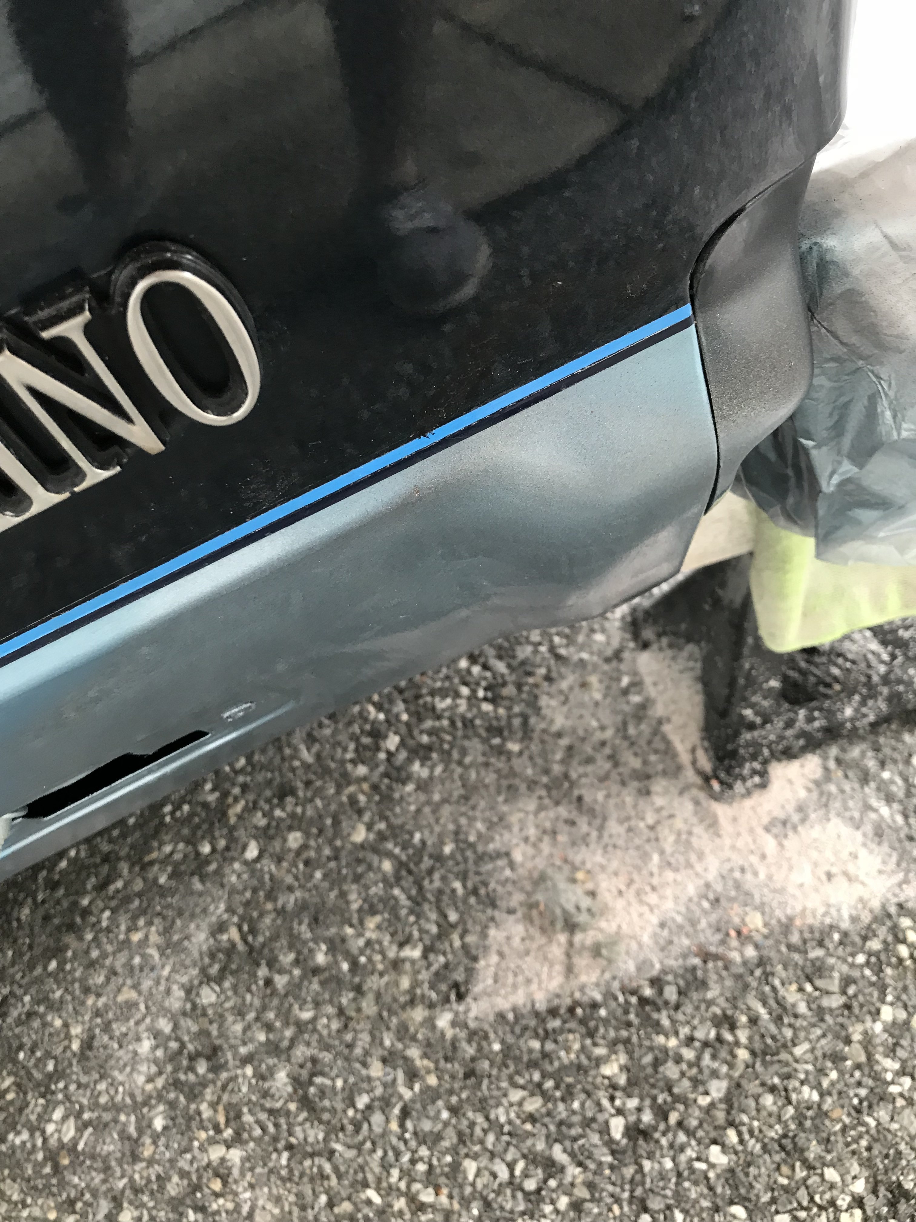

Final product
After a few layers of fiberglass and Bondo goldView attachment 89464

Final product
