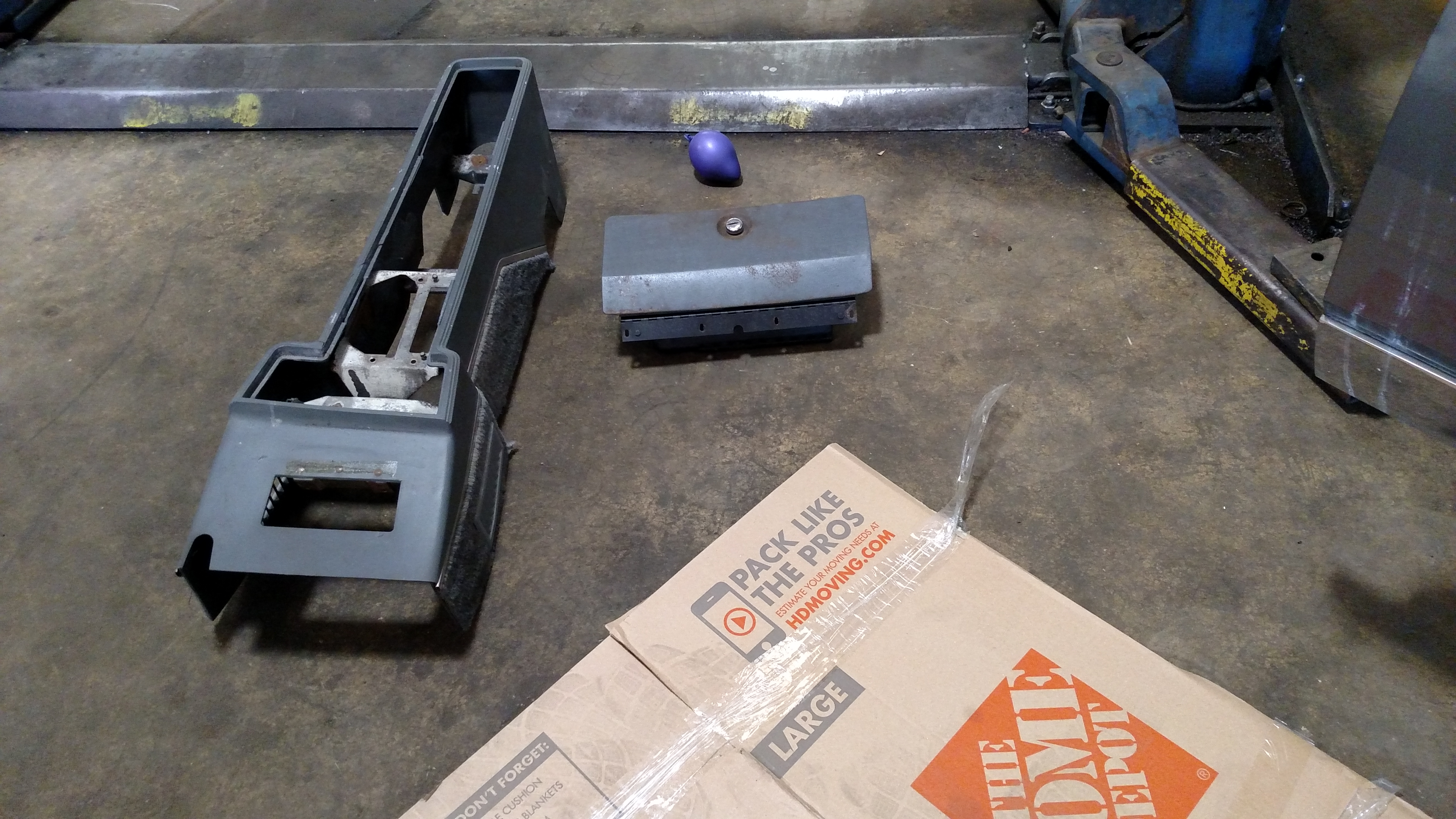

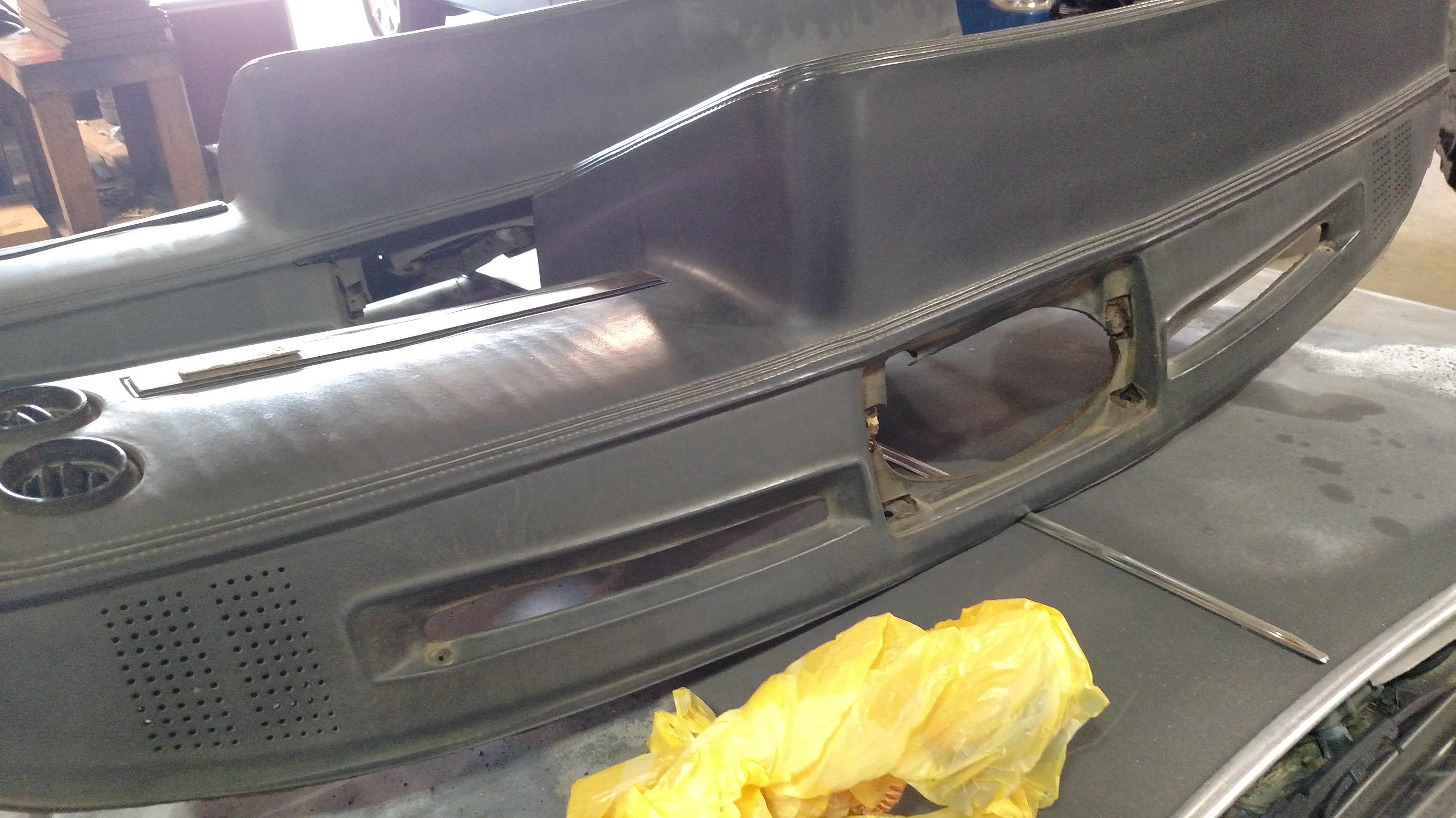

started working on stripping the parts car today, (frame, floors, trunk, quarters, doors and lower a pillers all rotted) pulled all the lights and trim off the rear that was good, gutted the interior other than the busted dash then pulled the front header and bumper off. still have to pull the hood and some things in the engine bay then its going to a guy that wants the roof since its surprisingly in good shape. i did find a build sheet when pulling the door panels that was in great shape.
